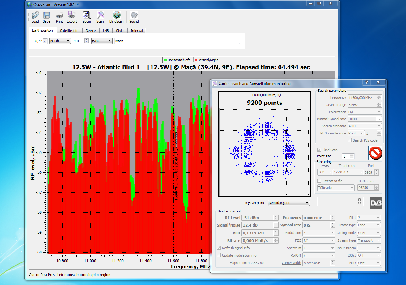

Unzip the attached file into your Tsreader/sourses folder, then tick the invoke analyzer button, select your Tsreader exe file....add "-s TSReader_TCP %ip% %port%" for parameters and it should work. Let us know :)

I have already tried that dll file, makes no difference at all. I get the same error in screenshot 3.
I think its something to do with my card not being able to be used by more than 1 program at a time.

Actually I tried it with TSReader Lite (I was previously using TSReader) and it works. I get a different prompt (after the "command line argument ignored error") for IP/Port and then it streams. So thanks for that!

I don't know about TSreader Pro, I don't have that but I would think it would work fine. Only use one dvb program at a time to access the 6925, otherwise you will have problems.

Yeah, that makes sense. I just couldnt understand how everyone else was able to use Crazyscan and TSReader at the same time but I couldnt!
THanks for that, Ive spent about a day messing around with it!
