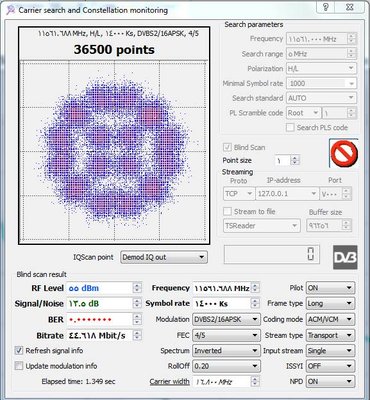

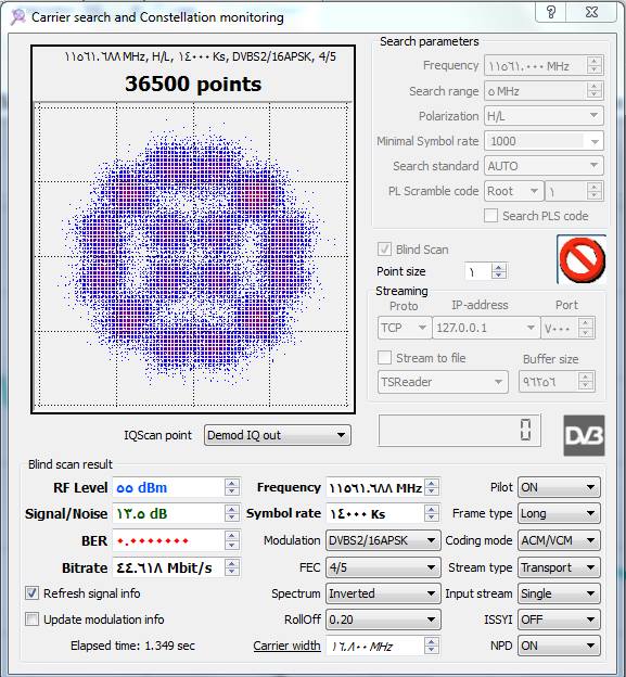

Postby rayman1366 » Sat Jul 26, 2014 10:26 am
Hello
i have a one siganl with
16APSK,
ACM/VCM
FEC 4/5
RF LEVEL -55
SIGNAL/NOISE 14.9dB
rolloff 020
RF Level -55
i have many BER error (Failure).
I checked 32APSK with fec 3/4 and i have 16dB and i dont have any BER errors in crazyscan. (it is 000000).
i want know my siganl in Not enough ? and i should increase it?
as i remeber it was ok in few days ago ...
i use windows 7 64bit . tbs6925 v2.2.

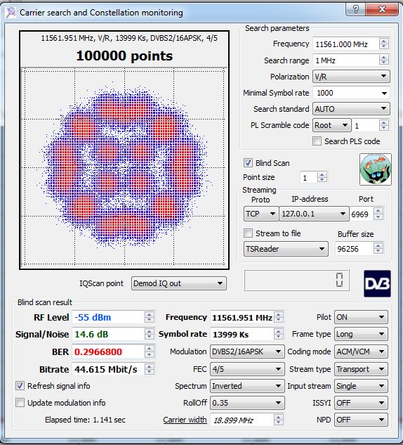

Postby rayman1366 » Mon Jul 28, 2014 1:57 am
maybe 6925 damaged? or need more siganl and 14.6db for fec 4/5 in 16apsk is not enough ?

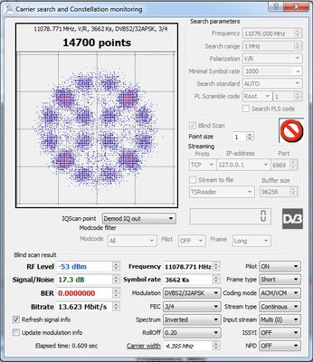

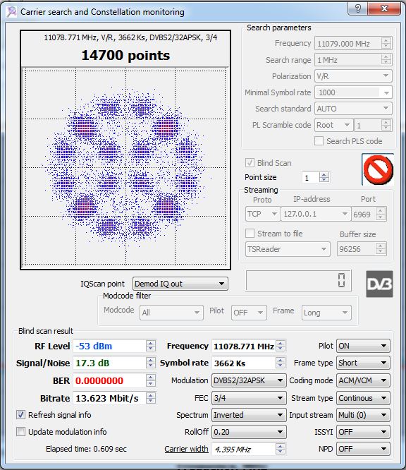

Postby rayman1366 » Tue Jul 29, 2014 12:16 am
Here is photo from my friend 6925. he have lower signal but BER is 00000...
which parameters i should check to fix this problem?

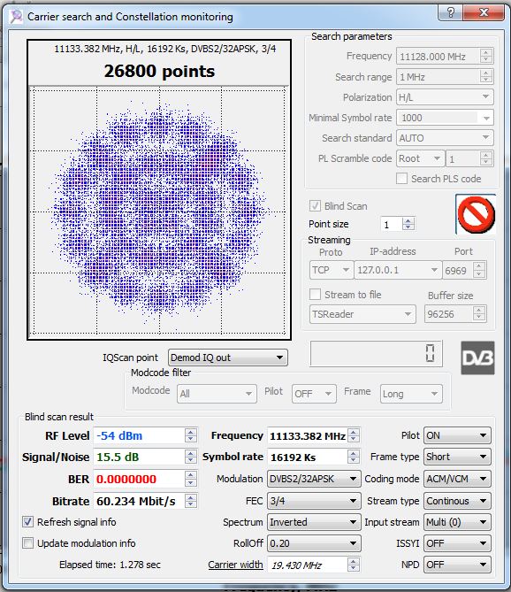

Postby rayman1366 » Tue Jul 29, 2014 2:11 am
here is 2 different freq without any problem.

Postby crazycat » Tue Jul 29, 2014 3:57 am
Check with latest StreamReaderEx-BDA 1.2.0-1202 (same fix in latest drivers for 6925/5925). See disscussion about Eumetcast 10E ussue (DVB-S2 TS FIFO minimum latence mode).
Re: 16APSK reception question
Postby rayman1366 » Tue Jul 29, 2014 8:29 am
crazycat Wrote:Check with latest StreamReaderEx-BDA 1.2.0-1202 (same fix in latest drivers for 6925/5925). See disscussion about Eumetcast 10E ussue (DVB-S2 TS FIFO minimum latence mode).
hi, my friend (koolysat) have 1.0.1.17 driver. also he have lower signal but without errors.
i checked with lastest driver 1.0.1.23 and lastest crazyscan & streamreaderex. but still i have a problem.
rayman1366
Posts: 13
Joined: Sat Jan 21, 2012 4:54 am
Postby crazycat » Tue Jul 29, 2014 9:39 am
so again hardware problem :)
