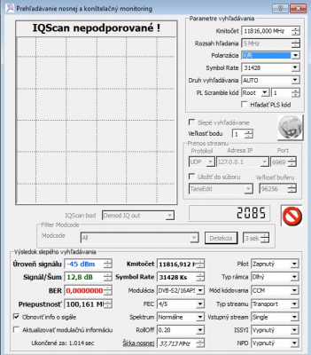

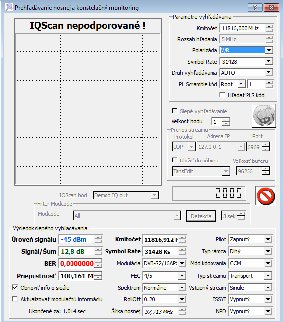

Postby EnoSat » Sat Apr 20, 2024 5:41 pm
What is your signal level in the problematic device? For DVB-S2/16APSK 4/5 it should reach at least 11dB.
Another problem (quite significant) is the maximum bandwidth of the USB bus in the TBS5930.

Postby EnoSat » Sun Apr 21, 2024 3:34 pm
A similar problem with unstable stream in USB device occurred when changing the FEC from 5/6 (111Mbit) to 8/9 (119Mbit)
viewtopic.php?p=55486#p55486
