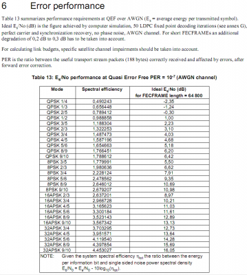

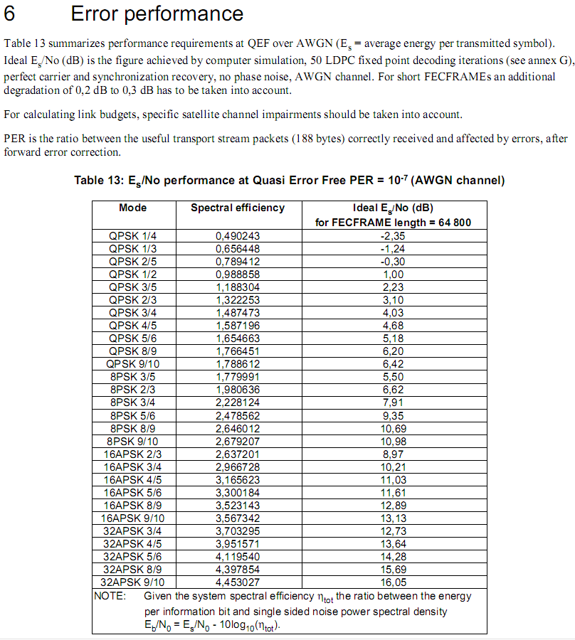

Re: TBS5930 multistream failure can anyone help
Postby crazycat » Mon May 13, 2024 3:47 am
Your multistream with high modulation and FEC + your SNR close to limit.
In Europe present some multistreams with DTT muxes, but modulation usual 8PSK and SR < 45000

Postby digitaldvd » Tue May 14, 2024 3:33 pm
Hi Crazy cat
can you add anything more to the driver software the transponder is running at 8psk and 3/4 symbol rate, when the tbs 5930 is working i can have it running for 2 or 3 hours and also change channel and have pip running at the same time no problem the issue seems to be it resolving the multistream id eg 123 124 125 132 135 136 as quite often it thinks its encrypted,you say its close to the limit if so why does the nova-s2 pctv/292e/461e bda28179 work ok ? i have a signal level off 90% and a quality level off 77%.
i was looking at the tbs 5930 lite but i suspect this would have the same issue sadly for me at this time i dont have linux running as its possible it may work ok.
Again thanks for the response :D
Postby crazycat » Tue May 14, 2024 10:19 pm
Nova-s2 pctv/461e based on old Montage TS2022/M88DS3103 tuner/demod chip. First version M88DS3103 not support multistream, but latest m88ds3103b should support (but maybe driver not support ISI selection and you receive only first substream).
TBS 5930,5530 based on new single-chip tuner/demod m88rs6060 and require some more SNR for stable reception (integrated tuner affected some noise from demod part).
TBS 5931 (5930 lite) use another tuner/demod AV210x/GX1133. Also support multistream, but i not sure about SR limit for 16APSK.
