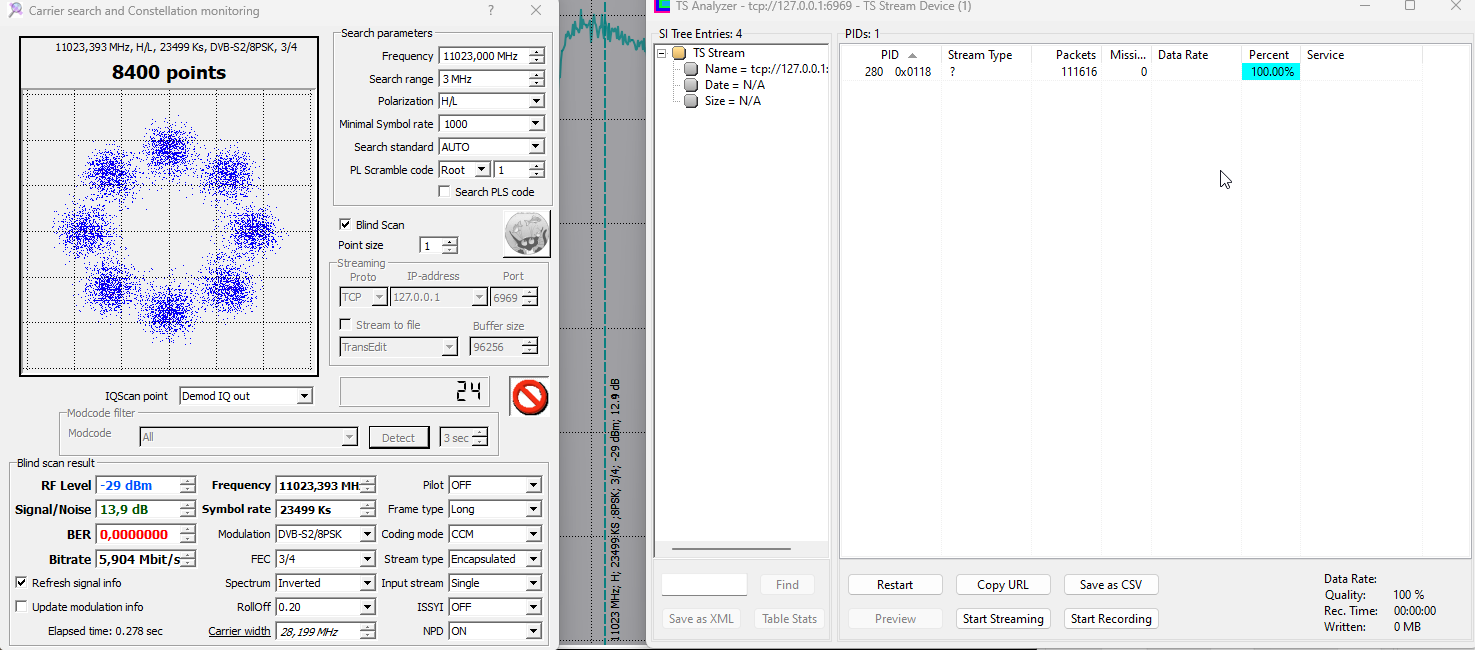

Is it possible to test TBS5930 also on 19E-11023.50 H SR-23500 FEC-3/4 ?
PS (edit 2024) : now on 11141.25 H

Postby DVB » Tue Jan 17, 2023 1:04 am
Yes, results are:
5930 can receive signal, BER unstable, stream type detected as Transport Stream, which doesn't seems to be a correct selection, because random garbages are visible inside as a result - probably forcefully pushed into a TS container by the bridge (?) so stream might be irreversible damaged on this level.
But some content inside is still readable after full TS recording (I saw e.g. some M3U playlist).
For some reason different roll-off detected and different spectrum inversion mode than on yours screenshot.
IMHO It's OK for basic check and understand what's under the hood 8-)

Postby crazycat » Tue Jan 17, 2023 3:45 am
Look like special stream type (Reserved type in S2 standard or Encapsulated type in updated S2X)
Special case with GSE-HEM High Efficiency Mode, only Stid135 can handle it (extract GSE packets and send as reincapsulated in TS with special pid).
