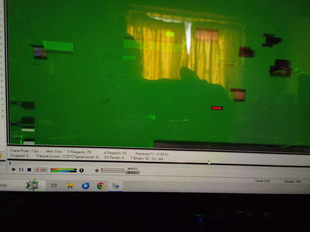

Hi all
because im not an expert i cannot fix this problem i have gone back to windows 10 and thought i had fixed the problem ran dvb dream and worked had it running for about an hour no problem changed channel then pixelating green and grey screen and no picture ???????????? unable to get picture if i run hauppauge usb modem no issues>

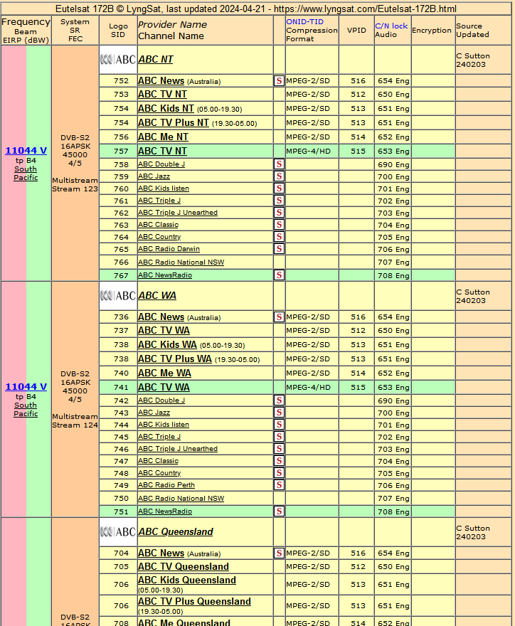

So you lock always first substream from 172E 11044V ?

Was showing high packet loss when picture breaking up and green screen also showed encrypted status

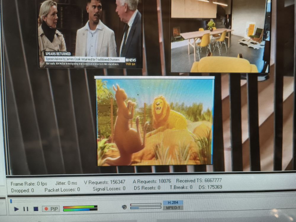

When picture is running ok low packet loss and no encryption status

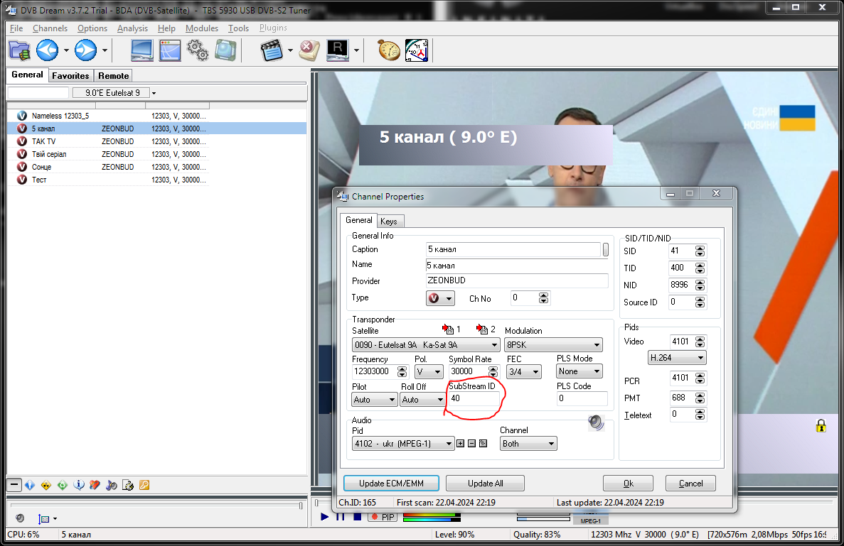

when running under dvb dream under file i did reset directshow sometimes manage to get a good picture but other times no go
also did manage to up load driver but this did not fix this problem thanks for your help crazycat
At this time cant really do anything else to fix this problem maybe some issue reading the stream id.
