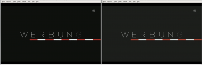

Postby Chris18391344 » Wed Jul 08, 2020 7:52 pm
for the new TBS 2603 SE the BT.709 Informations are Missing. So Black is not Black.
The Color Managment between TBS 2603 and TBS 2603 SE are different. And, we don't see any Color Management in the SE Edition Webinterface.
See the Screenshot.
Left: TBS-2603
Right: TBS-2603 SE

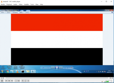

Postby daowei » Thu Jul 23, 2020 6:07 pm
What's kind of source device you're using now? can you have a try change a source for Encoder and test again. I tested in my side, and it's normal.
I'll share you my testing.

Postby Chris18391344 » Mon Oct 05, 2020 3:13 pm
Hi Daowei,
as source we have a customer satellite receiver (opticum).
We can't see this informations (verified with mediainfo) in TBS-2603 SE, but see in TBS 2603 (NOT SE).
