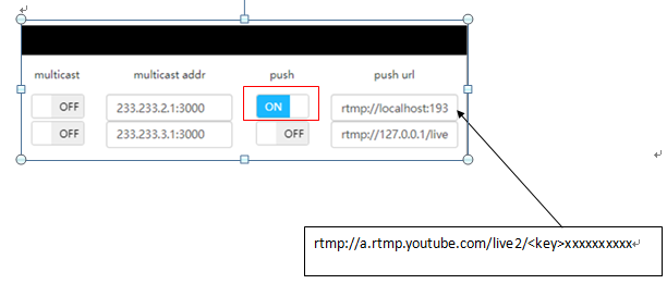

2.For the Youtube, we tested, it's working. Here's an example:
rtmp://a.rtmp.youtube.com/live2/<key xxxxxxxxx_xxxxxxxx_xxxx>
More details, please check this guide:
http://www.tbsiptv.com/download/tbs2605 ... BS2605.pdf
3.For the mix, we have some types, like "grid 3x3, grid 2x2, grid 1+2, and ect." . Sorry can't
" import some templates", source comes from HDMI capture or network stream only.

For Youtube, we did test and it's working.
Please setup a remote check like Teamviewer, we'll check. The firmware is already the latest the version.

I managed to stream to YouTube, thanks.
