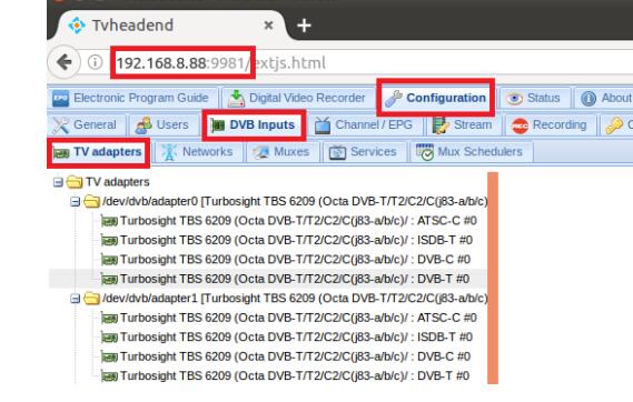

The last you're taking closed driver, but closed driver we didn't add TBS6209 to support. Open source driver no need to set the mode, we added all modes. And in streaming software will list these modes, just choose the mode you need, i show you a picture.
And some streaming sofware add some parameters to set the mode. Like DVBlast:
-5 DVBC_ANNEX_A (DVBC mode).
