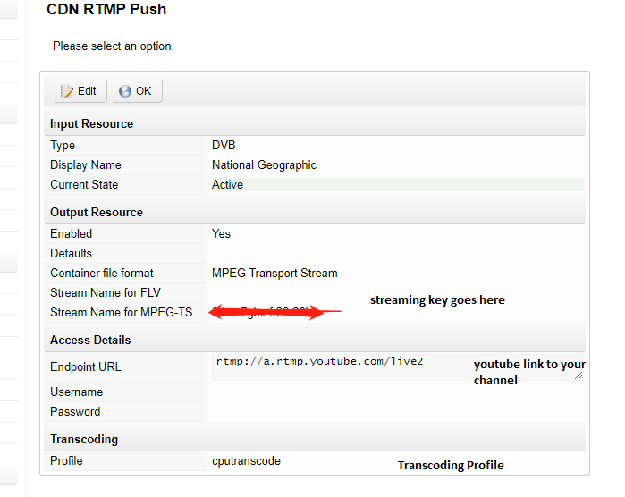

Many people and customers asked about ability of our transcode machines to stream to youtube or twitch.
The answer is yes our TBS 85xx series are able to transcode and stream to youtube on the fly.
In the picture bellow you will see how to setup the rtmp output in your TBS85xx series machines:

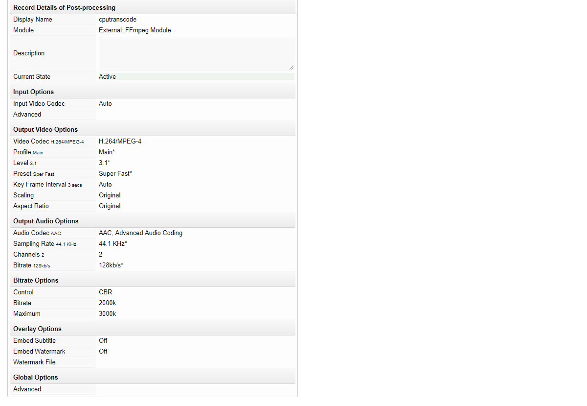

Bellow the transcode profile i used for this test:
Thank you very much and enjoy the feature on your hardware.
