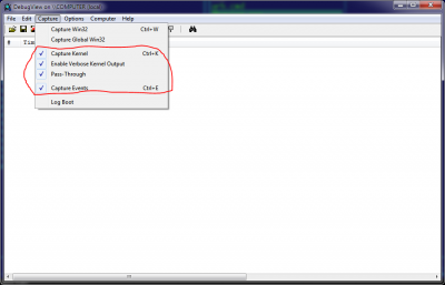

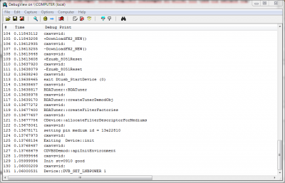

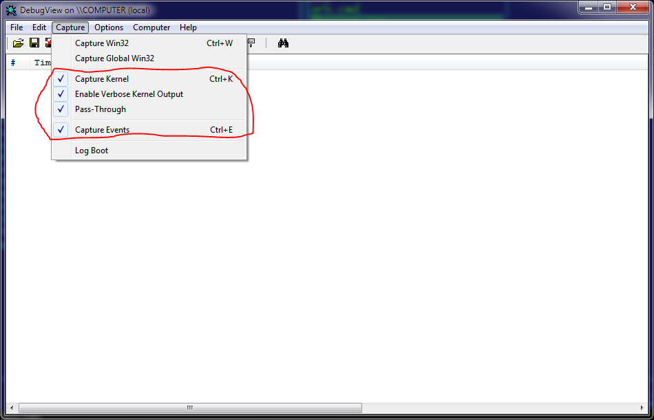

You can try self-signed debug driver and check debug messages with DbgView from driver
1.Unpack archive TBS5927-debug.rar
2. Enable test-mode and add my cert to trusted with testcert.cmd (Run as admin)
3. Run Dbgview and enable kernel logging (see picture)
4. Force update 5927 debug driver from device manager, check DbgView messages on driver init (see my sample log)
TBS5927-debug.rar
