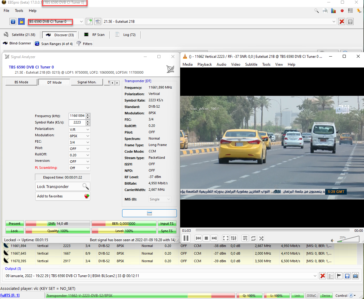

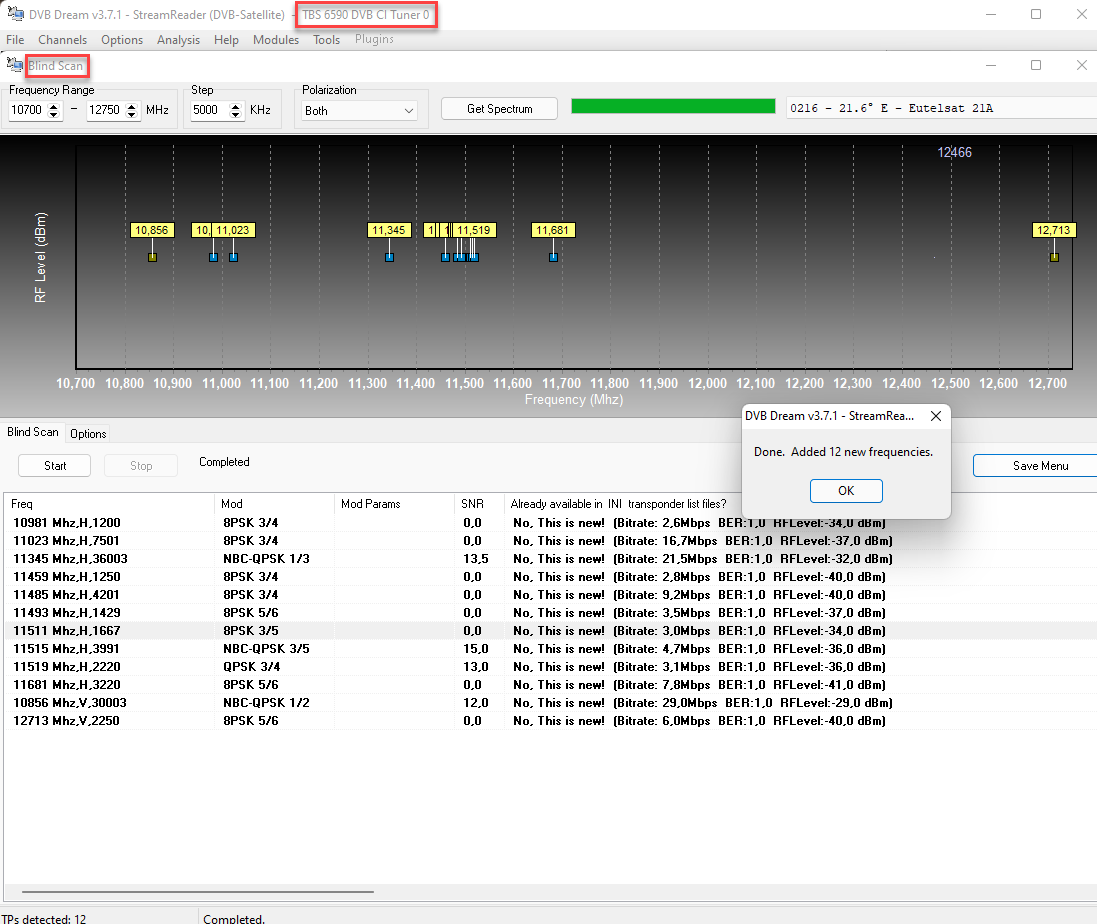

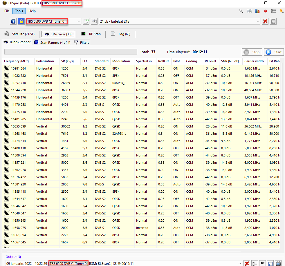

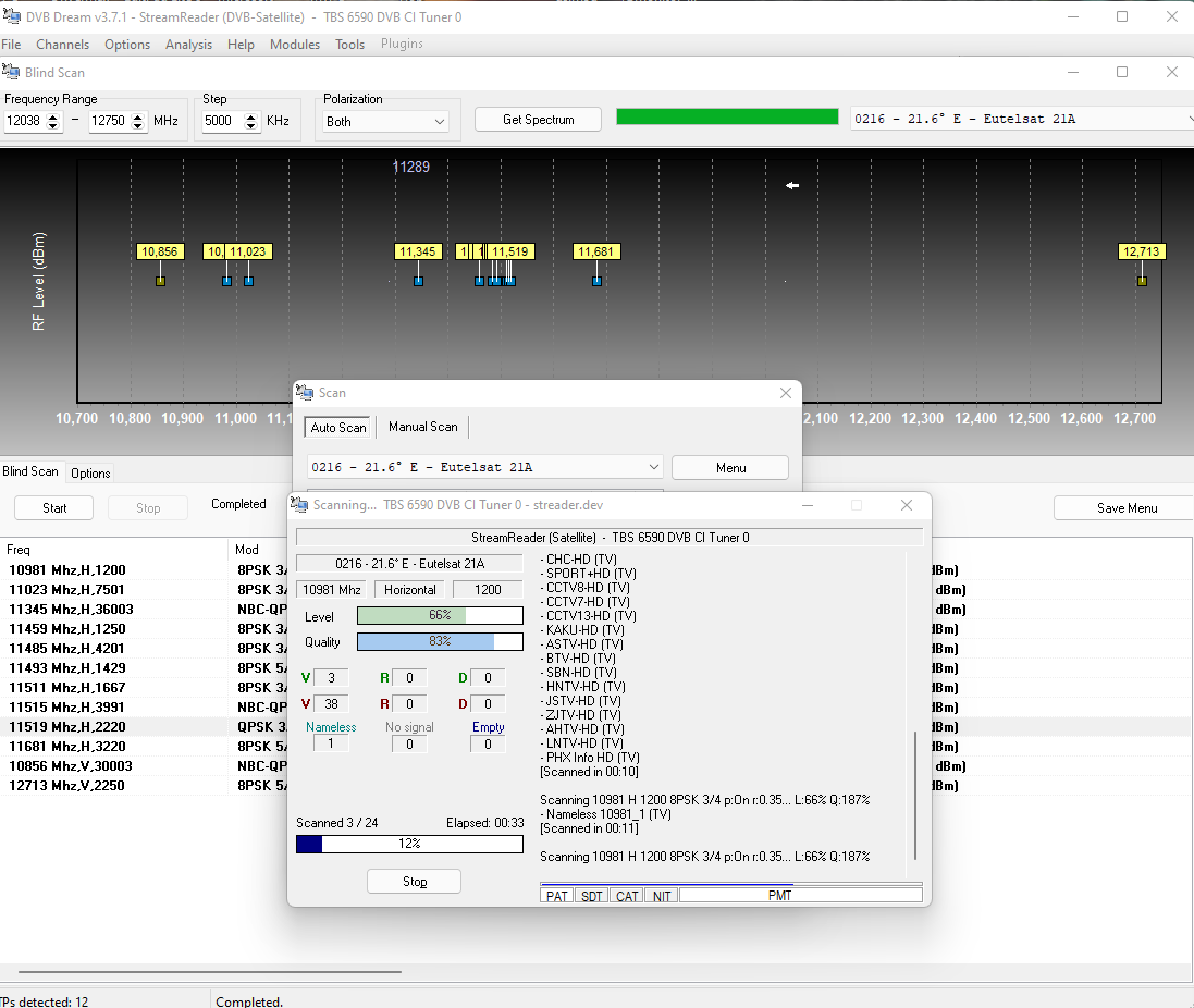

tbs6590 card work well with Crazyscan and EBS applications and I assure you it scans fast. Astra 19.2E in 46 sec on one polarity. Also, with DVB Dream player you can do blindscan with this card.
So there is no problem to work with this card with confidence.

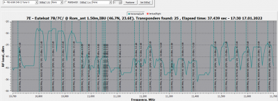

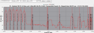

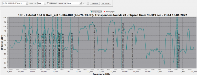

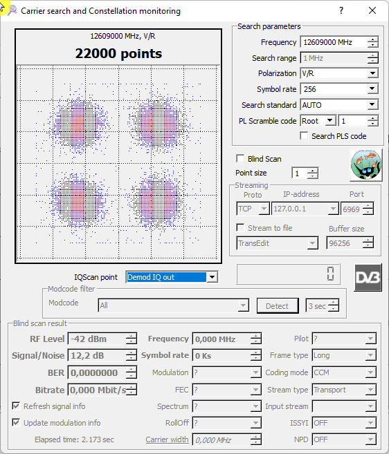

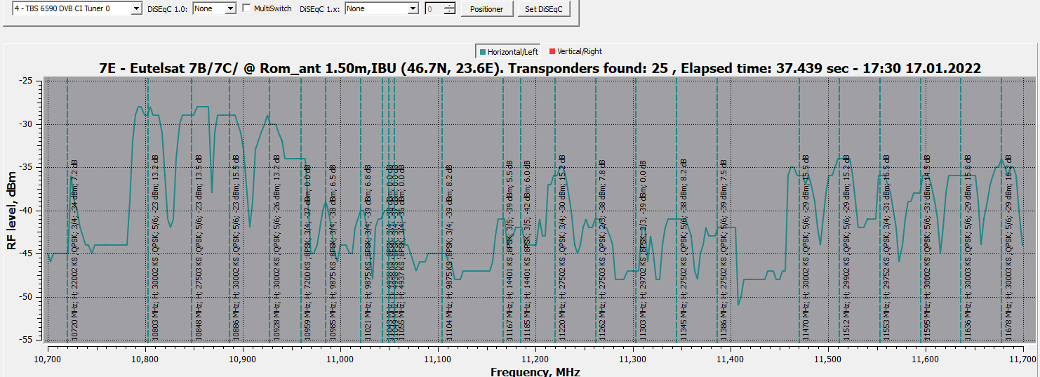

Re: Tbs 6590 blindscan not working
Postby satesco » Tue Jan 18, 2022 1:01 am

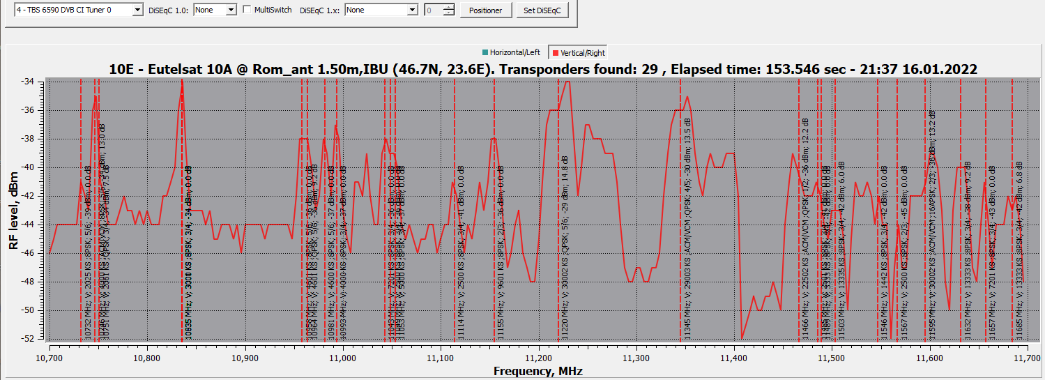

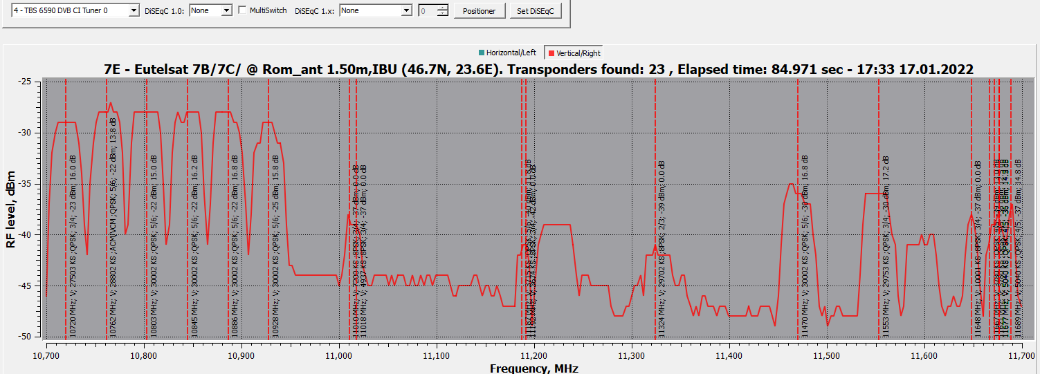

I scanned the two satellites you requested. The result is the one in the screenshots below.
Although CrazyScan provides full support for demod Si2183 based satellite devices (tbs6590.6522, etc.), generic/continuous streams are not lock it. Therefore, some 7.0E and 10.0E transponders do not appear on the spectrum.
On the other hand, it should be noted that the card specification mentions that the symbol rate is between 1-45Msps. So, they cannot receive below this value, although the tuner sees the signal, as you can see at 10.0E on 12609 V,256,1/2.
Because there are many high frequencies that have generic streams and low symbol rate (especially at 10.0E), RF scanning at both satellites is slow. So it's no surprise, it takes longer.
You also have to consider the scanning steps. For example, at 3.0 MHz steps the scanning time between 12500-12750 MHz at 10.0E is 2 min, while at 4 MHz it is 1.6 min.

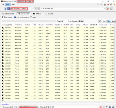

Hi satesco, thanks
"Because there are many high frequencies that have generic streams and low symbol rate ...". What do you mean by "generic streams"?
Could you try Ebs Pro too? RF scan in high frequencies is really slow..

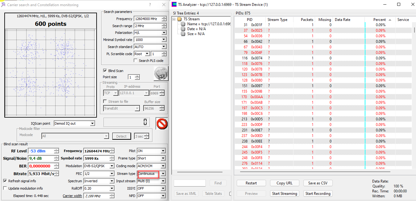

Here's what the generic/continuous stream looks like.
Useless to use EBS, because it depends on the demodulator to lock low symbol rate or generic streams, and less on the app.
