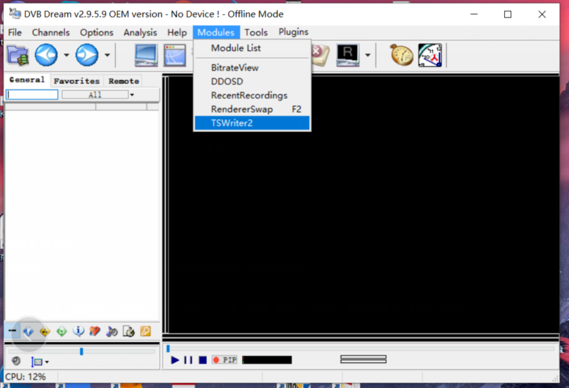

Postby steven » Tue Jan 19, 2021 9:30 am
Hi Sir
You can use DVBDream TSWrite plugin it will save all TS stream
please watch the problem transponder and do not put CAM insert and record .
Re: TBS6590 driver/ntdll crash
Postby fatal » Tue Jan 19, 2021 5:19 pm
steven Wrote:Hi Sir
Hi steven,
Thanks, I will check that later. Today I won't have time, but tomorrow I will.
Do I understand correctly that for this recording, I should disable the CI in DVBDream and/or phisically remove the CAM from the card?
Is it okay if I will upload the result to Google Drive? I think it will be too large to attach here (I guess there is a file size limit in the forum engine).
