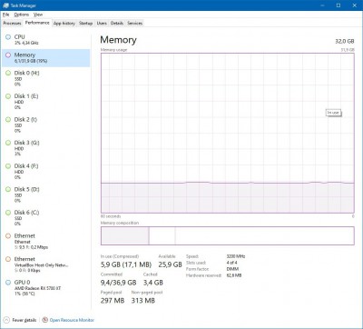

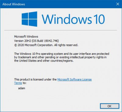

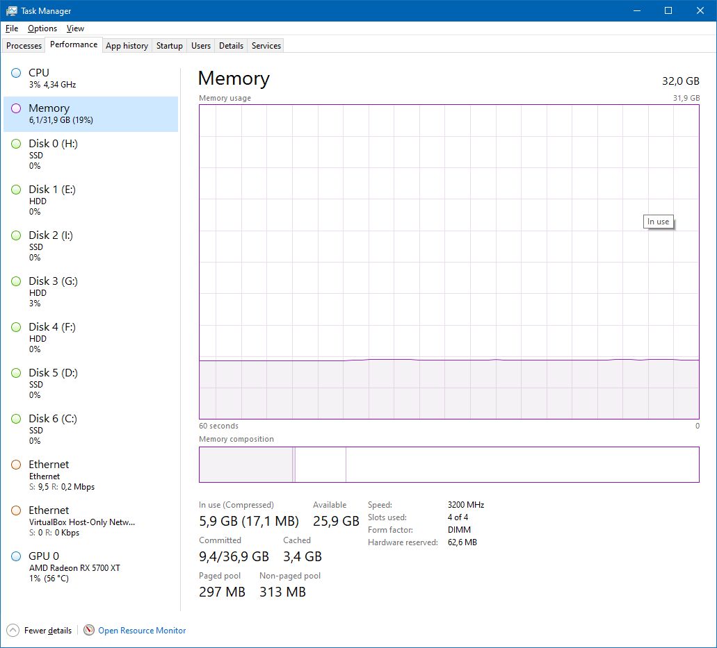

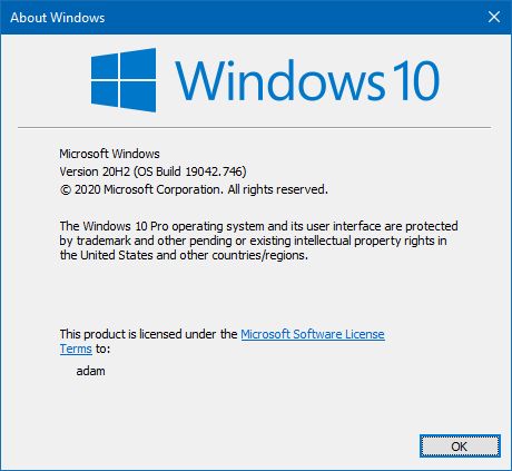

Hi sir,
That information in DvbDream's log is wrong. As I wrote earlier, I'm using Windows 10 20H2 and I have 32 gigs of ram.
Probably DVBDream version is old and thinks all windows 6.x is Vista and since it's 32-bit application max memory is 2GB (for its process).
Hardware is Asus Prime Z370-A, i7 8700k, 32GB RAM and a Radeon RX5700XT. Also as I said earlier, on Linux it's fine, so it's a software issue on Windows.
