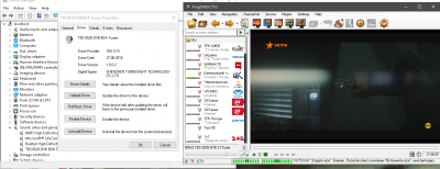

I don't know if the driver reports reliable signal data. I made a video recording in which you can see that signal level and quality is more or less the same on all transponders.

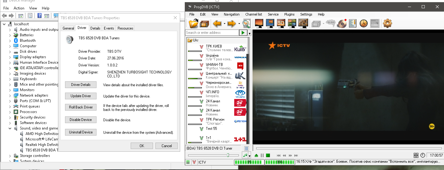

I just installed the old drivers, you provided me last year, and the signal levels are much higher now. So the drivers are lying about signal level and quality.

Currently I'm using the old version (1.0.0.2) you compiled for my old rig with Phenom II 955.
It is attached to this post: viewtopic.php?f=196&t=24740#p52955
Please, note: that 1.0.0.2 version is not the one that was downloadable from TBS site. You connected to my PC via TeamViewer, did some experiment and after that you provided me with 1.0.0.2 version attached to the post above. It is the only version I used on my Phenom II 955 rig - the others weren't able to lock/scan the DVB-C transponder. And I'm not aware what changes did you do in this specific drivers build for me.
Yesterday for about 6 hours of usage I didn't observe any issues with that (1.0.0.2) driver on my new Ryzen 7 1800X rig.
Will do more testing today.
The driver which wasn't stable is the newest one available on TBS site: v 1.0.1.2 (you can see it at about 05:40 on the video above)

Now I can confirm - no observable issues on that old 1.0.0.2 driver - no frame corruption, no video-audio sync issues, no card resets.
