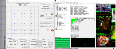

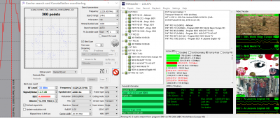

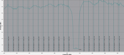

Postby satesco » Thu May 04, 2017 7:01 pm
1.Download Crazyscan for sat and Crazyscan2 for cab & ter,StreamReaderExEx-BDA,ReqLibs.rar from here,the last two placed in the CS for sat and CS2 folders.
2.Download TSReaderSource from here and than placed it in the sources folder and tsreader will capture and and analyse a cable,ter,sat signal.
3. After you have scanned the cable frequencies then invoke TSReader from Crazyscan for sat and Crazyscan2 using TCP streaming.
