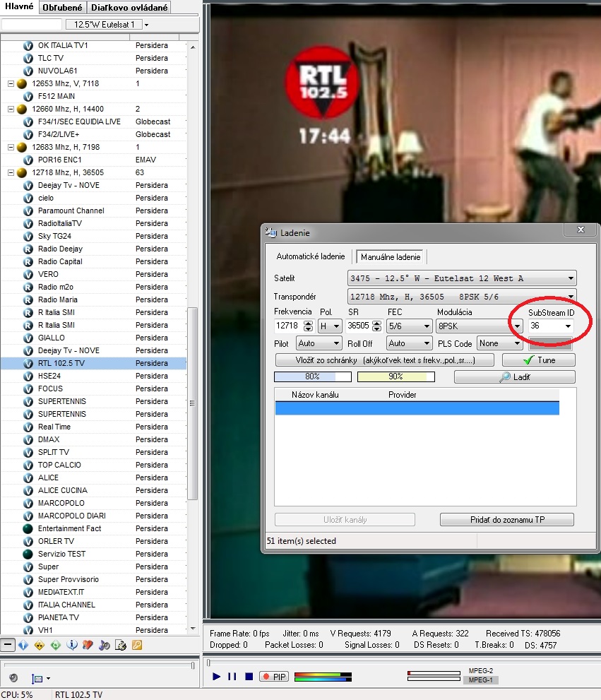

Because there are multiple requests about the Multistream reception, Peon was so kind to provide a quick guide how to receive Multistreams with TBS 6522. Well, this can be apllied to any TBS card that supports this feature.....
We personally prefer to use DVB Dream (paid version) or Smart DVB (free version) as a player.
1) First select "CrazyCat BlindScan Device 1.0.2.8" in DEVICEs
2) Just add whatever number is required to "SubStreamID" before scanning the frequency
3) Scan and save all channels found
SubStreanID can be found on lyngsat.com or flysat.com.
If there is a need to add PLS + Root, just enable PLS and add required numbers.
Those numbers can be found on dedicated web sites such as lyngsat, flysat or satellitescommunity.de provided by their members Otherwise use CrazyScan to do the job even it may take some time as the code may be between 1 - 255000. TBS 6522 CAN DO THAT! PLS search under Win XP is faster...Win 7 is slower. Neither of us use Win 8, 8.1 or 10.
You can also check Rai Piemonte: http://www.lyngsat.com/Eutelsat-5-West-A.html -> 11675 H where PLS code is GOLD 131070 and Stream 7 to try this combination as it`s always good to start at some point and see how things work.
