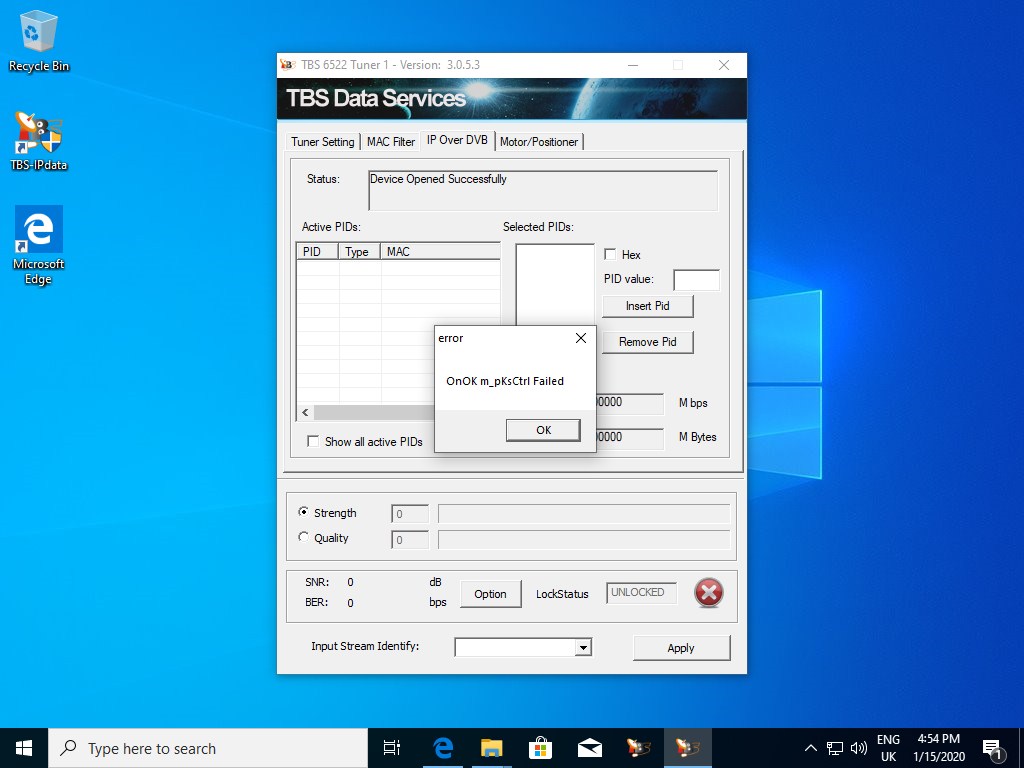

Hi. Don't be tired. I have a 6522 card. Other drivers and software are working properly but when I log into tbs iptool software I get this error and can't use the capabilities of this software. Error: onok m_pksCtrl failed. Please help me thanks a lot.

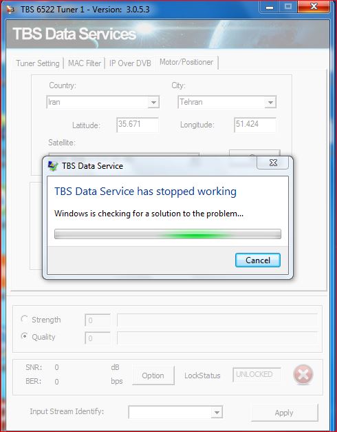

Postby Farjam » Wed Jan 15, 2020 6:31 pm
Notice also this picture. I installed the card on another computer but this time it did not error appear when logging into the software. I installed the card in Windows 7 Is it possible to fix the problem with installing in Windows 10?How long the update will take. Thanks

Postby Farjam » Wed Jan 15, 2020 9:53 pm
This is also the case in Windows 10. In Windows 10, I also get a control package error as soon as tbs ipdata runs
Win 10 pro 64bit
