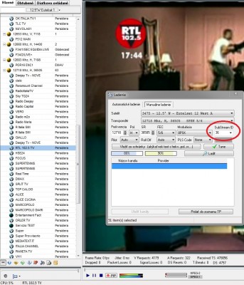

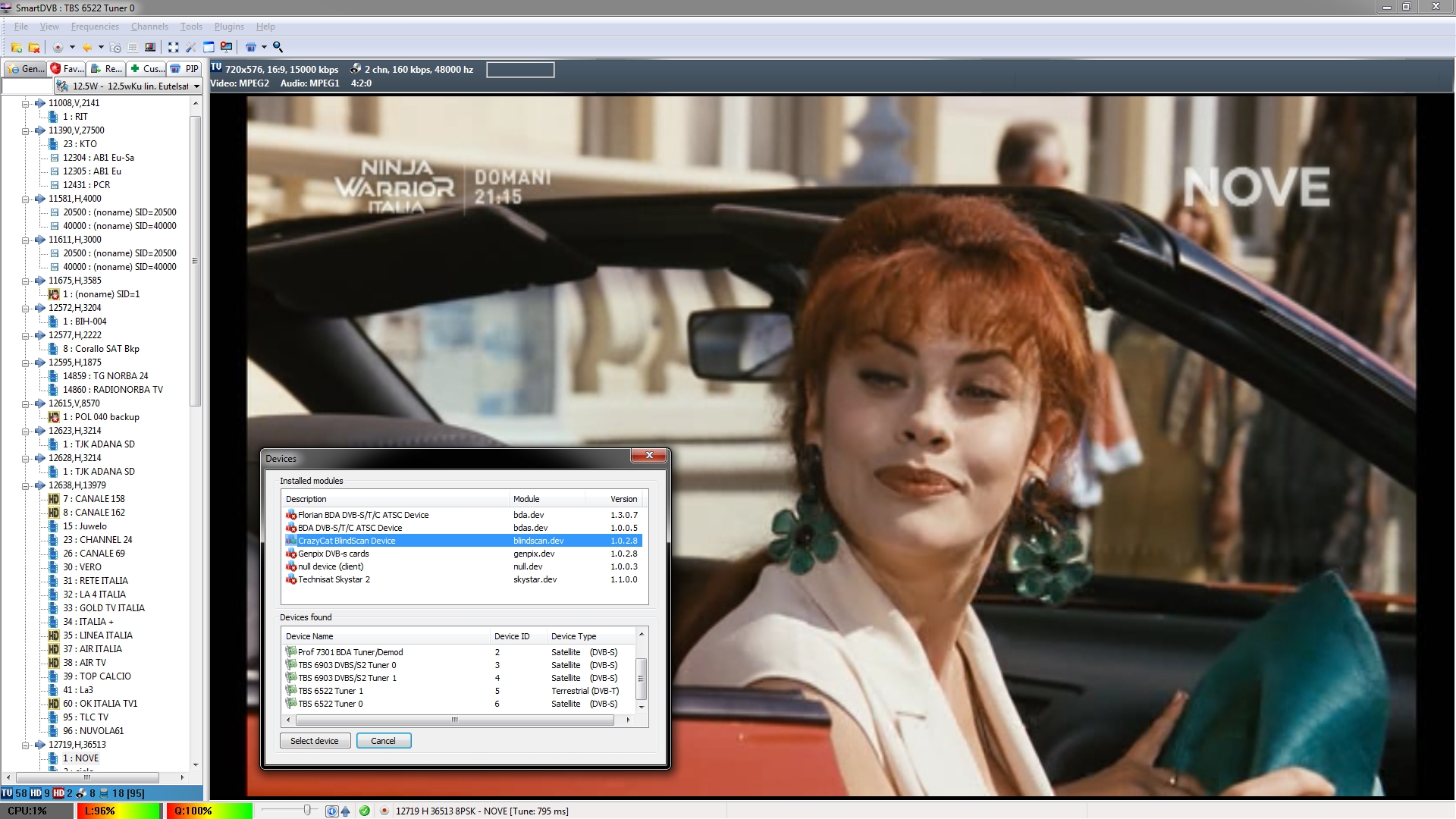

Postby sato » Sun Nov 06, 2016 7:44 pm

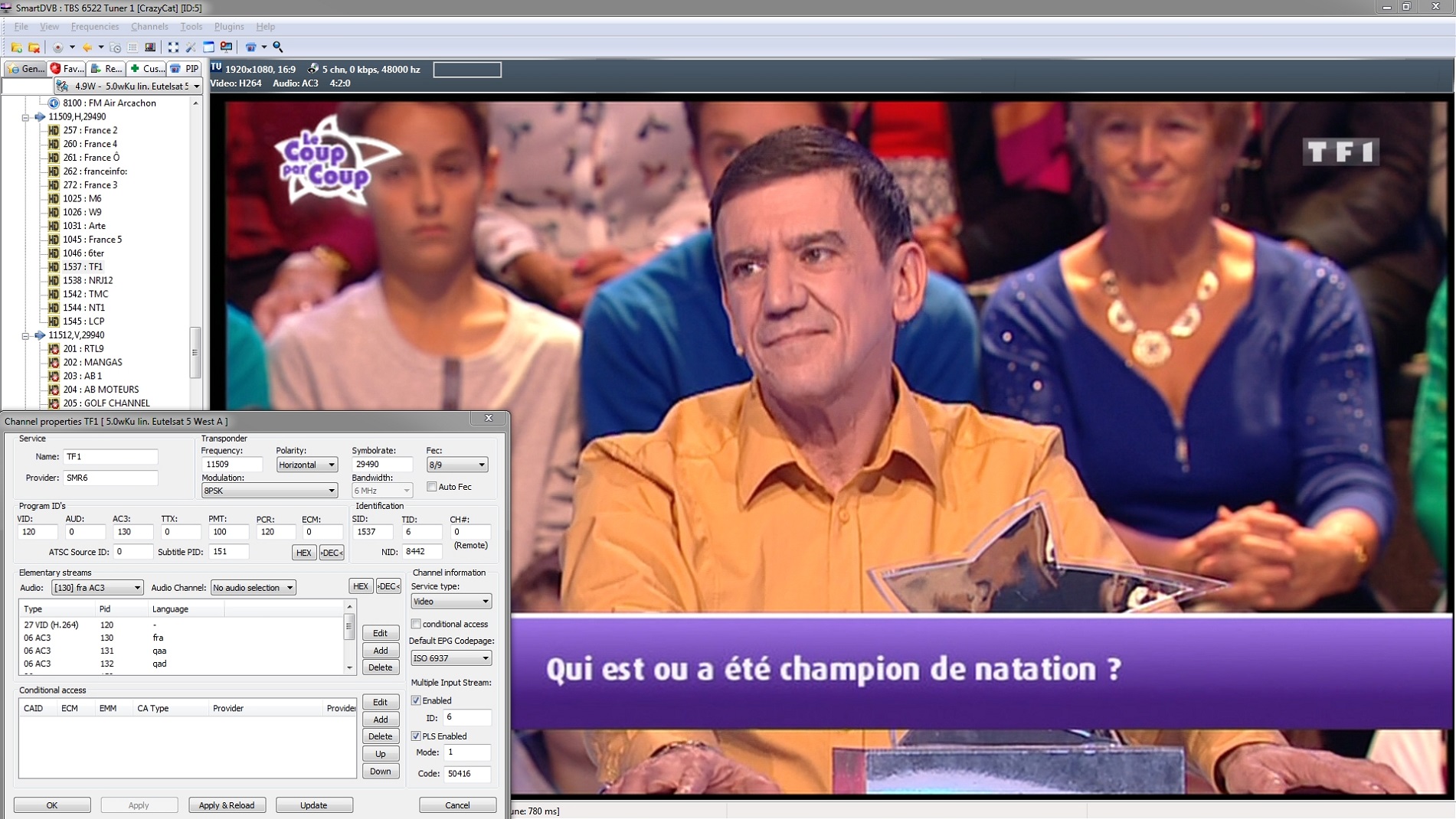

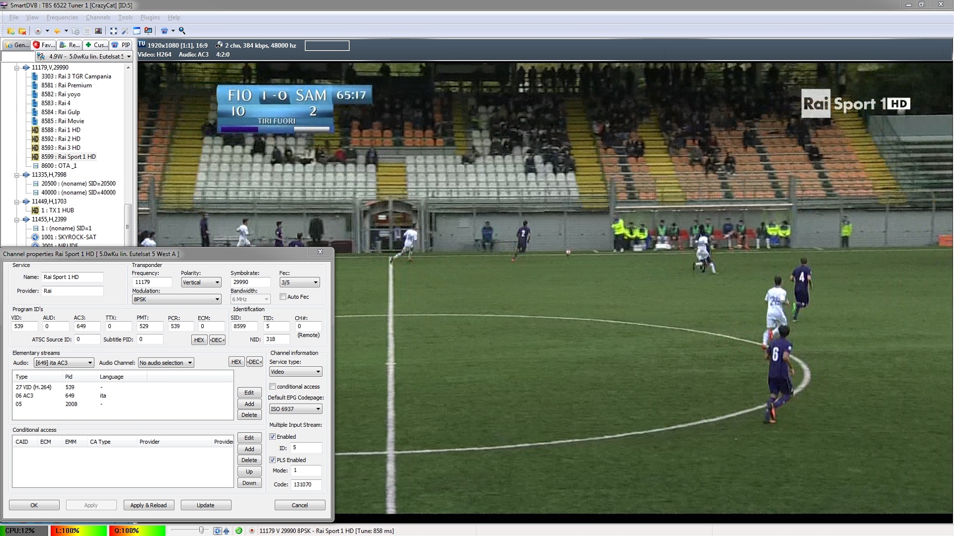

Because there are multiple requests about the Multistream reception, Peon was so kind to provide a quick guide how to receive Multistreams with TBS 6522. Well, this can be apllied to any TBS card that supports this feature.....
We personally prefer to use DVB Dream (paid version) or Smart DVB (free version) as a player.
1) First select "CrazyCat BlindScan Device 1.0.2.8" in DEVICEs
2) Just add whatever number is required to "SubStreamID" before scanning the frequency
3) Scan and save all channels found
SubStreanID can be found on lyngsat.com or flysat.com.

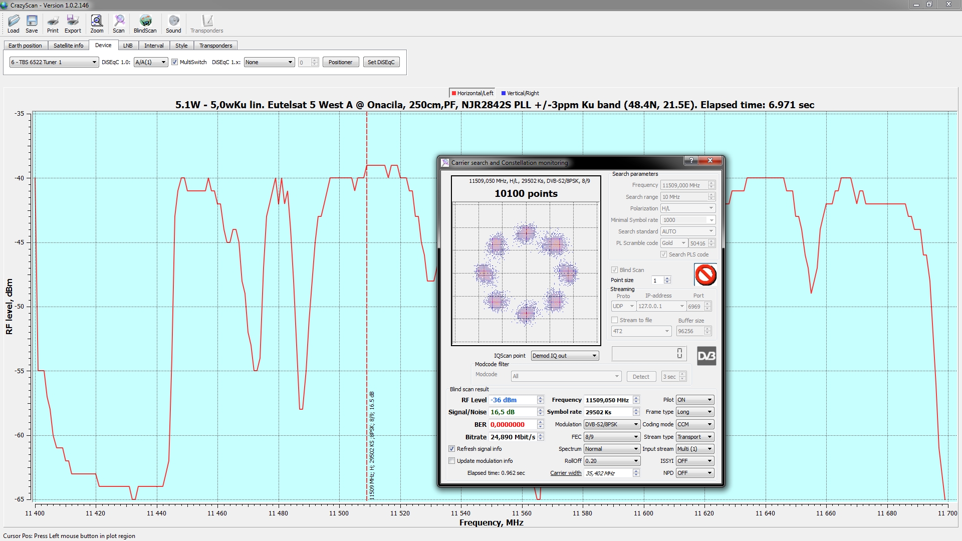

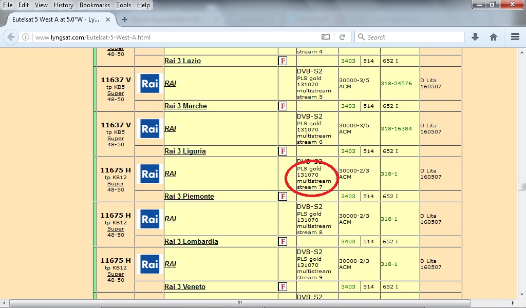

If there is a need to add PLS + Root, just enable PLS and add required numbers.
Those numbers can be found on dedicated web sites such as lyngsat, flysat or satellitescommunity.de provided by their members Otherwise use CrazyScan to do the job even it may take some time as the code may be between 1 - 255000. TBS 6522 CAN DO THAT! PLS search under Win XP is faster...Win 7 is slower. Neither of us use Win 8, 8.1 or 10.

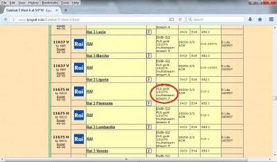

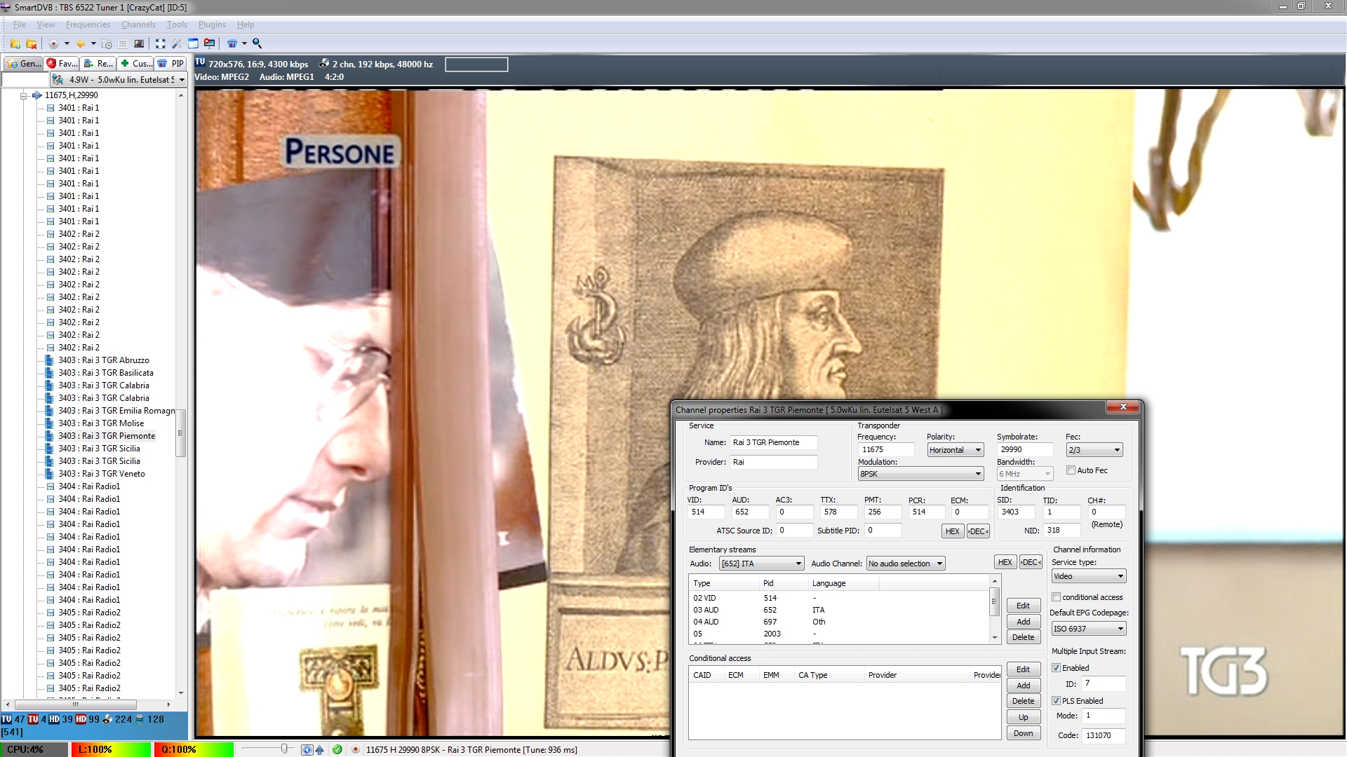

You can also check Rai Piemonte: http://www.lyngsat.com/Eutelsat-5-West-A.html -> 11675 H where PLS code is GOLD 131070 and Stream 7 to try this combination as it`s always good to start at some point and see how things work.
Multistreams + PLS code info - Lyngsat.com
Rai Sport 1 HD @ 5W
TF 1 @ 5W

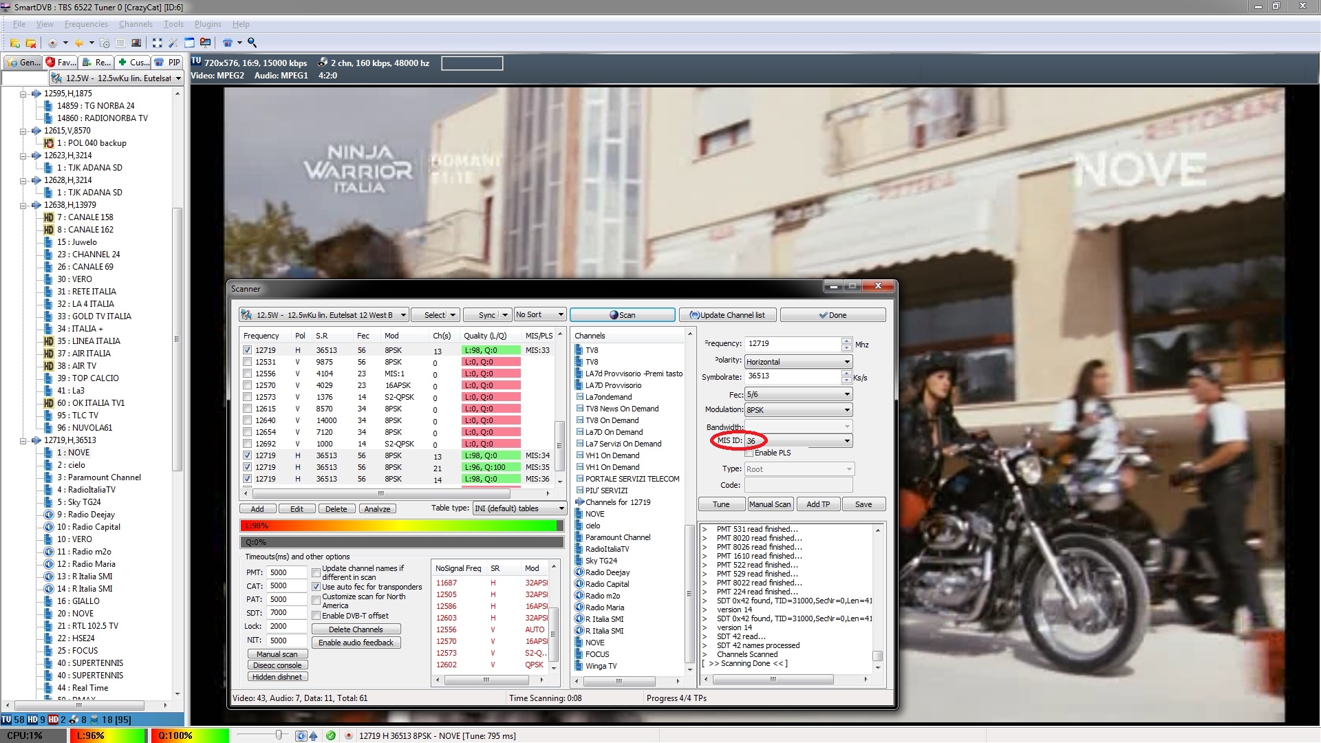

TBS 6522 - PLS searching

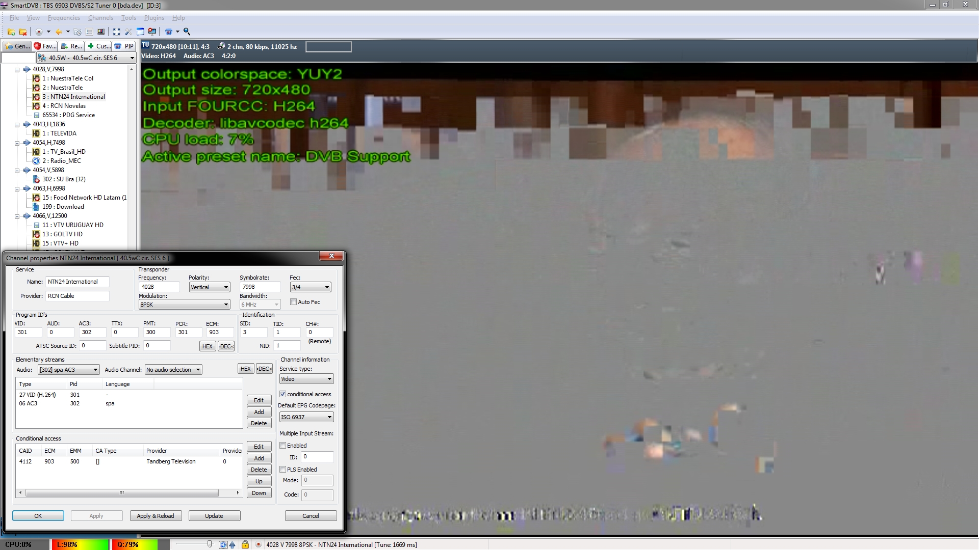

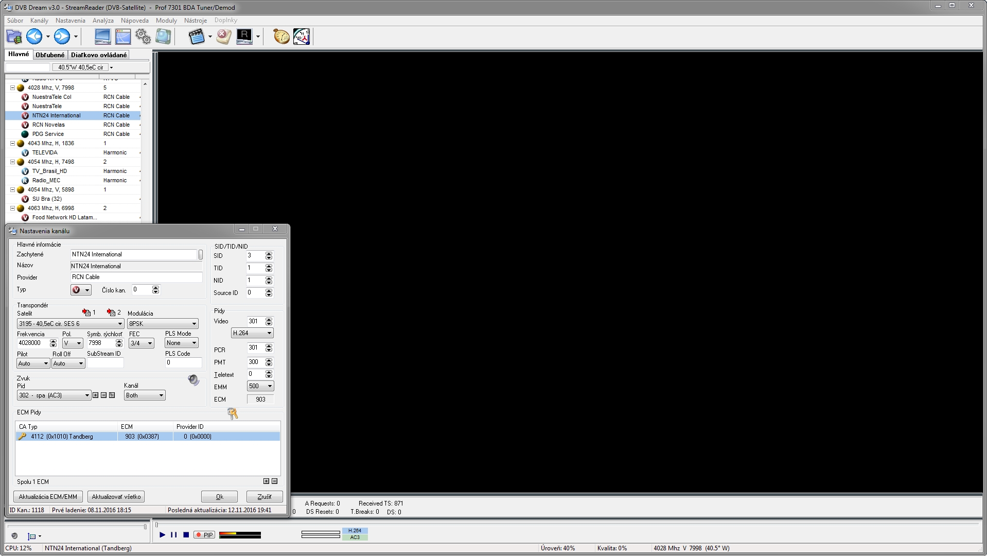

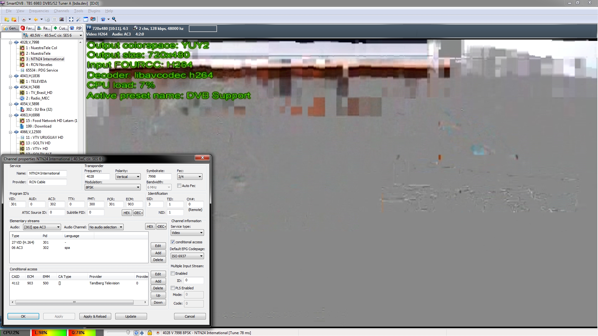

Along with a few other satellite projects that are currently in progress, we still keep testing all TBS cards as we go along.
One may say, it`s not a big deal to do such tests. Well, good and relevant tests take lots of time, patiente and effort. But as you can see, it pays off!

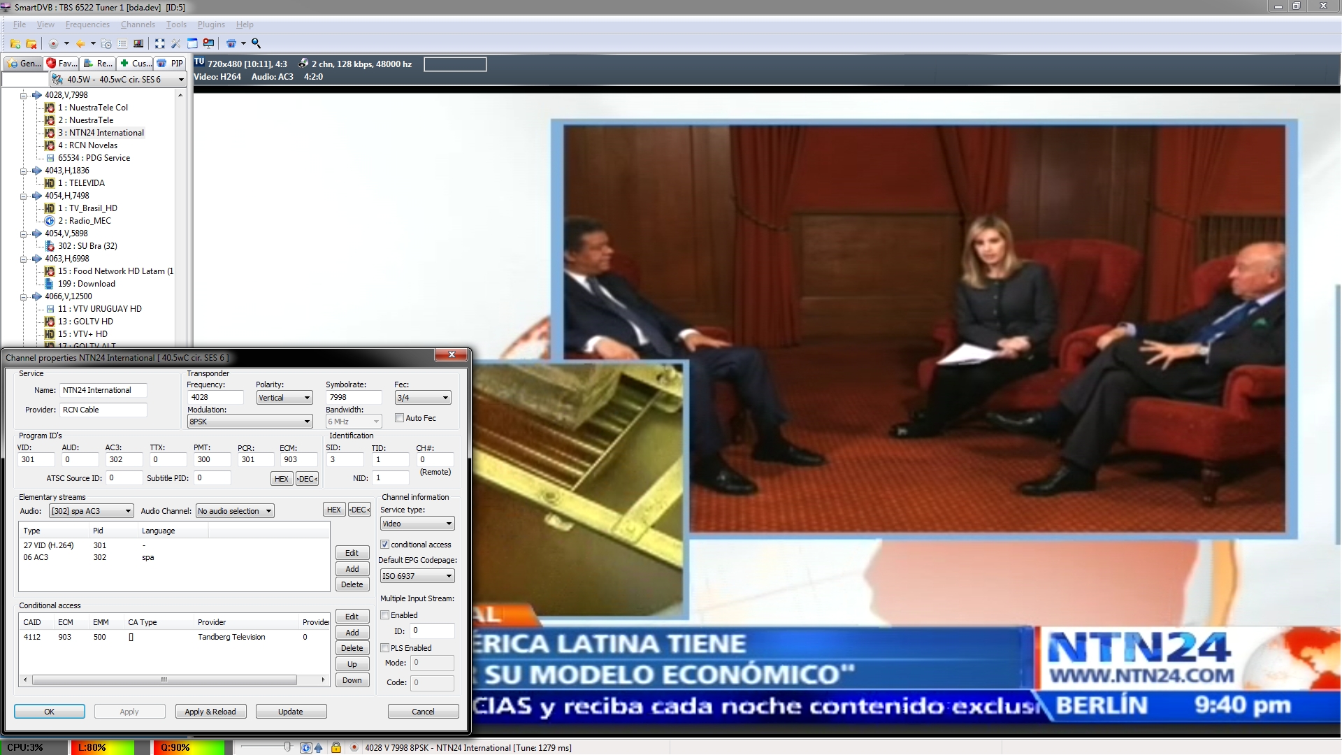

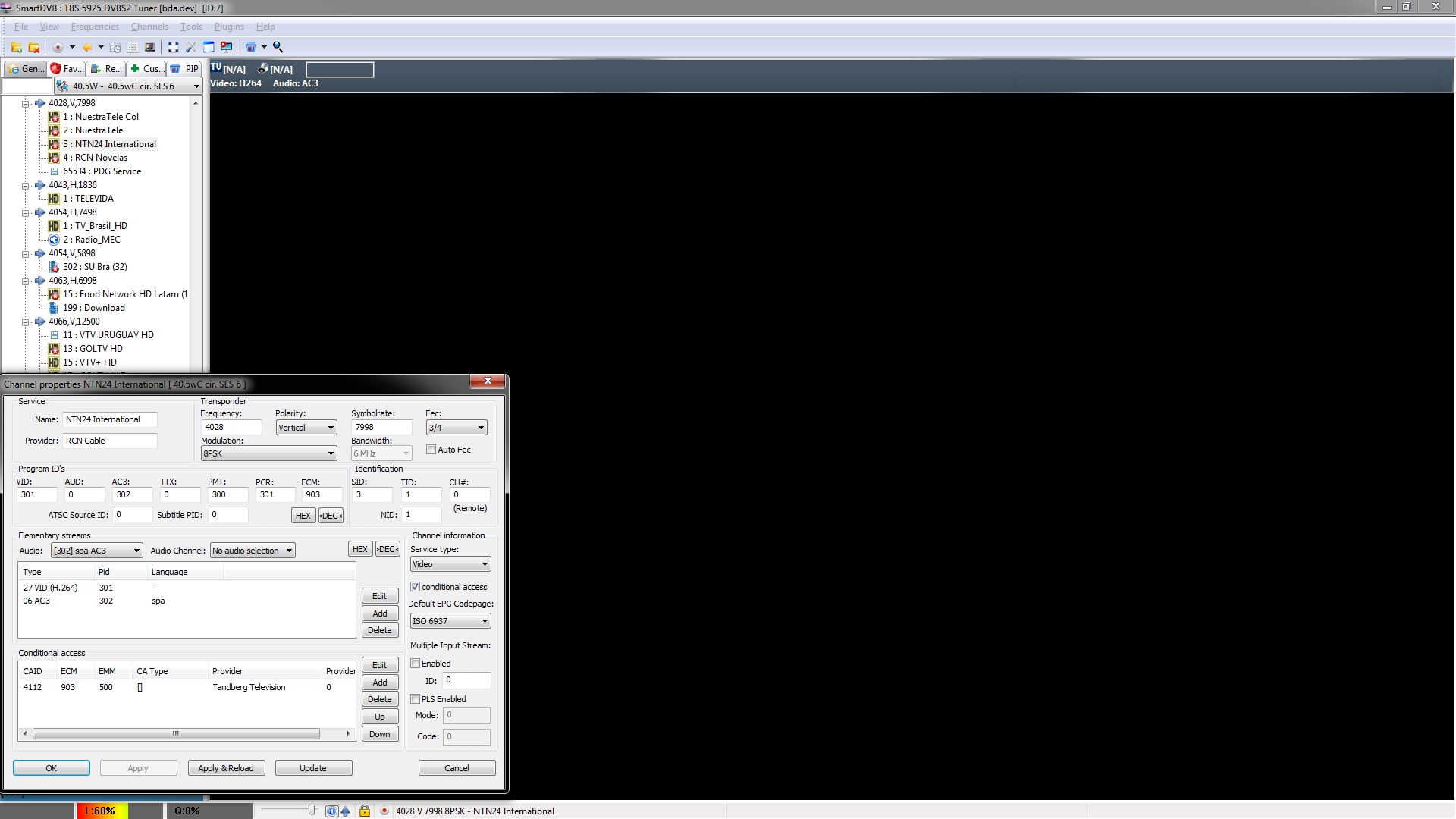

TBS 6522 - sensitivity tests.
If TBS 6983/6903 are great, TBS 6522 sets a new limit!
Those tests have been done several times, the player was completely closed down and open when a device was switched. DVB Dream was used for Prof 7301 because the latest version of Smart DVB causes Prof to crash. But on the end of the day it doesn`t change anything on the fact that there`s only one card that could fully and freeze free provide picture and sound on this station/transponder.
Pictures say it all.
NTN24 - TBS 6522
NTN24 - TBS 5925
