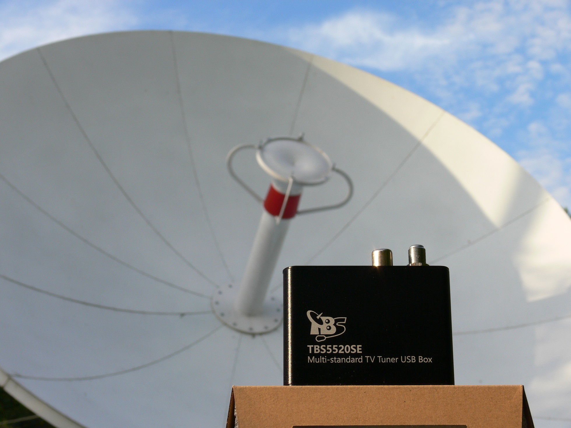

TBS 5520SE and Peon`s NWIEE 3.7m antenna

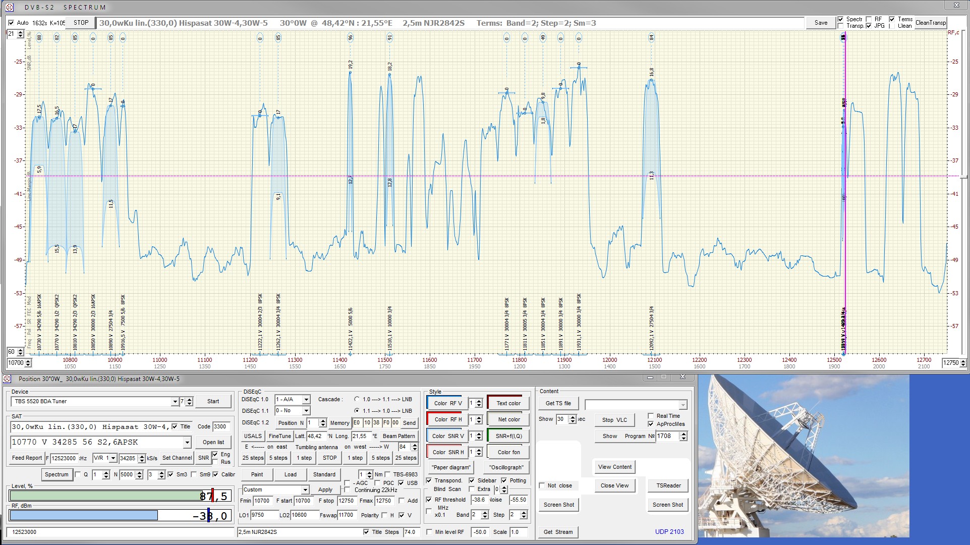

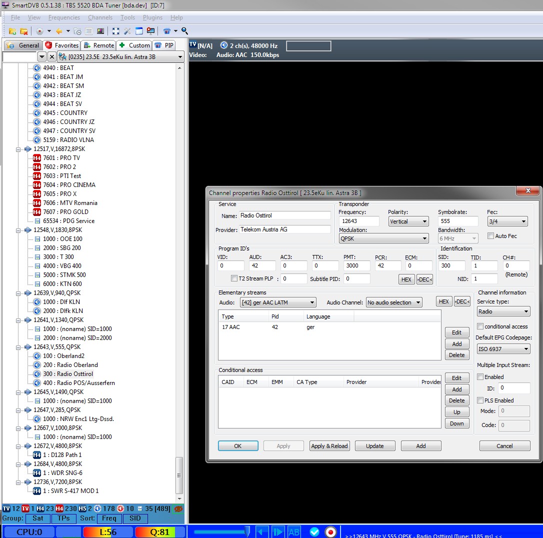

The lowest SR 555

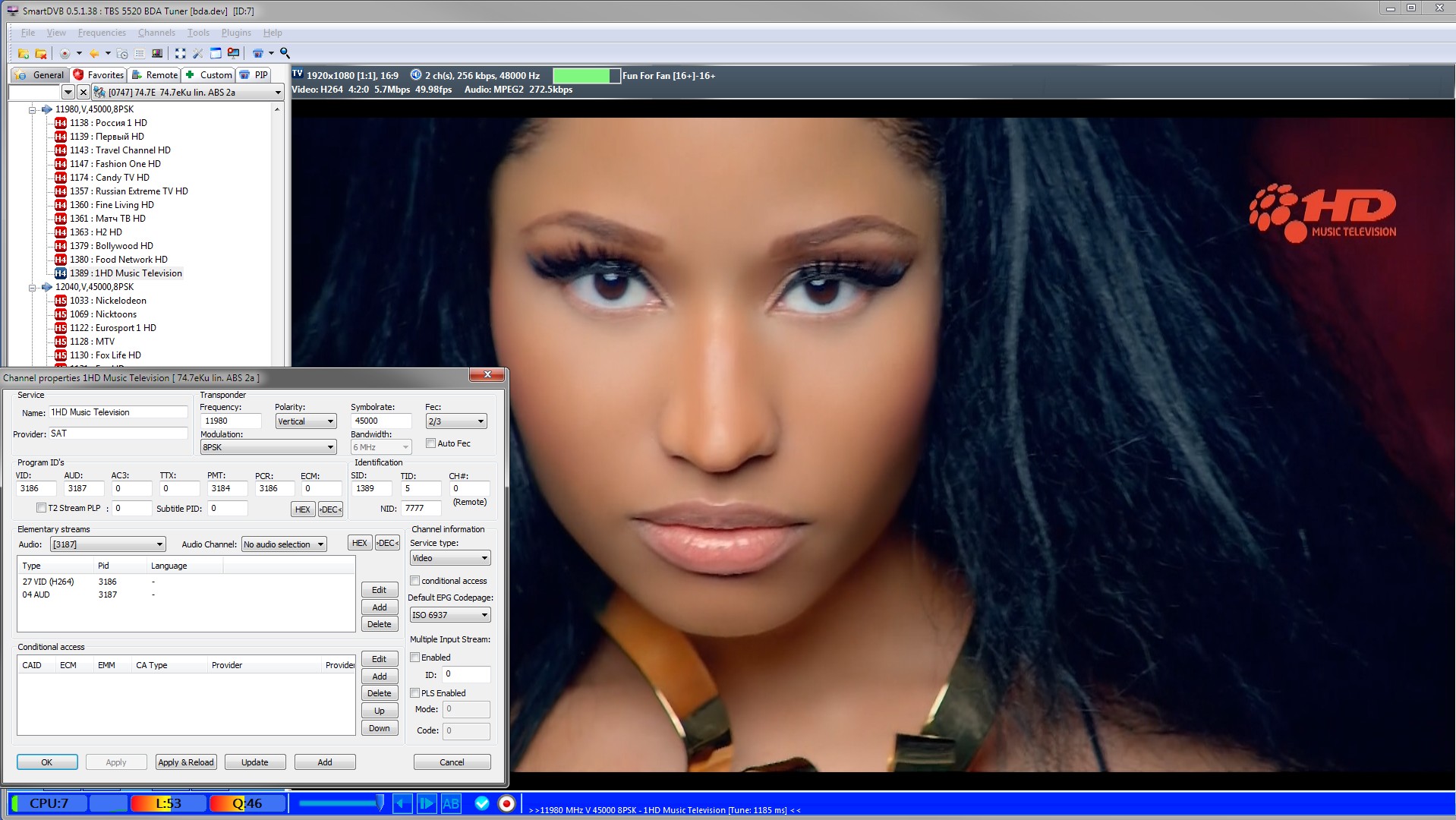

The highest SR 45000

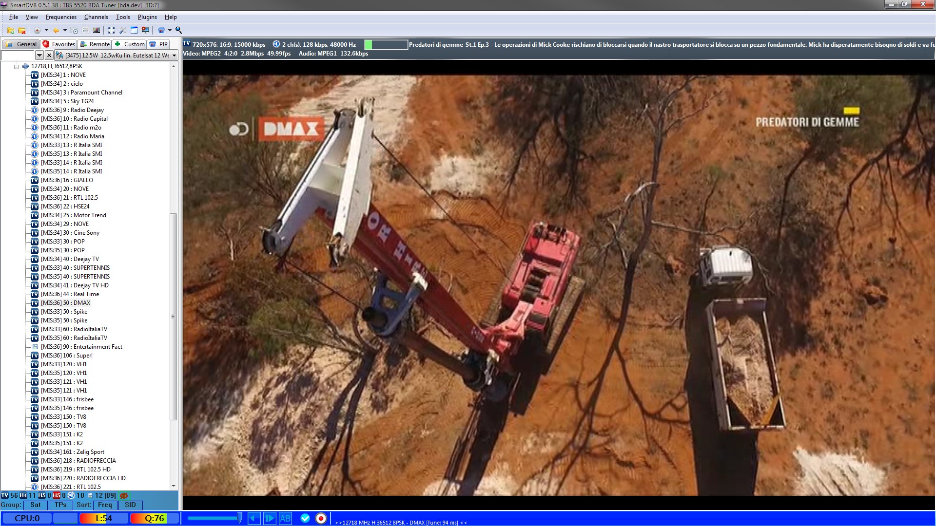

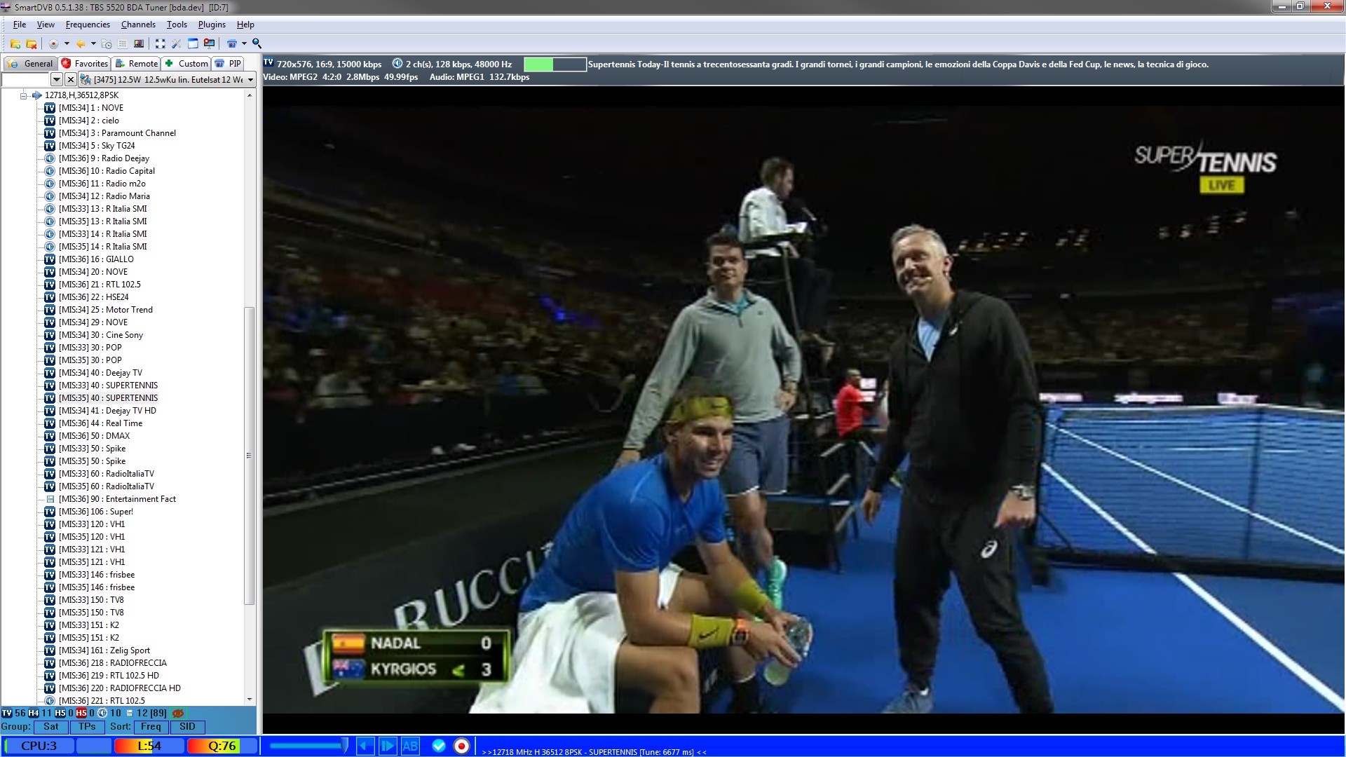

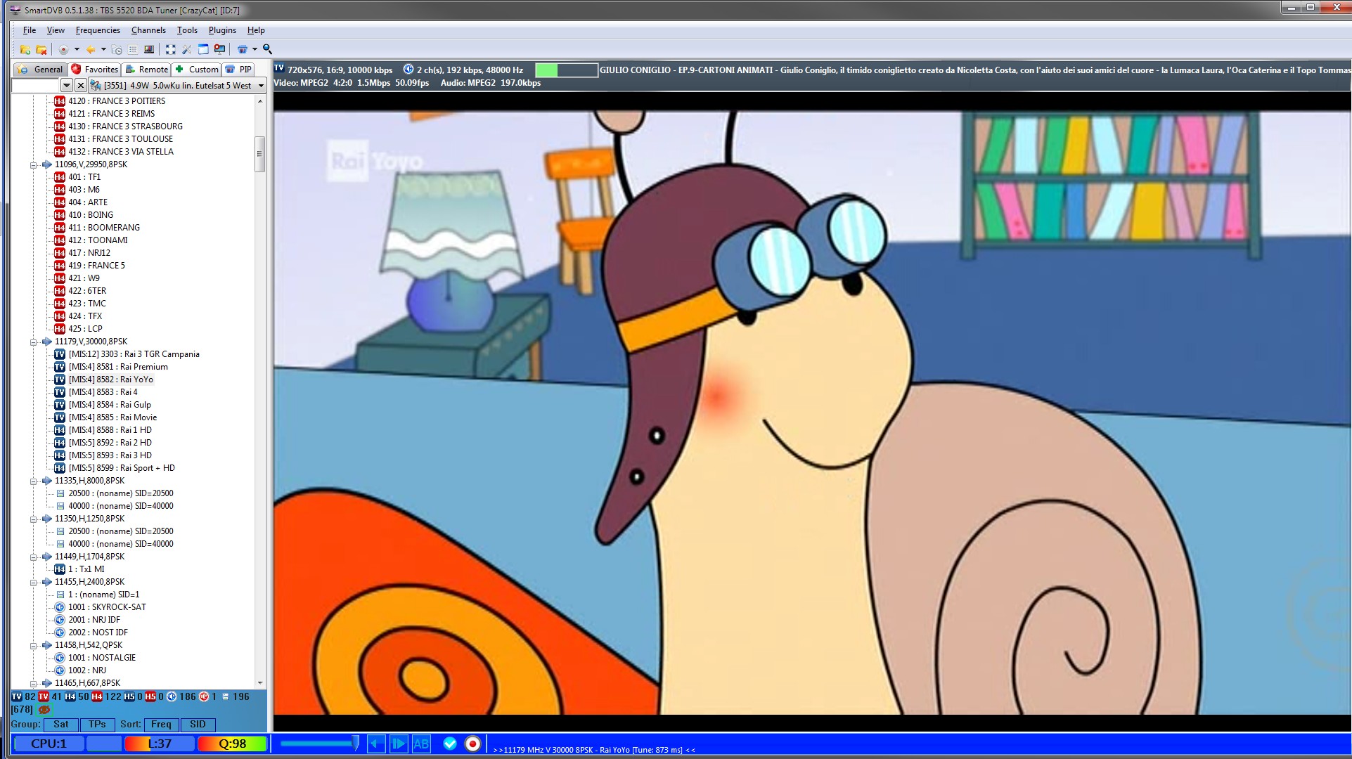

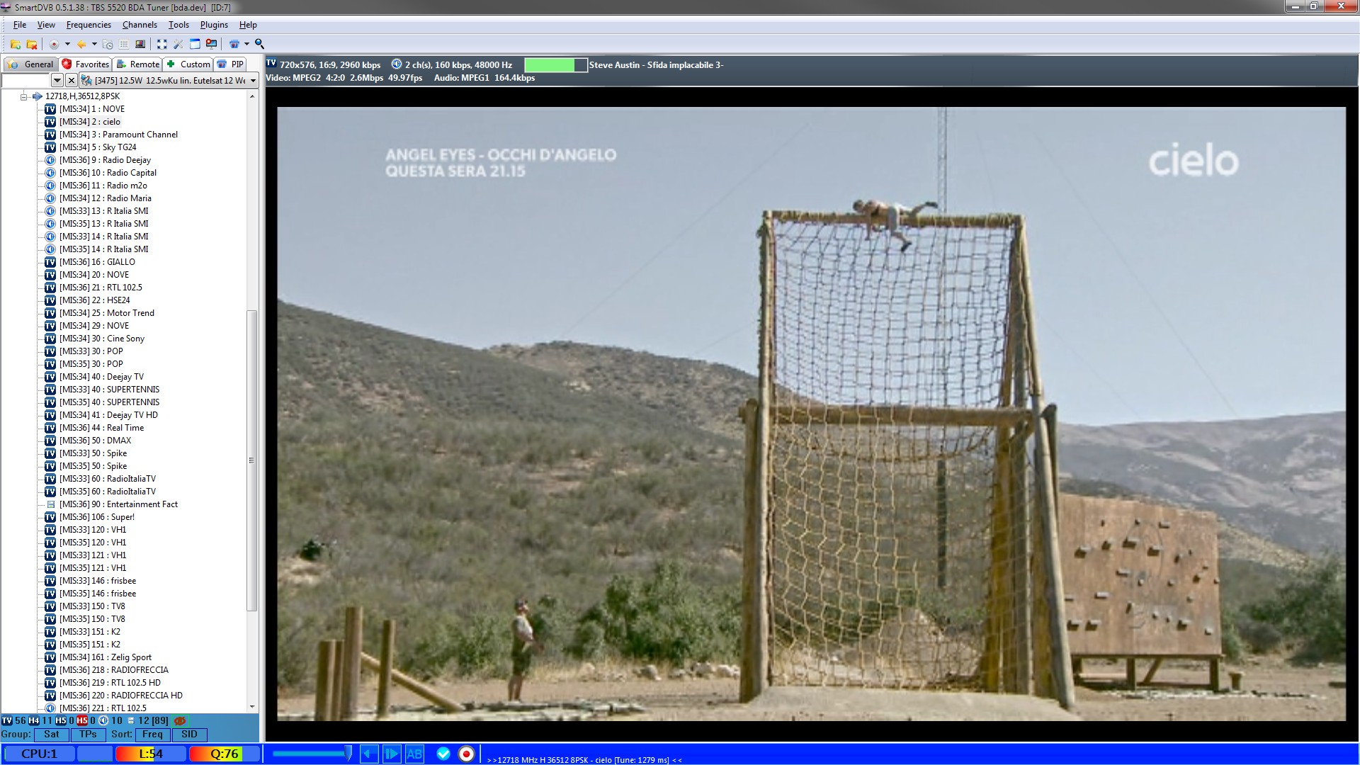

Italian Multistream @ 12.5W - MIS 33
Italian Multistream @ 12.5W - MIS 34
Italian Multistream @ 12.5W - MIS 35
Italian Multistream @ 12.5W - MIS 36

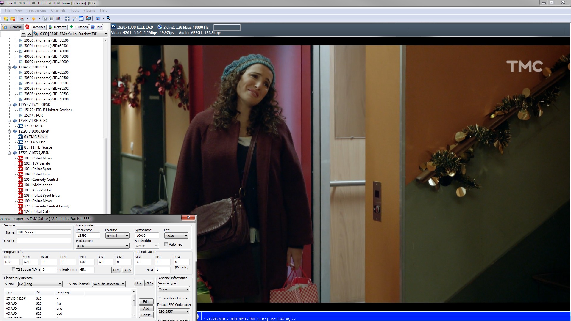

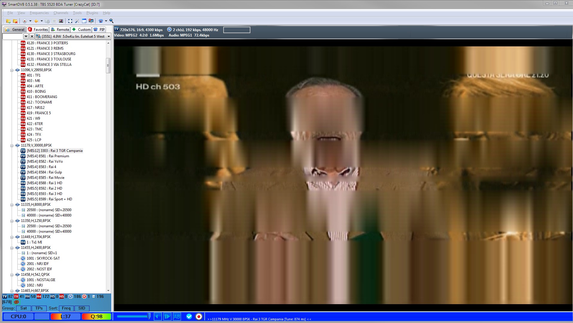

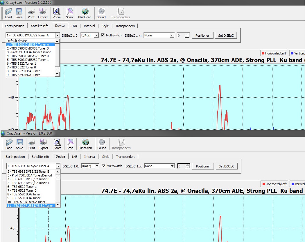

Italian Multistream @ 12.5W - MIS 12
Unknown issue that can be seen only on this MIS, but other TBS cards have no problem at all.

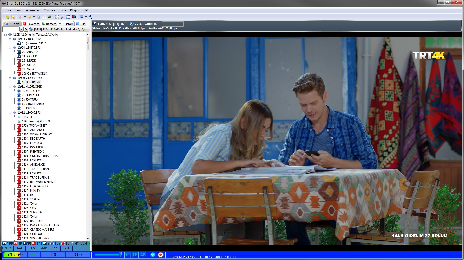

4K reception from Turksat @ 42E

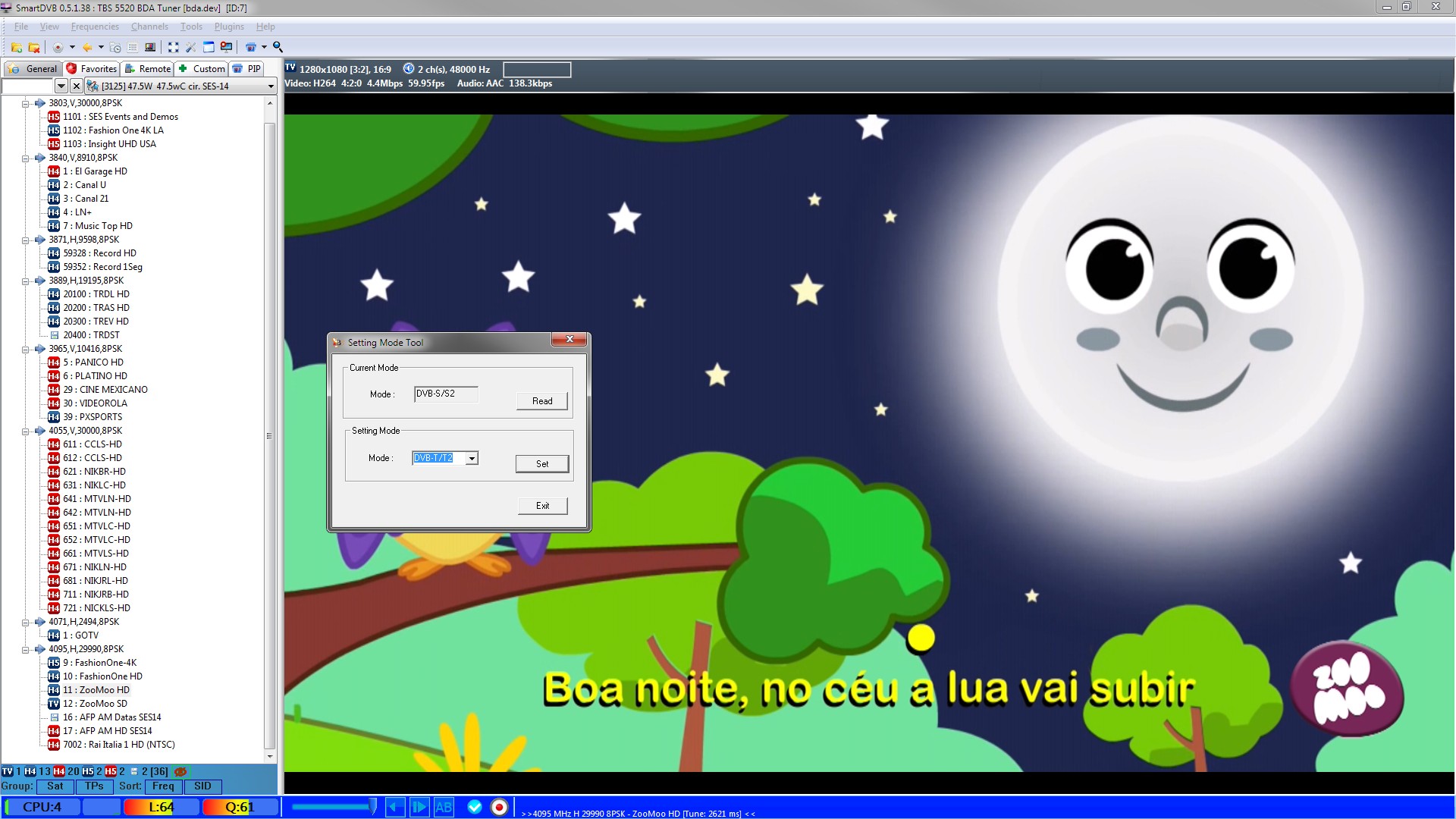

Switching from DVB-S to DVB-T
DVB-T reception

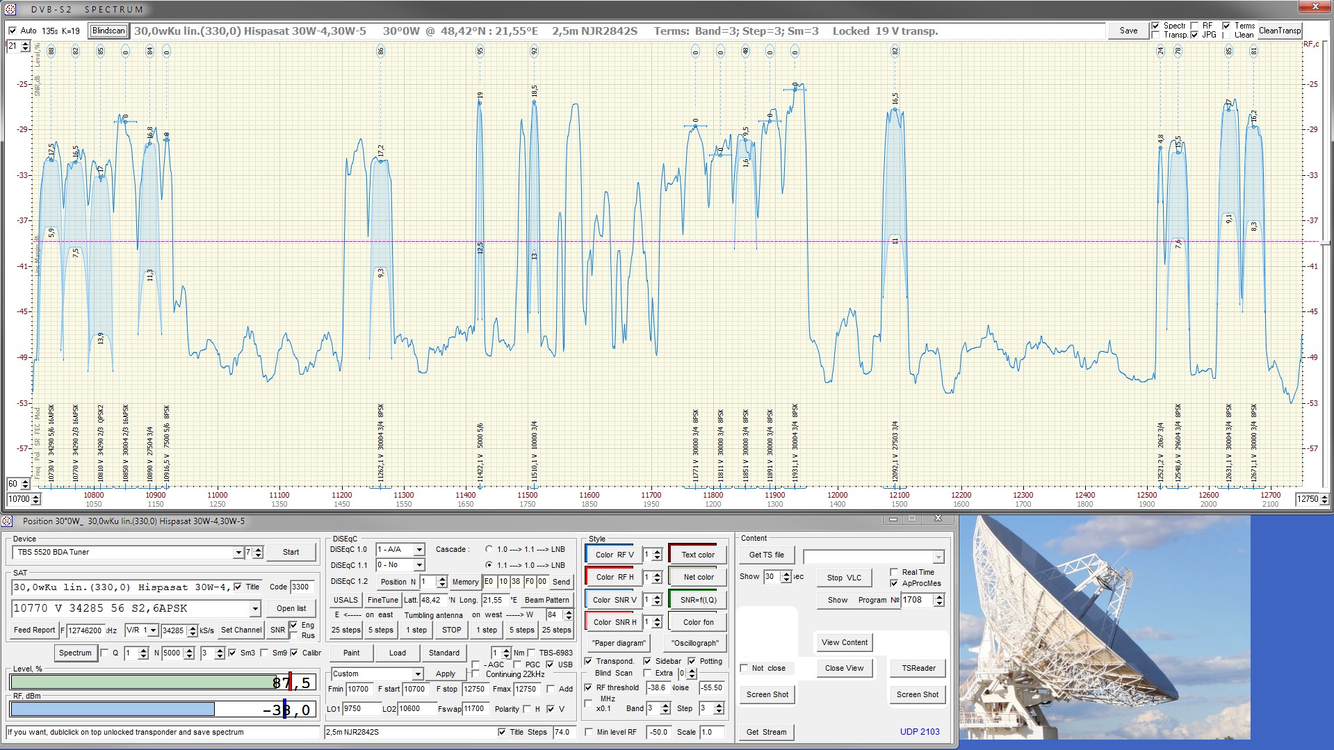

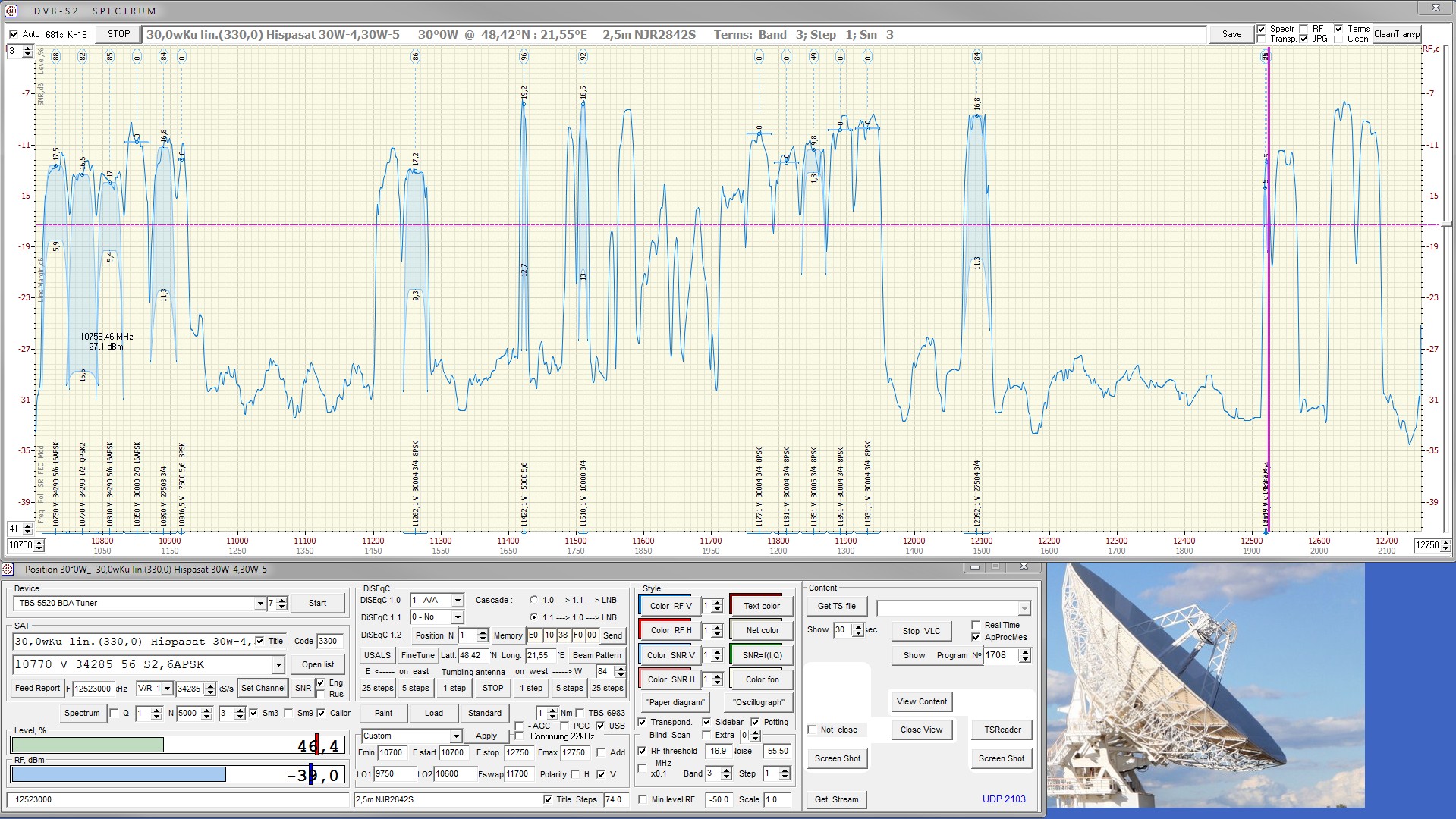

Scanning Hispasat @ 30W with IQ monitor by 3Mhz
Scanning Hispasat @ 30W with IQ monitor by 2Mhz
Scanning Hispasat @ 30W with IQ monitor by 1Mhz

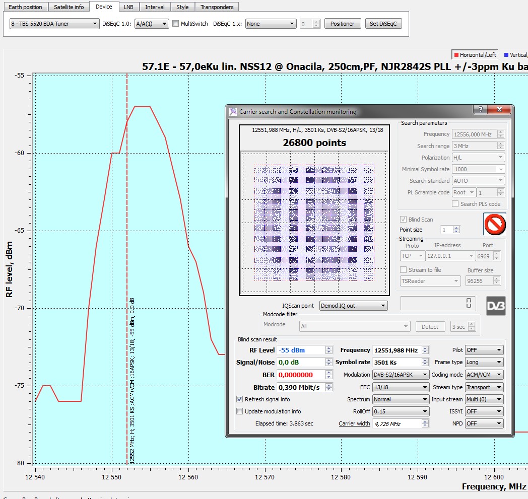

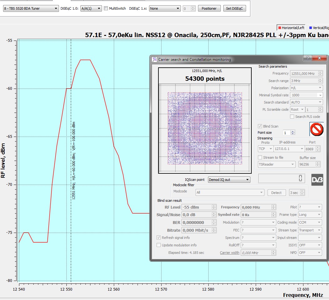

We haven`t had any luck so far to lock a DVB-S2X transponder on the proper frequency 12551 H on NSS 12 @ 57E. This can be locked occasioanly if lucky enough if frequency is slightly shifted to a few MHz above. There is no issue like this with other cards, so the signal quality or the NJR PLL LNB is not the problem in this case.
DVB-S2X signal not locked on NSS 12 @ 57E
Tricky DVB-S2X reception on NSS 12 @ 57E
No matter what, this card si still a pretty good bargain. Because we closely colaborate with Tenow if it comes to solving reception issues, problems that are mentioned above can be solved by the company or improving by CrazyCat whose work we all deepy appreciate.

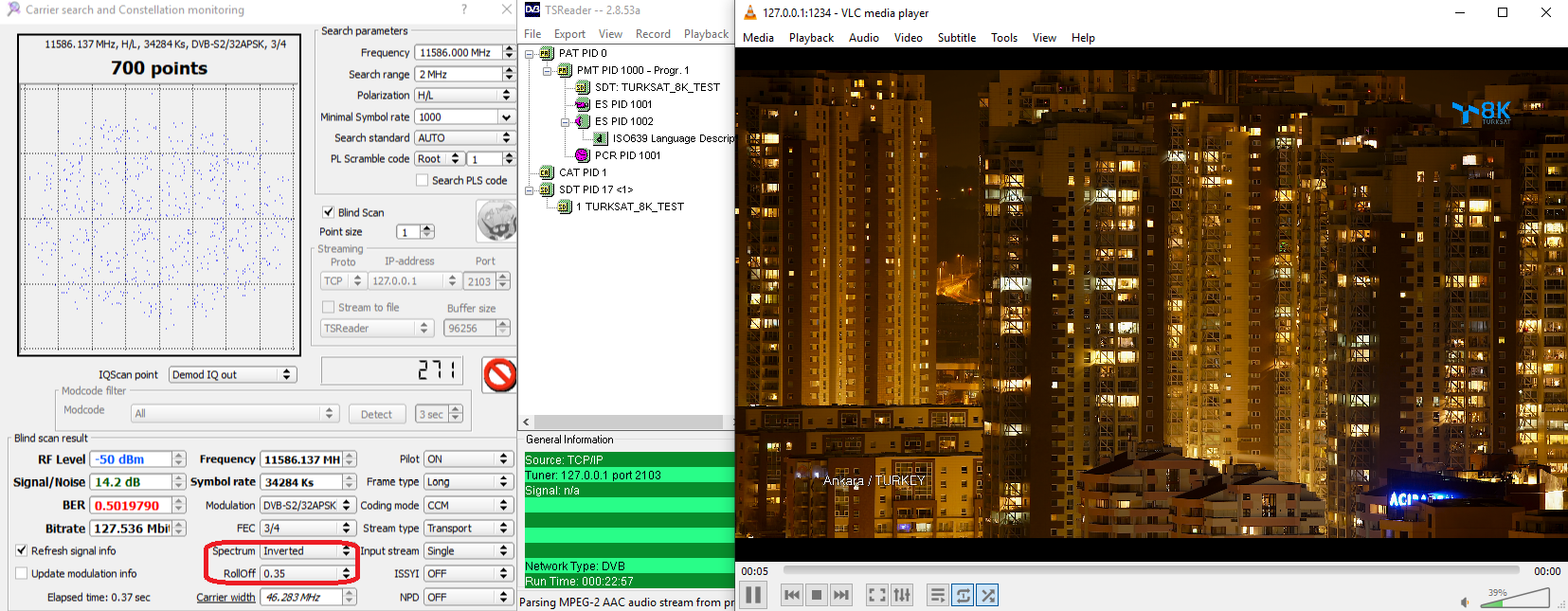

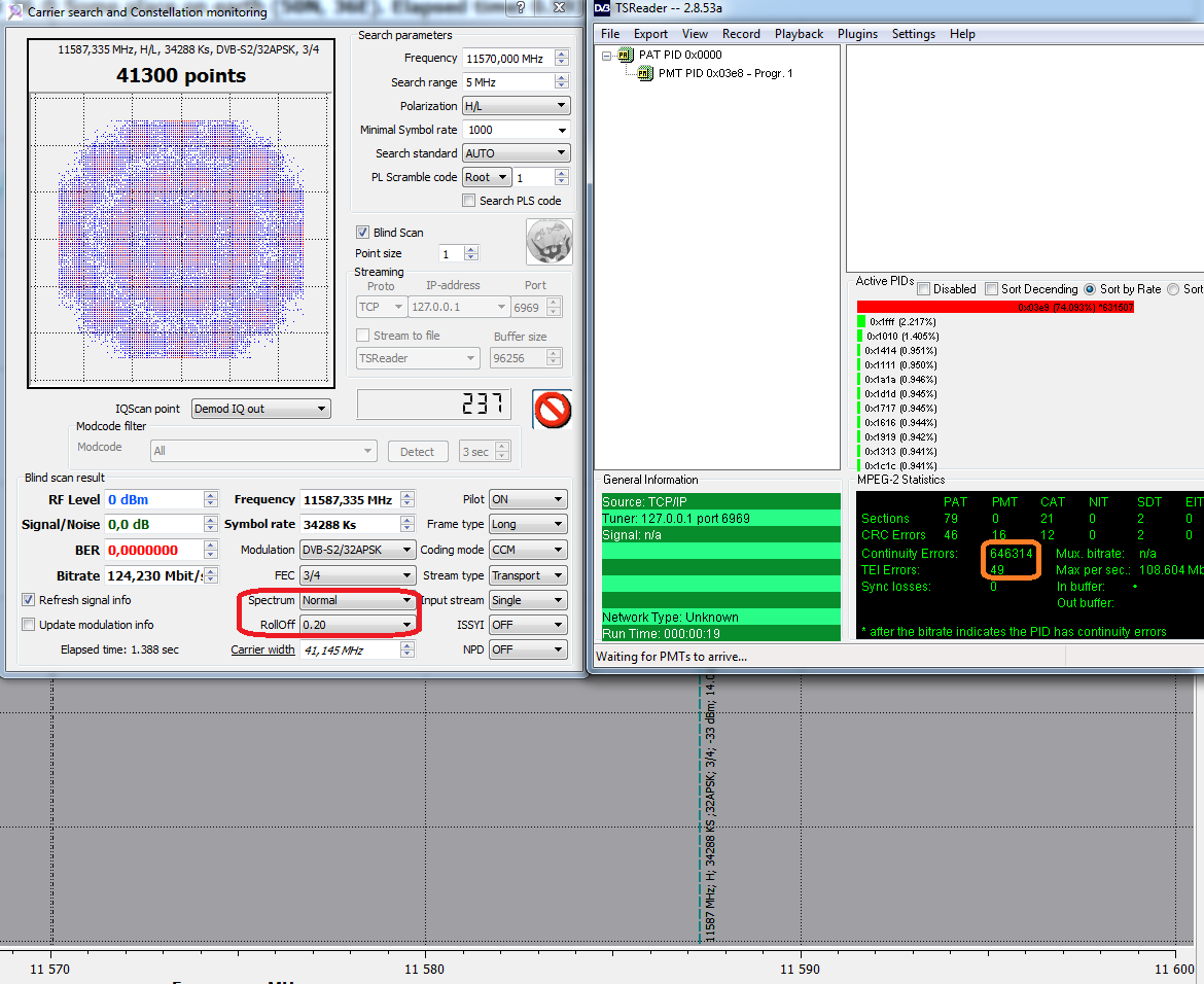

I want to add one more issue with TBS 5520SE on 50e 11587h34290 32APSK TURKSAT_8K_TEST channel viewtopic.php?f=195&t=25106
Can you confirm that on big dish?
TBS 6983 good
TBS 5520SE bad
