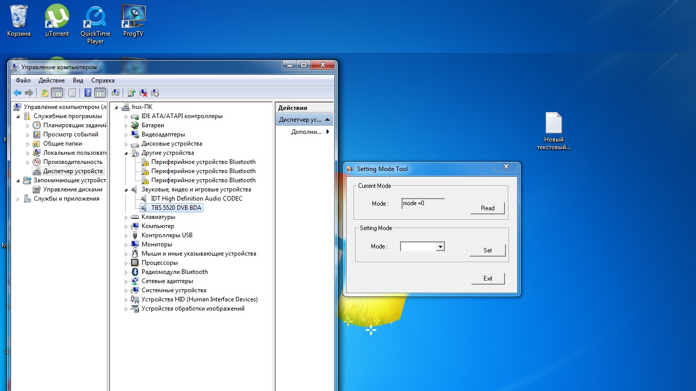

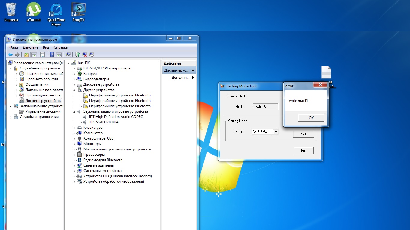

Hi.
Acquired TBS5520se, only works in the DVB-T/T2. ChangeModeTool does not switch the mode. It gives an error. OS Win7 pro 64 bit Win10 64bit home

Postby steven » Thu Jun 22, 2017 2:49 pm
hus Wrote:Hi.
For 5520SE problem can you set a teamview remote we will have a remote check with this
Re: New TBS5520SE drivers problem
Postby VictorLS » Fri Jun 23, 2017 1:41 pm
hus
Has the same error in WinXP and Win7x64 (I don't like Win10). It occurs with newest 1.0.0.5 driver only, so you can try previous 1.0.0.4 driver https://www.tbsiptv.com/download/tbs552 ... .0.0.4.zip and I'm sure TBS5520se_ChangeMode_Tool.exe 1.0.0.1 will switch modes well or wait for i.e. 1.0.0.2 TBS5520se_ChangeMode_Tool (or next version driver compatible with TBS5520se_ChangeMode_Tool.exe 1.0.0.1).
PS. I use CrazyCat's test driver 1.0.0.5 in WinXP and Win7x64 because of this issue with newest 1.0.0.5 officiall driver because I often switch between DVB-S2 to DVB-T2 and reverse )
PPS. Hope TBS will correct switching issue soon.

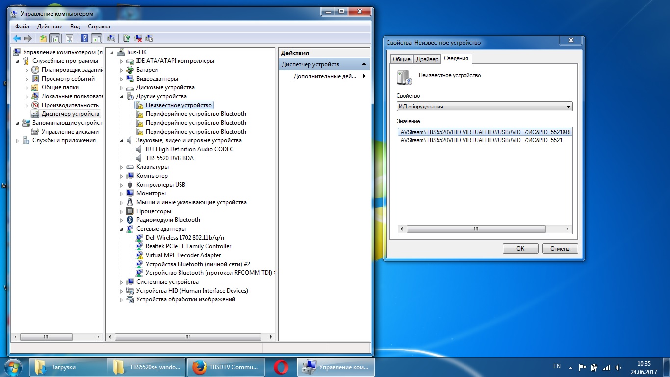

Driver v1.0.0.4 ChangeMode_Tool.exe 1.0.0.1 is running fine. After installing the drivers v1.0.0.4, there is a unknown device, what the device is.

Postby VictorLS » Sun Jun 25, 2017 1:29 am
Thank you VictorLS!
You're welcome.
I'm Russian too from Russia's Crimea - that's great.
As CrazyCat said - it's atavism from some model with infrared remote control.
Don't worry about...
