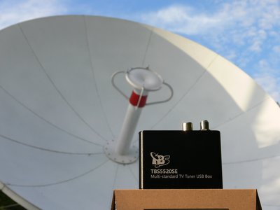

TBS 5520SE and Peon`s NWIEE 3.7m antenna

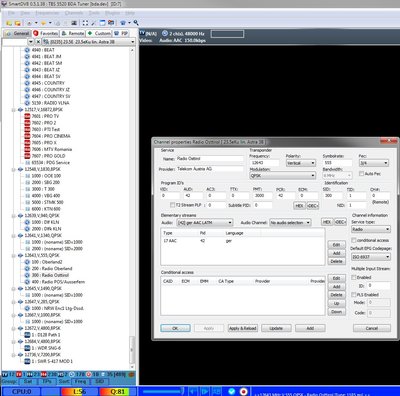

The lowest SR 555

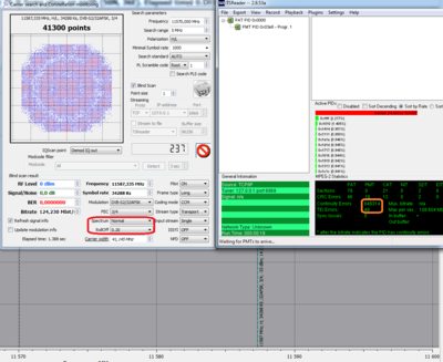

The highest SR 45000

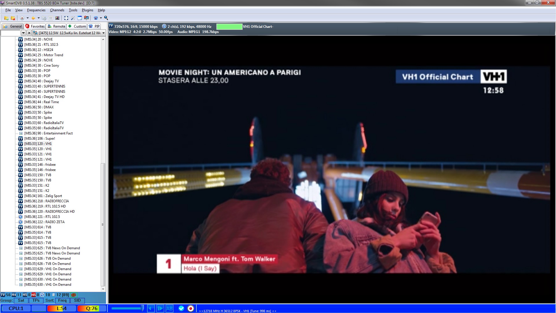

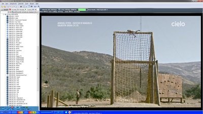

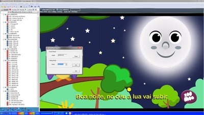

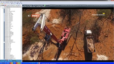

Italian Multistream @ 12.5W - MIS 33
Italian Multistream @ 12.5W - MIS 34
Italian Multistream @ 12.5W - MIS 35
Italian Multistream @ 12.5W - MIS 36

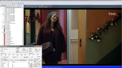

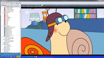

French Multistream @ 5W - MIS 4

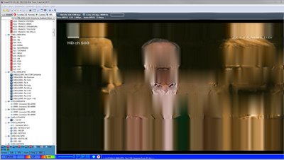

Italian Multistream @ 12.5W - MIS 12
Unknown issue that can be seen only on this MIS, but other TBS cards have no problem at all.

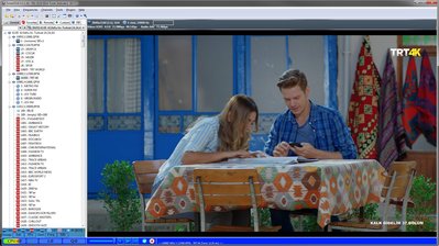

4K reception from Turksat @ 42E

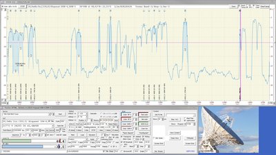

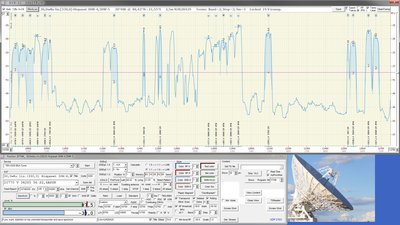

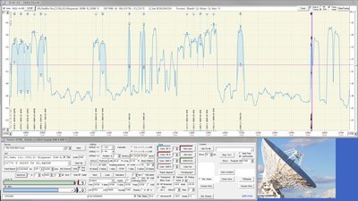

Scanning Hispasat @ 30W with IQ monitor by 3Mhz
Scanning Hispasat @ 30W with IQ monitor by 2Mhz
Scanning Hispasat @ 30W with IQ monitor by 1Mhz

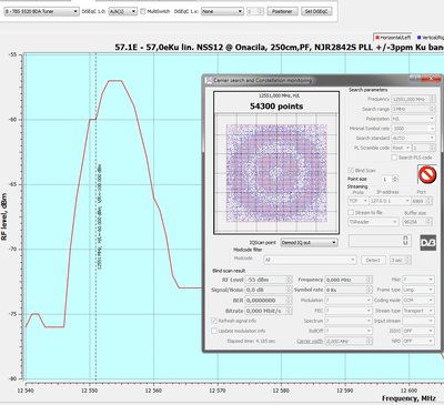

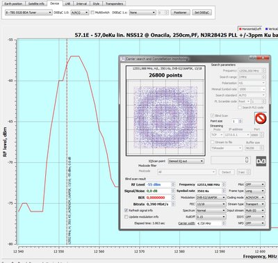

We haven`t had any luck so far to lock a DVB-S2X transponder on the proper frequency 12551 H on NSS 12 @ 57E. This can be locked occasioanly if lucky enough if frequency is slightly shifted to a few MHz above. There is no issue like this with other cards, so the signal quality or the NJR PLL LNB is not the problem in this case.
DVB-S2X signal not locked on NSS 12 @ 57E
Tricky DVB-S2X reception on NSS 12 @ 57E
