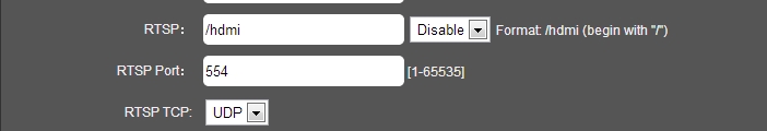

Hi, Please change "RTSP TCP" option to udp,and try change Packege Type and check again.

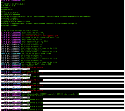

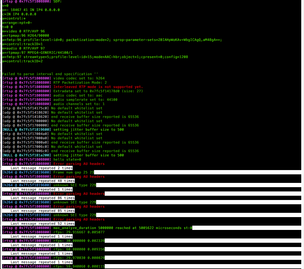

Thanks for the input. I've tried both the "A" and "B" settings as well as TCP and UDP and get the same issues. This is what I'm getting. I also get a lot of "Error parsing AU headers" which I can't find much about online but I'm guessing it has to do with the "Interleaved RTP mode is not supported yet" error. Thanks for your help.
