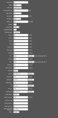

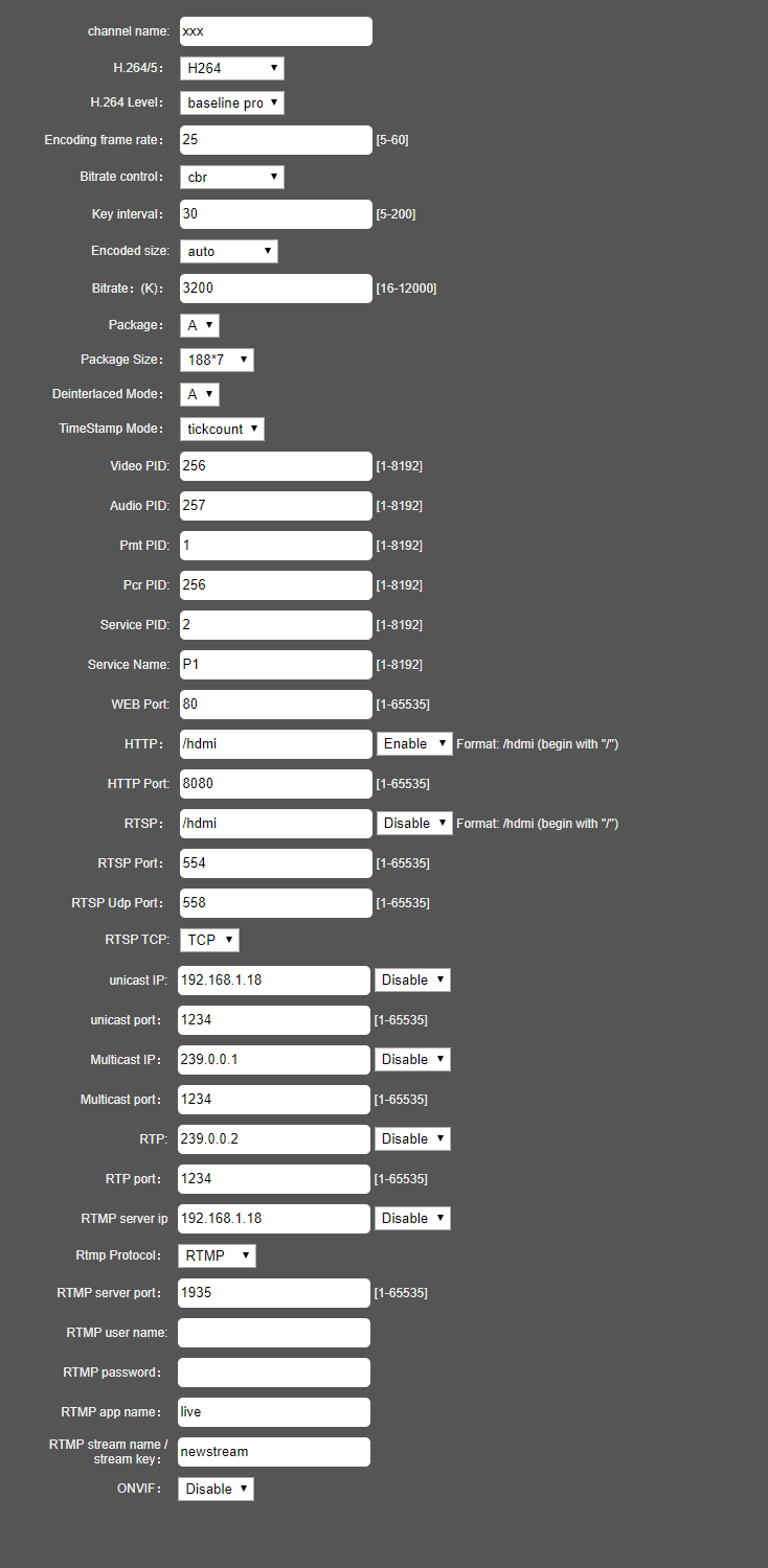

Maybe i'll send you a newer firmware, please upgrade for you Encoder and try:
http://www.tbsdtv.com/temp/tbs2603_firmware_v1.2.04.zip
download and unpack the zip package, and then upload "update.tar.bz2" to upgrade.
Or can you show us your setting? maybe some settings incorrect.

Tried this firmware but again same result.
