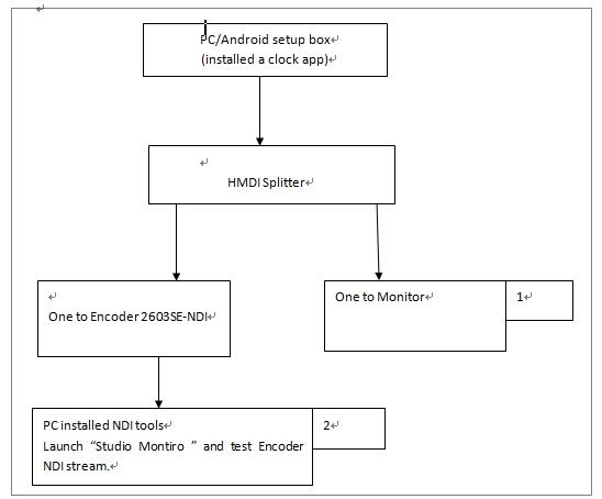

Postby daowei » Mon May 18, 2020 3:55 pm
My testing It's around 300ms.
Posts: 141
Re: Tbs 2605/2603 ndi
Postby daowei » Mon May 18, 2020 4:09 pm
Again. The left side is NDI tools----Studio Monitor display:
http://www.tbsdtv.com/tmp/latency_ndi.JPG
Posts: 141
Postby Kelmit » Mon May 18, 2020 8:09 pm
daowei Wrote:Hi,
Thank! On a 2605 device with two 4k delay signals the same 300ms?
