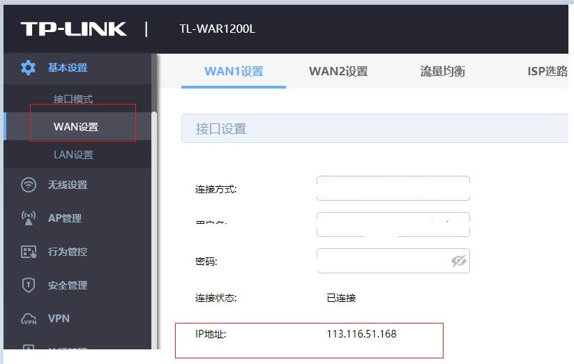

Postby daowei » Mon Dec 30, 2019 9:47 am
I don't think so. Encoder port is same. Check mine, i open an Encoder:
http://113.116.51.168:6908 root/root
My wan ip is not a fixed, maybe each 1-2 days will change. Please check ASAP.
Please preare a remote check, let me check your "port forwarding" setting.

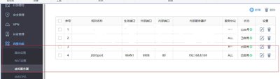

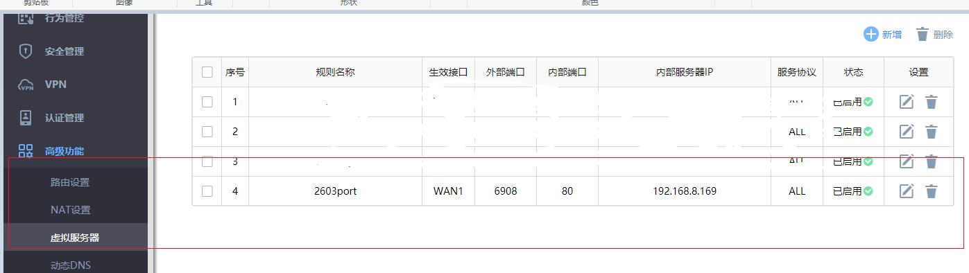

Postby daowei » Wed Jan 01, 2020 9:06 pm
For Router "Port_forwarding", you should define an external port yourself manually, maybe "must define" will be better here, range "0---65535" , and be careful the port you're going to set can't be taken.
you must define yourself. Not Router or any guy can help you to set it.
Here, external set to "6908", so port "6908" is directing to "80". clear? If port forwarding didn't work, how you can access to my Encoder?
My Encoder is in local, local enviroment, IP=192.168.8.169, cause i do "port_forwarding.
I think you didn't understand how to do Router "port forwarding" at all, please google more about Router port_forwarding explaination.
