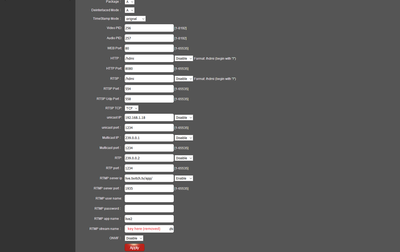

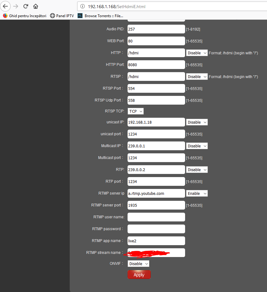

Ive tried the same way as stated here in the forum for Youtube and Facebook viewtopic.php?f=187&t=24785
Is it possible and if yes how?
If not then i bought the wrong encoder
Regards, Mike

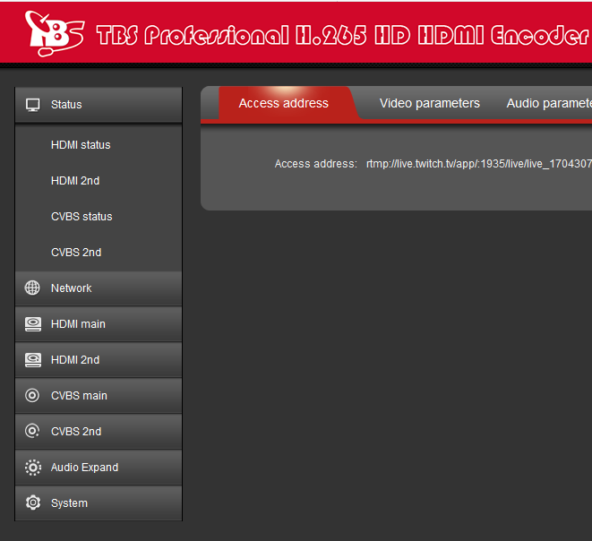

Mike Wrote:I think the problem is that the port number is showing in status and Twitch probably wont like that.
Twitch want it as following: rtmp://live-ams.twitch.tv/app/{stream_key}
And the encoder shows in status: rtmp://live-ams.twitch.tv:1935/app/{stream_key}

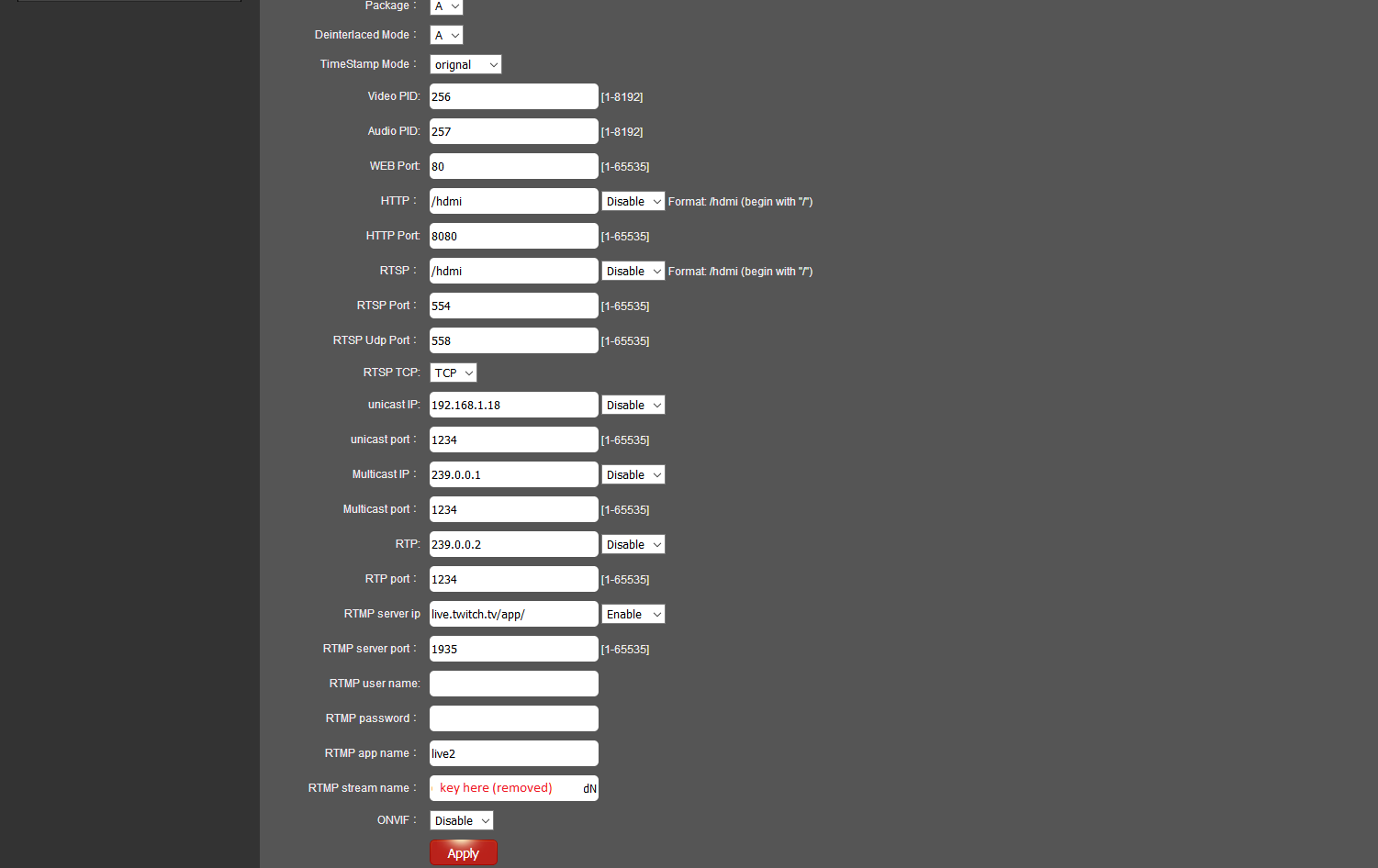

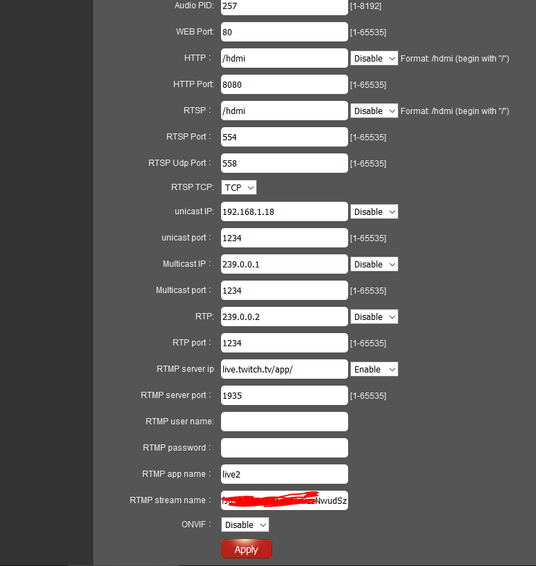

Mike Wrote:Tried it didnt work for me
I think there should not be "live2" at "rtmp app name" for Twitch but removing it didnt make any difference is just not working for me.
Youtube also didnt work
Ive tried the HDMI2 and there i cant even fill in the live.twitch.tv it says not a correct ip number?
I can stream internally rtsp to VLC that works.
Streaming with software OBS or Streamlabs to Youtube or Twitch works.
Dont know what to do, or i received a defective encoder or iam doing something wrong?
