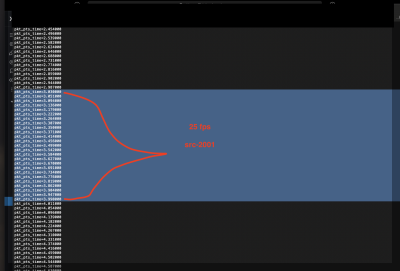

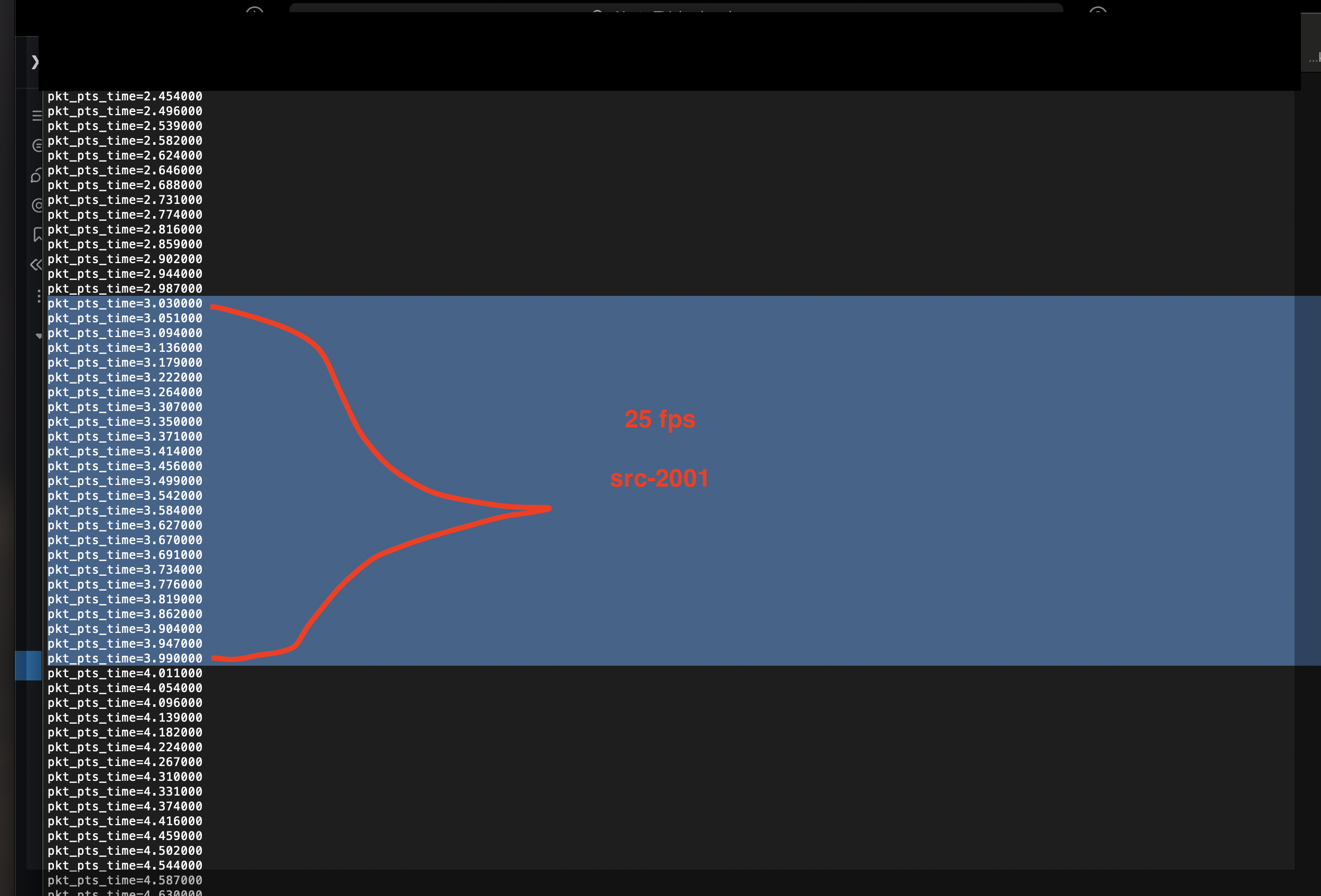

Postby Chris18391344 » Mon Sep 13, 2021 2:47 pm
In additional: Thats looks also strange.

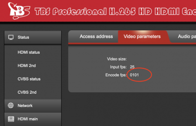

Postby Chris18391344 » Thu Sep 16, 2021 6:40 pm
Next analyze. TBS-2603 set to 50 frames in Webinterface (rebooted), but the RESULT has only 25 frames.
