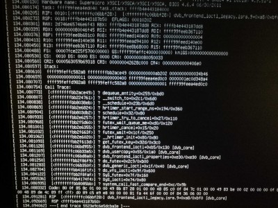

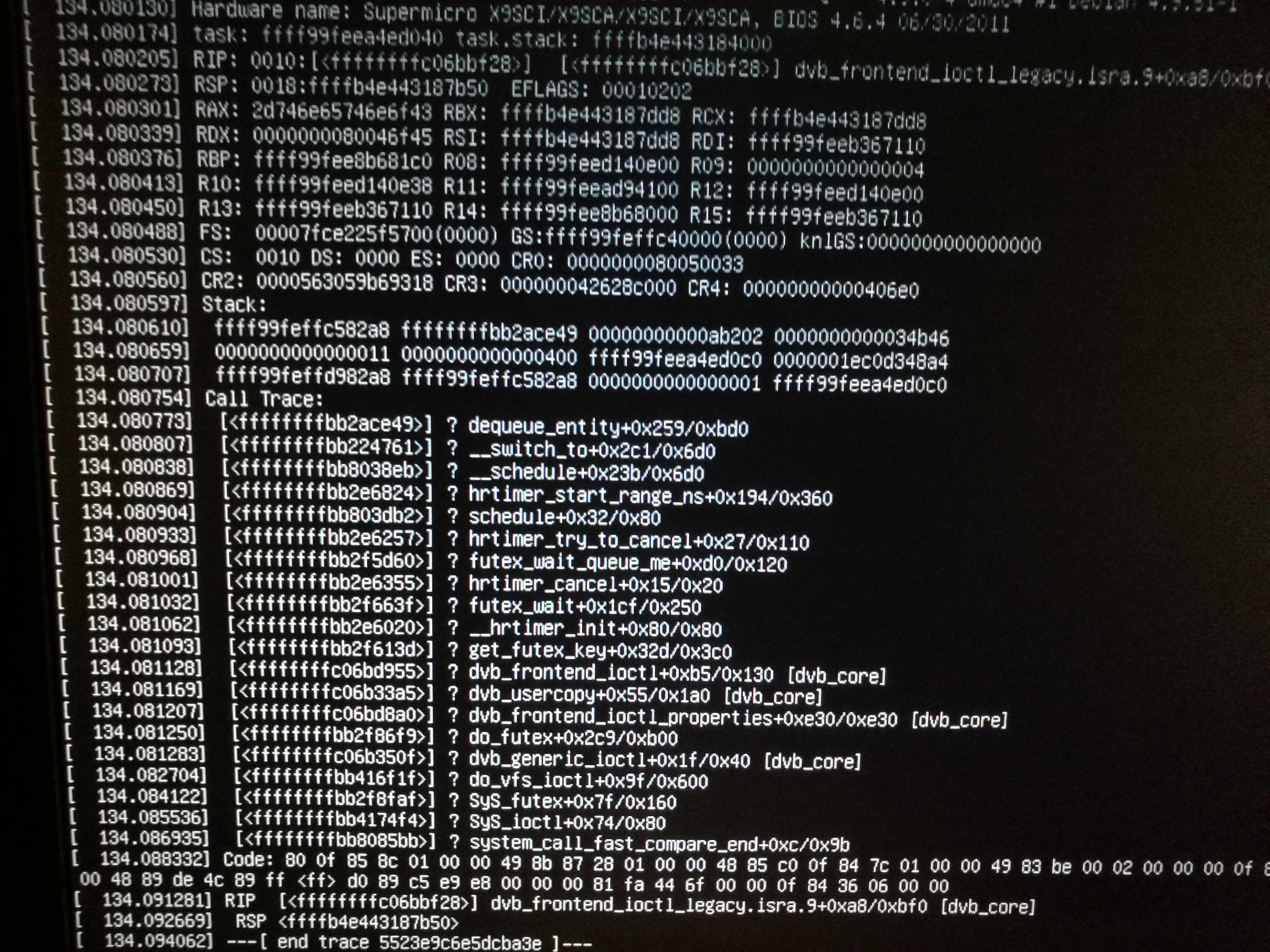

Hi guys!
I'm trying to run two 6902 on my Debian Stretch Server with Tvheadend 4.2.4-23.
I did compile the driver using the wiki.
If the card on my first 4x-pcie-slot is activated the Server is running fine.
When i activate the 2nd card it takes some time and my SERVER crashes.
When swapping cards or activating only the card on the second slot the Server crashes too.
