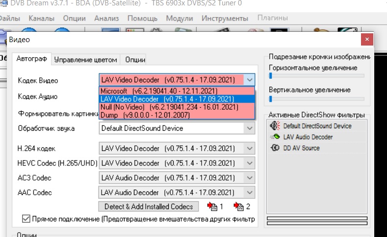

Who has this card working normally with this program? Some codecs do not work for me, on the other bda other codecs streamreader installed.
DVB Dream 3.7.1 the license is very strange, the trial version is written in the installation ...
it is not displayed that the program is registered to the owner of the license
This error also occurs often
Can not create source filter. You must run ddreg.bat to register DD AV Source Filter"

some video and audio codec you need to install first you can try to install ProgDVB it will auto install some codec for you

both tuners do not work together. And some serious error is still issued.

you can create two folder of DVBDream , one folder one tuner. do you mean that
with DVBDReam3.60 works well but 3.7.1 have issue ?

Check StreamReader.ini.
If there's a line:
DemodMode=1
change to
;DemodMode=1
(I'm not sure if this setting is supported in 6903x, but it's worth to check).
Also try DVBDream, but not using StreamReader, but BDA to confirm if the issue is not related to StreamReader somehow.

DemodMode only for STV9xx - dual/single mode.
