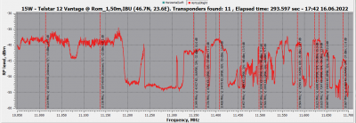

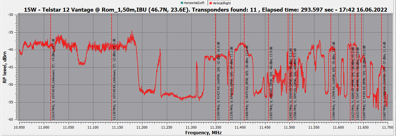

Postby satesco » Mon Jul 11, 2022 2:03 am
Here is an example with transponders having more than 100000 Ks/s found and locked with tbs6903x.
