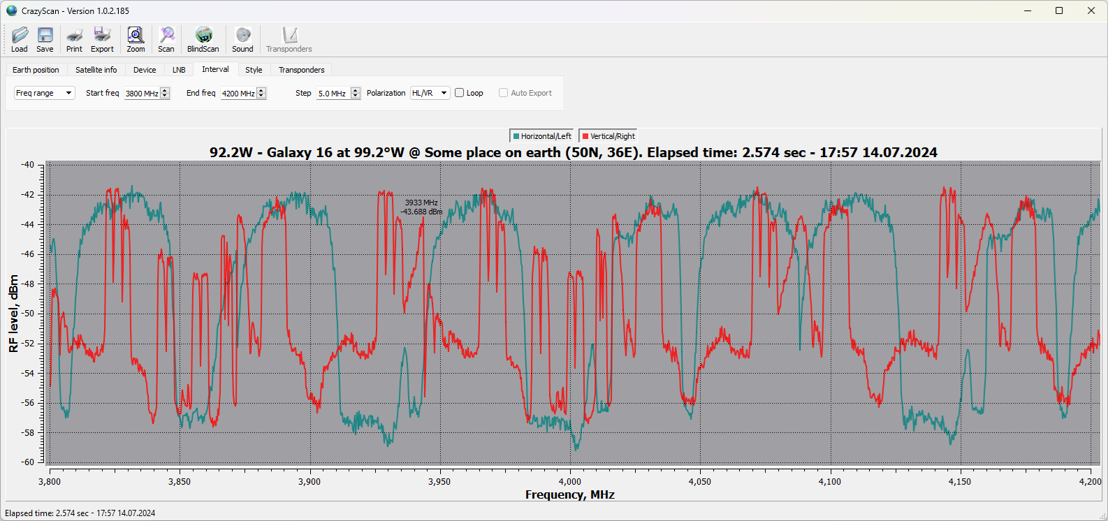

smile Wrote:This is just a sample of all of the errors from Frequencies 3800 to 4200 both H & V polarities on all CBand satellites. There are no issues with KU Band.
Signal quality (SNR * 5) is bad for 8PSK,3/4. Look like some issues with FBC tuner in STiD135.
P.S. Can you make spectrum scan with CrazyScan on selected range 3800-4200 H/V ?

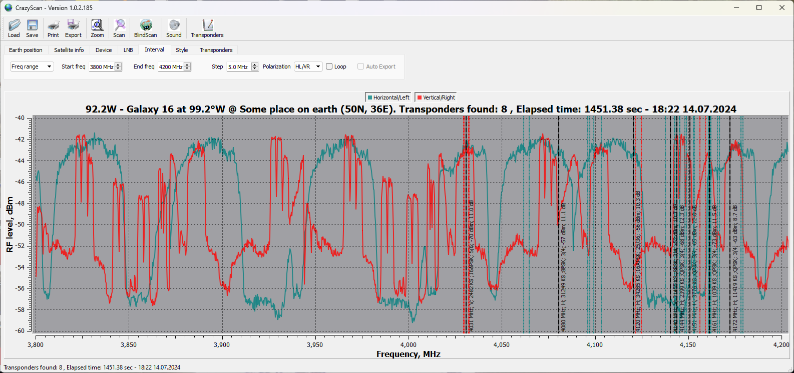

I hope these Screenshots capture what you requested? Thanks!
RFScan
BlindScan

A lot of weird patterns visible on the screenshots from CrazyScan.
E.g. RF on vertical:
Between 3800 and 3950 - copied to 3950-4100.
Reported transponders have got no reflection to the graph, e.g. the middle of 4120H (high SR) is marked at the end of increased RF Level graph. 4140V (again high SR) is marked in the middle of small RF Level peaks.
Basically graph shows garbages, not related to the real situation.
@Babadem Did you set up LNB LOF correctly, exactly as your C-band LNB says? Because data from RF Level has got nothing to do with real situation and it looks like a misconfiguration.
Please switch to L-band and re-do graph/blindscan - RF Level must correspond to detected carriers and now it does not.

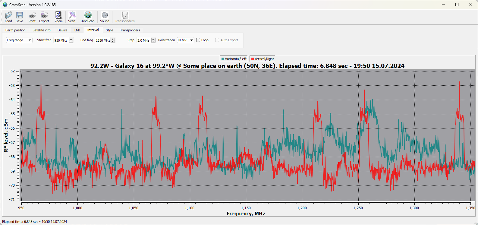

Below are ScreenShots of LBand Scans as requested. By the way LOF is set to 5150 and using the "Test" StreamReader ver. 1.2.5.194
LBand BlindScan
LBand Scan

Thanks, still looking very weird, but that's not a LOF issue - by using L-band we took away any calculations and this should represent exactly what tuner gets from the LNB.
E.g. 1070H - high SR, so a wideband signal - detected in the middle of nowhere on the graph (red is V).
Only 950-1350 scanned, but all signals looks very narrow on the graph, which would carry rather a low-SR broadcasts.
Something fishy going on here...

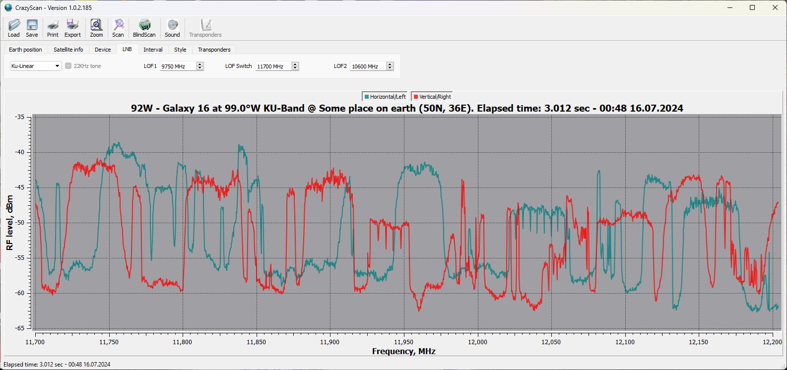

Below, I have posted KU-Band Lband Screenshots of my scans for Analysis. As I indicated before, it should be noted; I have no errors on KU_Band frequencies.
KU BlindScan
KU Scan
