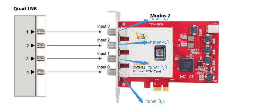

Postby steven » Fri Mar 04, 2016 12:11 pm
Hi all
For TBS6909 diseqc usage we have two way to use .
1.first use the normal mode not the multiswitch mode need to use a config file like this:
create text file "/etc/modprobe.d/tbs.conf" with line:
options tbs_pcie-dvb tbs6909_mode=0
0 is 1 input for 2 tuners,
1 is for multswitch
6909 normal model
2.Another one we still on working ,when the user use one than one satellite multiswitch input need to choose the satellite when using
multiswitch.
first time it sends out DiSEqC to select the external mutliswitch satellite. that's tbs6909_mode=2,
options tbs_pcie-dvb tbs6909_mode=2
here is a test driver if you have interest you can have a try:
http://wikisend.com/download/365260/linux-tbs-drivers_t160302.tar.bz2

There are generally two types of connecting this card:
1) to quattro LNB where all HH, HL, VH and VL bands are set statically on each LNB output and connected to the appropriate RF IN on the card
2) to quad LNB where the card itself takes care of setting LNBs to the correct band as needed
That means that when DiSEqC switch would be used to connect to two different satellites and it would need to switch to second satellite/LNB, one of the bands from the first satellite won't be available because there would be only three connections to that satellite so it can cover only three bands and programs from the fourth band won't be available at that moment.

Postby cody » Mon Mar 07, 2016 11:19 am
@fordfrog
not really, it actually depends on what DiSEqC switch and setup you have in mind. So, first as general rule if 6909 card driver is set to Multi-Switch mode then all 4 ports on the same card need to be connected to the same satellite in order to have all bands/polarities. however, the card can be in Multi-Switch mode and at the same time be connected to external Multi-Switch that offers connected to more than one satellite. in such scenario you can use "hydrid" mode of the driver (that is mode "2") - before first adapter on the card is used it sends out DiSEqC command to select switch all 4 ports on the switch to which the card is connected to the selected satellite, then no more DiSEqC commands are sent and the card is fixed to it's regular way of work in MSW mode.
