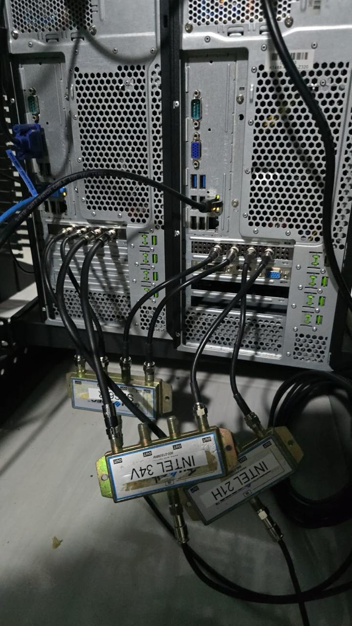

Postby EnoSat » Sat Apr 05, 2025 8:07 pm
Hi,.

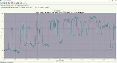

Interesting problem with TBS6909X.
Three LNBs (C-band) connected.
After switching to another tuner, Tuner0 is still being processed.
TBS6909X vendor
TBS6909X mode
TBS6909X tuner0
TBS6909X tuner1
TBS6909X tuner2
TBS6909X tuner3
Old connection with two LNBs (C-Band)
AltDVB - work only 58W
DVBviewer/TransEdit - work only 40W
55W was not found in any SW
Any idea ?

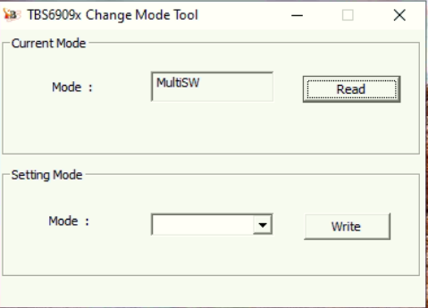

Seems like wrong mode in TBS6909xChangeModeTool - Direct Connection should be used in your case, not MultiSW.
In MultiSW mode card takes only one polarity/band from every input. You will end with randomly working satellites based on what polarity you will use and from what input.

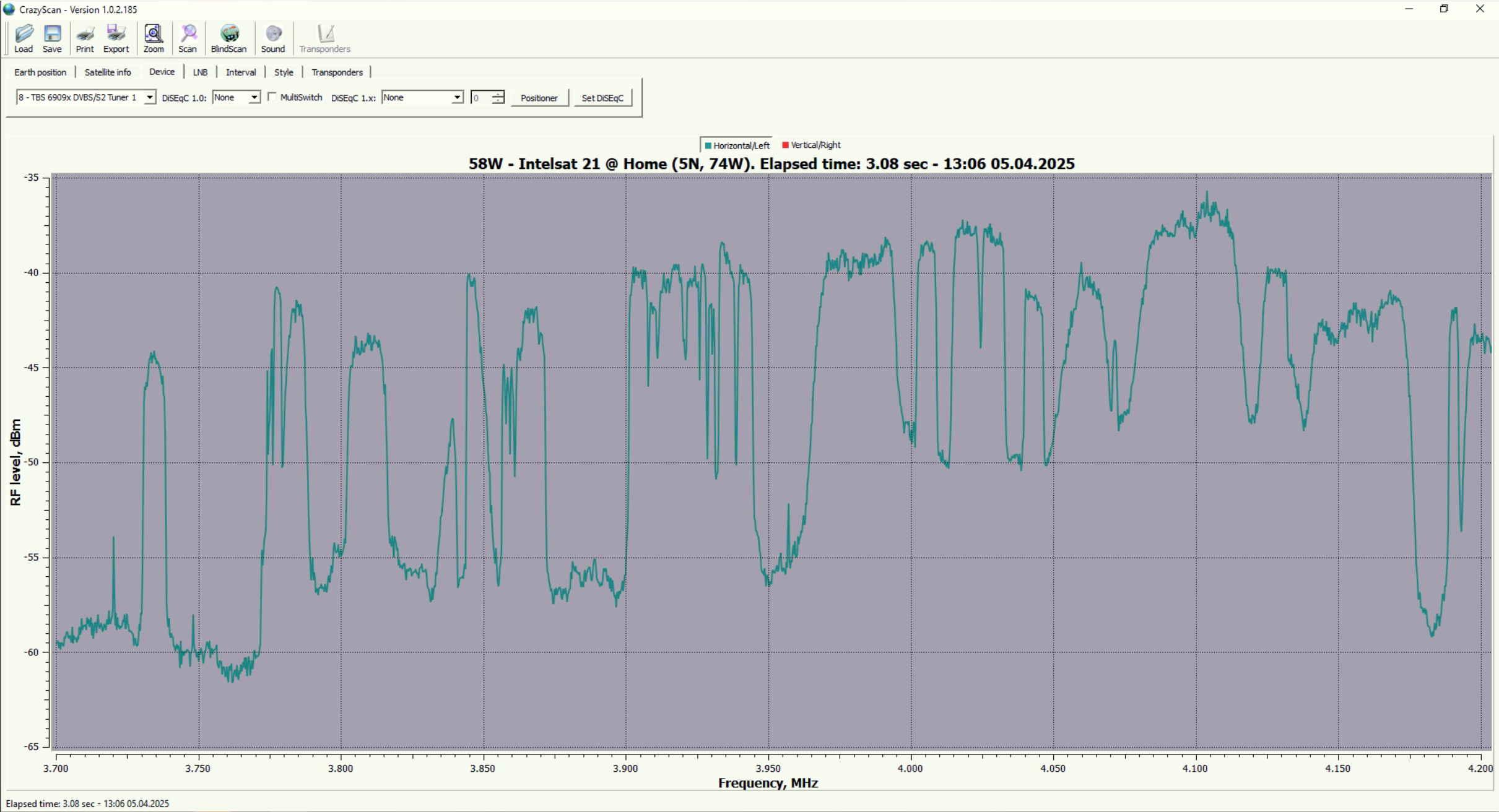

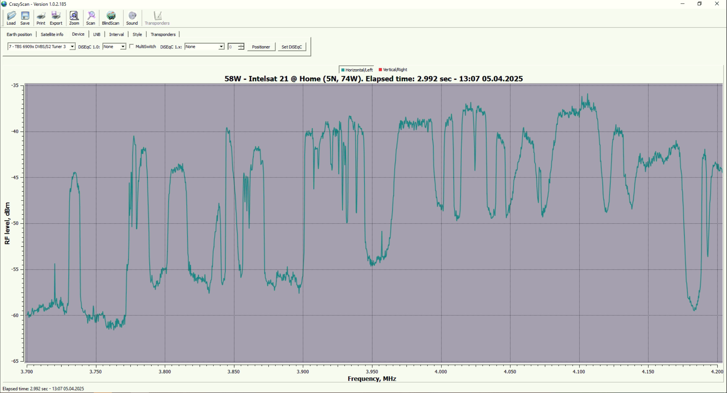

Postby EnoSat » Sat Apr 05, 2025 9:09 pm
Result similar. AltDVB no longer accepts 58W, but 40W.

Postby DVB » Sat Apr 05, 2025 9:23 pm

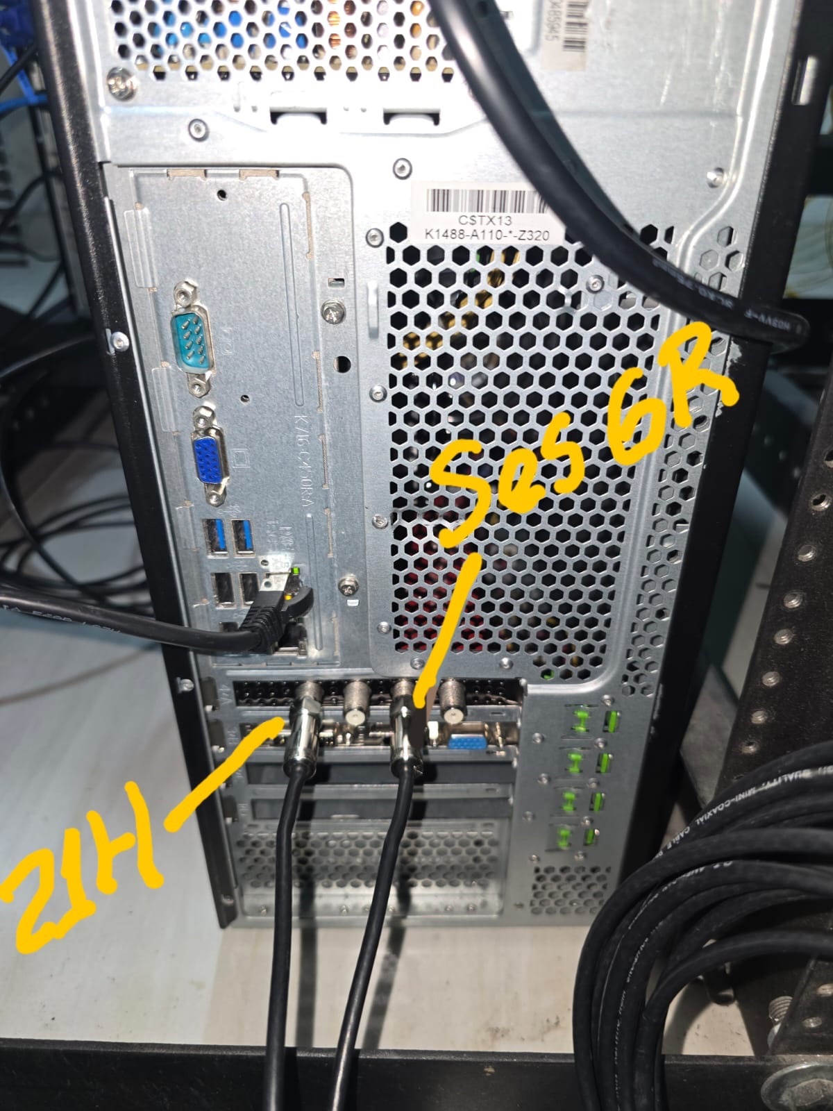

6909x is Octa, so 8 tuners.
Tuners are connected in pairs, so tuner 0 and 1 is RF Input 0, tuner 2 and 3 is RF Input 1, 4 and 5 is RF Input 2 and 6 and 7 is RF Input 3.
So based on this photo:
download/file.php?id=3407&mode=view
SES 6R (40,5°W) will be on tuners 4 and 5.
PS: If tuner 4 locked to V polarity, then tuner 5 will be limited to V polarity.

Postby EnoSat » Sun Apr 06, 2025 4:36 am
Tuner4-7 not support scan

Postby DVB » Sun Apr 06, 2025 6:17 am
Latest StreamReader.dll?
What is now on tuners in e.g. AltDVB?
In Direct Connection mode I would expect:
Tuner 0 & Tuner 1 - first satellite connected to RF Input 0
Tuner 2 & Tuner 3 - second satellite connected to RF Input 1
Tuner 4 & Tuner 5 - third satellite connected to RF Input 2
I assume that you've got RF Input 3 unconnected, so now Tuner 6 & 7 should be without any signal.

Quite elaborated setup: download/file.php?id=3416&t=1
These are just ordinary SAT splitters? This will bring two risks:
  1. If one tuner will switch e.g. 22 kHz - every other tuners will have 22 kHz switched (or polarity)
  2. Splitters should have some security against overload & short circuit - easy to burn devices in this config...
