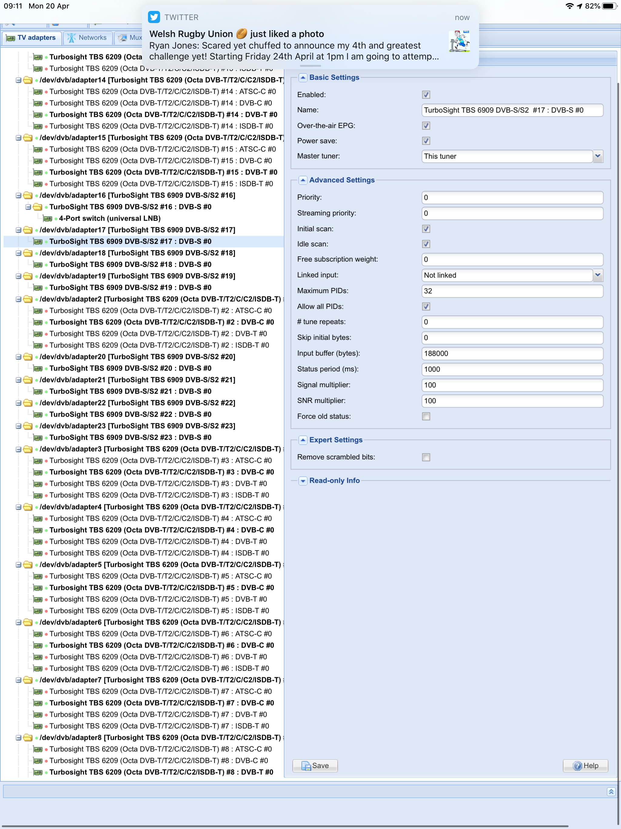

Can someone help me with this card please - only one of my 8 tuners offers me Quattro mode .the other 7 seem to work as standard tuners. Previously all 8 used to offer 4 ports .
The card is setup via 4 cables straight from lnb to the card - VL HL VH HH mode and I am able to scan all the channels on the correct 28.2e satellite.
But only 1 tuner is working correctly.
I’m using a tbs2951 amd-pro And 3 octo cards 1 6909 card and 2 6209 cards (which work perfectly )

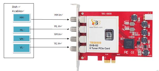

For the quattro LNB, these 4 signal/cables which from LNB have been defined to VL, VH, HL, HH. Please find it out.
And for the default, TBS6909 4 input ports have also been defined to VL, VH, HL, HH (count from the port which near the PCIe interface). I'll share you a picture.
So, please make sure signal is connected to a corresponding port correctly:
LNB VL----TBS6909 VL; LNB VH-----TBS6909 VH; LNB HL------TBS6909 HH.
Another, if you have a Satellite Receiver (setup box), please test all 4 signals (VL, VH, HL, HH) is woking. If signal is ok, but TBS6909 still not working, please setup a remote check, Teamviewer is ok for us.
