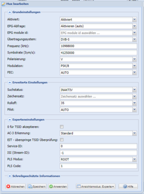

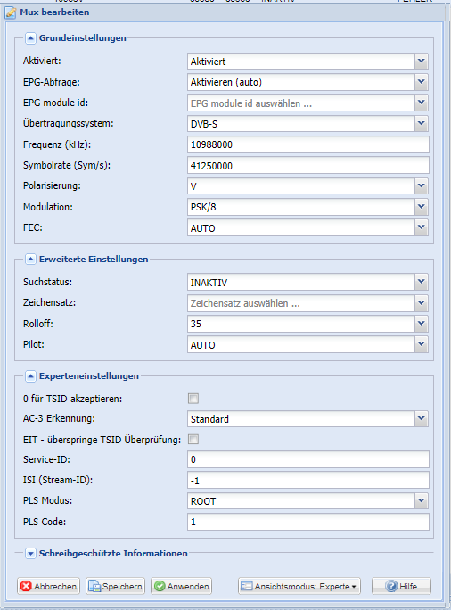

For this tuner card, if it's DVBS2 transponder, the "modulation" must be set to "PSK/8".
Posts: 141

Postby bolzerrr » Mon Jan 06, 2020 5:22 pm
it is Multiswitch with the cables connected: HH, VH,..
I Set the mode to 0 according to the documentation.
Modulation is set correctly.
Will add you later in skype.
Thank you

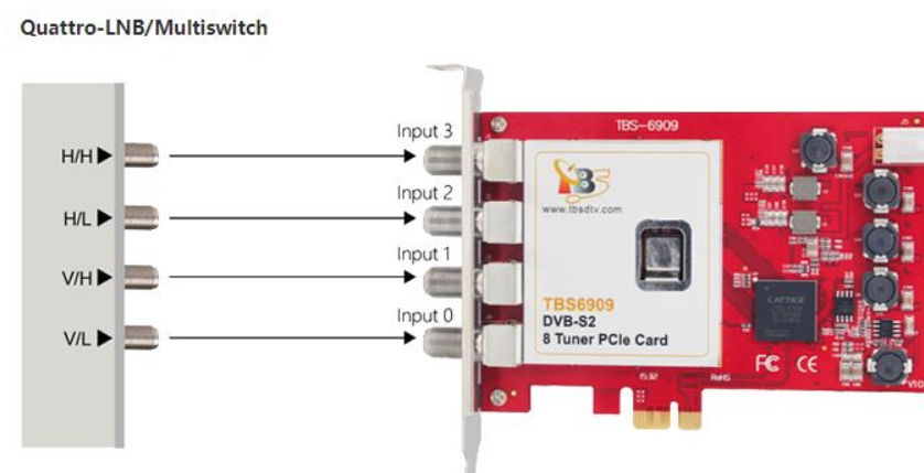

Postby bolzerrr » Tue Jan 07, 2020 3:16 pm
I have only one Sattelite connected, it is a quattro LNB.
So i have this cabeling:
bolzerrr
Posts: 34
Joined: Wed Nov 20, 2013 5:36 am
Re: TBS6909 QUATTRO TVHeadend: No Channels
Postby steven » Tue Jan 07, 2020 4:26 pm
Hi Sir
If your LNB is quattro LNB make sure the 4 cables put the right port not like quad LNB you can direct use .
your 4 cable should be VL VH HL HH need to put the right position

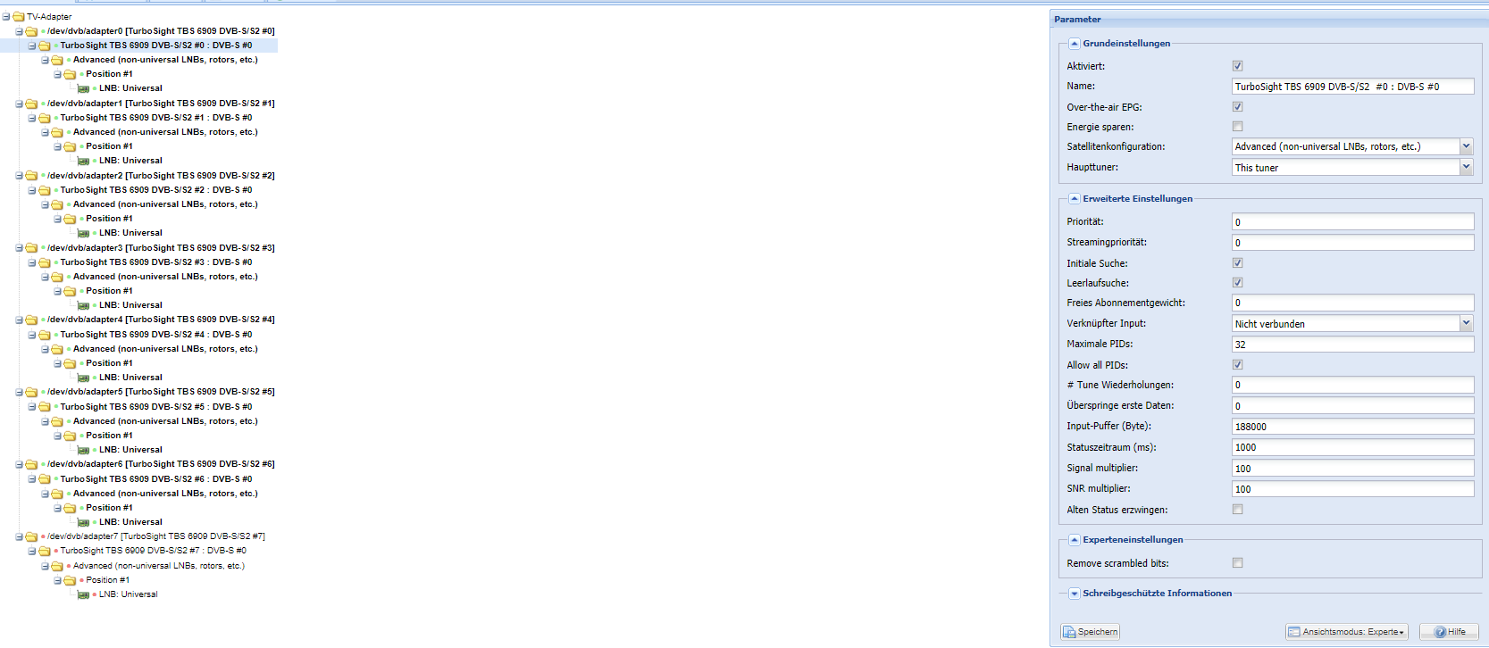

thank you for your help. I checked teh cables and they should be fine. I think something is wrong in my config of TvH. Do i have to follow the steps 7.4-7.11 from the manual (Advanced tuner/ Mux config etc) or is this just for a quad LNB?

Postby bolzerrr » Wed Jan 08, 2020 5:49 am
I completely redid the whole steps from the manual, and also changed the cabeling in order to try it with unicable (even if this is not what i plan to do). I set the mode to "2" for this and tried both, TVHeadend and minisatip. Nothing is working, it is frustrating :(
