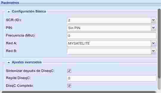

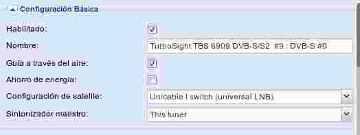

I have two cards in my server. I config my two cards tbs6909 in mode unicable and each tunner is config according to the official manual (https://www.tbsiptv.com/download/tbs6909/tbs6909_user_guide.pdf):

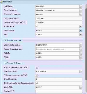

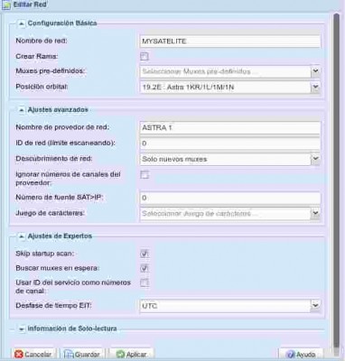

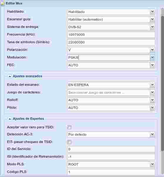

I would like to add (for example) this Astra frequency:
19.2°E 11Astra 1L 10979.00 V 34 Astra 1L DVB-S QPSK 22000 5/6 ASTRA 1, 33.8 Mbps
But I get this error when I force the mux scan in tvheadend:
2018-01-11 19: 27: 39.817 mpegts: 10979V in MYSATELITE - tuning on TurboSight TBS 6909 DVB-S / S2 # 9: DVB-S # 0
2018-01-11 19: 27: 39.817 en50494: transponder value larger then 1023 for freq 1229000 (0)
2018-01-11 19: 27: 39.817 en50494: invalid tuning freq
The only difference with the manual is that Frequency I have not put anything (I have left it to 0) so that tuner takes me any frequency.
Why do you give me the error?

Postby steven » Wed Jan 24, 2018 3:18 pm
hi
When you are using with unicable the lock frequency you need to update too .and the unicable slot frequency value
thanks
