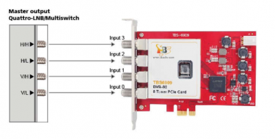

Hello all, I am here to ask you some things about this card. i would like to buy an MOI Pro AMD with a TBS6909 equipped on it, but i have some doubt about the number of channels that i can stream to my clients (20 clients on a local lan, is a resort in Italy country).
Specifically, i thought that this configuration:
allowed me to tune ALL channels of the satellite, so i could multicast those channels to the clients. So, with 2 TBS 6909, a TBS 6205 (for DVB-T2 sevices) and 2 Phoenix card reader, I will be able to give a high quality service to the resort guests, without headaches!
But, according to MOI Pro AMD datasheet, this is not possible, as the maximum HD crypted streammable channel is 20. So, am I wrong? There is some configuration that meets my needs? Thanks for your interesting, and sorry for my bad english ;) ;) ;)

Hi Jerrino77
Streaming FTA channels is no problem for MOIPro-AMD ,for your case if you want to using soft decryption for HD channels
This need cost a lot CPU usage . if you want to support more maybe you can buy our Octa 6909 card and using in your PC with powerfull
CPU to support more channels

Postby jerrino77 » Wed Oct 19, 2016 4:49 pm
Well, this seem to be a very good news, @steven, thanks! So, if i have understood, with the configuration showed in the picture i posted, i could stream ALL transponders of selected satellite LIMITLESS? (except for the encryption but i don't care at the moment). Am I right? Sorry, but before a 500€ (or more) investement i have to be sure :D :D :D

Hi jerrino77
Yea you are right with quttro LNB if you connect to the right port of 6909 then 8 tuners can get 8 different transponder at the same time . :)
