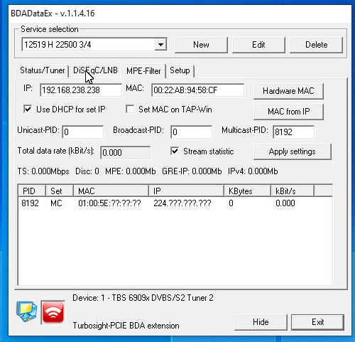

Can the MPE filter in BDADataEx be used to re-route TS traffic, or is it specifically for only MPE traffic?

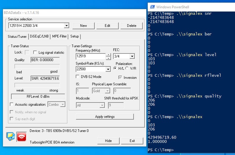

I was able to pair up an instance each of BDADataEx and SignalEx to print some statistics, but still noticing some strange values here and it seems to occur regardless whether there is reception or not. Is it known if this is normal behaviour?
When specifying a parameter (e.g. "SNR") with SignalEx, a group of 4 values is returned. Are these the 4 consecutive samples of the selected demod in BDADataEx, a sample each from 4 of the 8 demods, or something else?
