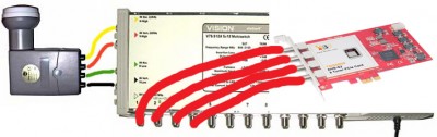

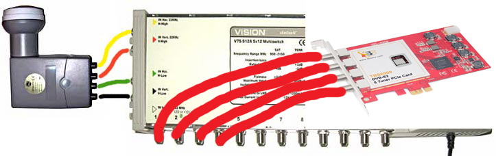

Hello.
Here is my setup so i guess i would need mode 2?
quattro LnB / Multiswitch / 6909. Tuner 1/2 is norwegian sat - Tuner 3/4 is english sat.
If i use mode 0 tuner 1/2 works but not 3/4
If i use mode 2 nothing works.

Hi nightshadow36
when using mode 2,all 8 tuner will using the same satellite. Please have a try with mode 0,
every two tuner using the same satellite and same signal type such as both are VL or VH.
make sure that like this.
