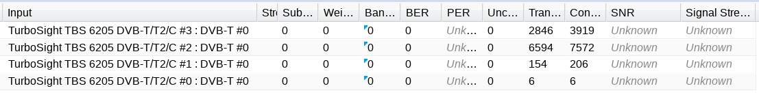

I have a TBS 6205 that seems to be running happily under Linux (Opensuse 15.0) with the open source driver. I use it with TVHeadend.
When I look at Status / Stream in the TVHeadend web UI, I see quite different error rates for the four tuners (see attached image). The error rate for tuner #2 is much worse than for the other tuners, so I don't think this is a question of poor signal but rather it is some feature/artefact of the card itself.
tuner status
I don't know whether this is something to be concerned about or not. I have no idea what a normal or acceptable error rate is. I haven't found any stated specification of the card's error rates. I don't know if there are any ways to get more information. Can anybody advise whether this is normal?
squirrelpie
Joined: Sun Jul 08, 2018 10:56 pm
Re: TBS 6205 error rates?
Postby crazycat » Wed Aug 15, 2018 11:35 am
Look like only first demod tuned and receive some stream. Another not tuned and frontend driver show "some garbage" in BER/UCB :)

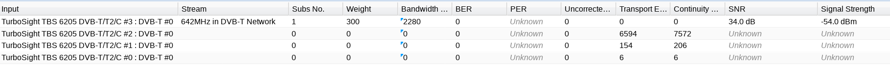

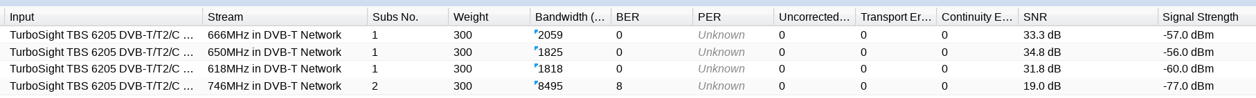

I'm just beginning to understand what the display is showing me. I hadn't realized that when a tuner is in use it shows live data during that session, but when the tuner is not in use it shows cumulative errors. So the data in that snapshot was a bit confusing.
I also hadn't realized that TVHeadend apparently always selects tuner #3 for the first subscription, tuner #2 for the second and so on. So naturally the cumulative totals are bigger for the higher-numbered tuners.
So here are two more snapshots. The first with all tuners in use, and the second with none. I don't understand the forum software well enough to make it pretty. All the channels work and the totals are more consistent, although not completely.
all in use
none in use
