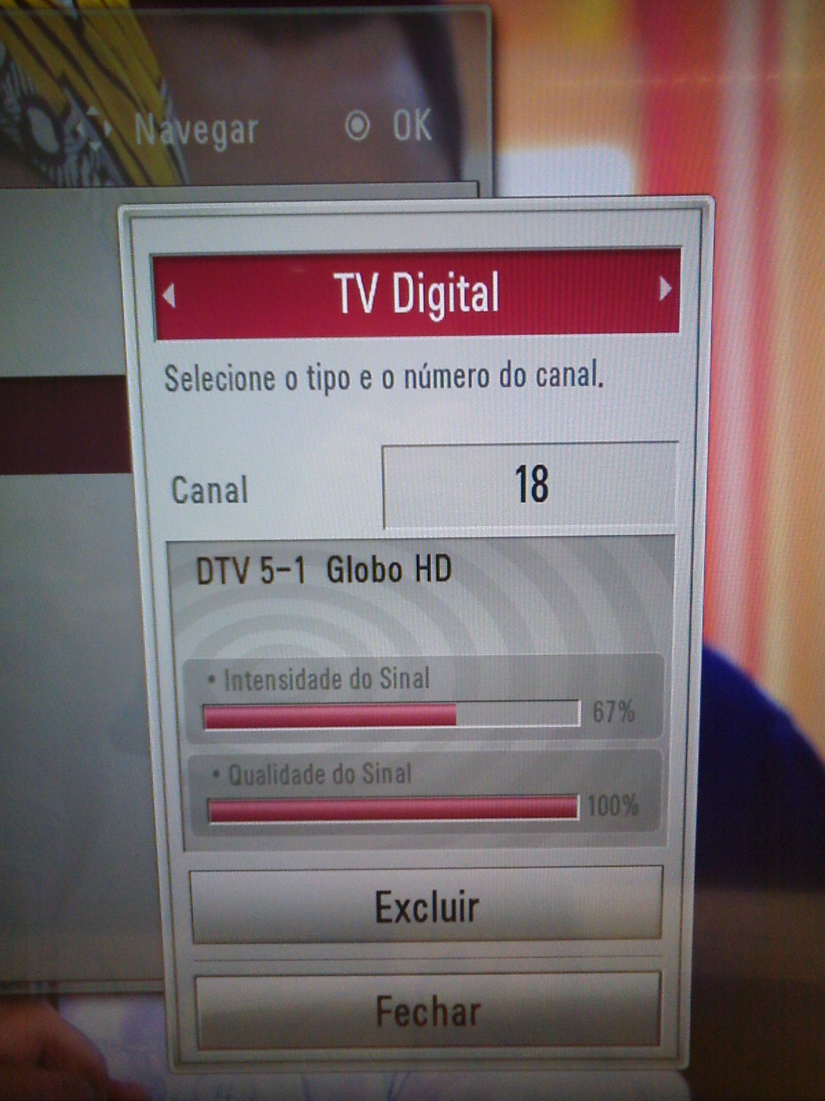

I've been testing this TBS board in linux both with TBS drivers and the open source drivers.
I'm getting a lot of discontinuities and Transport errors when using the normal TBS drivers. The same RF cable works perfectly in a TV.
Globo - ISDB-T
A x8227 Geniatech works fine under the same conditions also.
With the open source drivers I get a lot of errors also:
