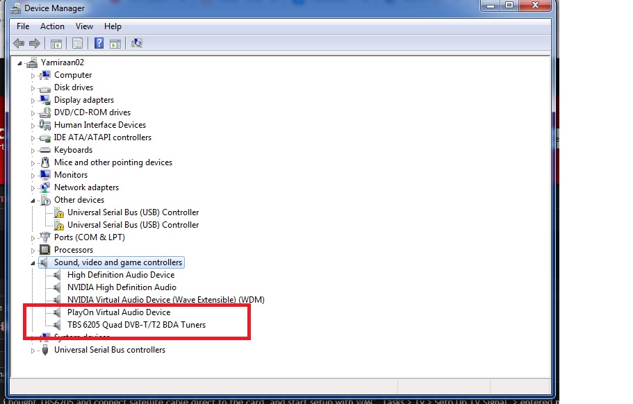

note: tuner card driver installed successfully ss is attached

What about your signal ? DVB-S ? satellite cable ? for 6205 it is DVB-T/C tuner card can not receive the DVB-S signal
For DVB-S signal you need to use TBS6904
