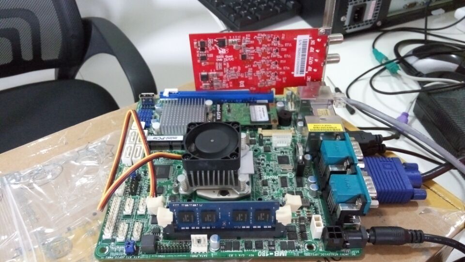

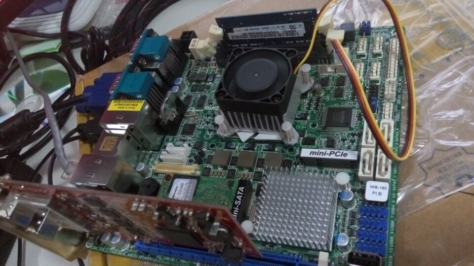

Thanks for the update, we bought one CPU and board but can not running ,would you mind take a picture of your board?
Re: Issue after reboot with 6205
Postby hovis » Fri Apr 24, 2015 6:45 pm
2 pictures linked below. The server normally has a pci-e riser card fitted, but we have been testing with the 6205 card plugged directly into the blue pci-e slot on the motherboard.

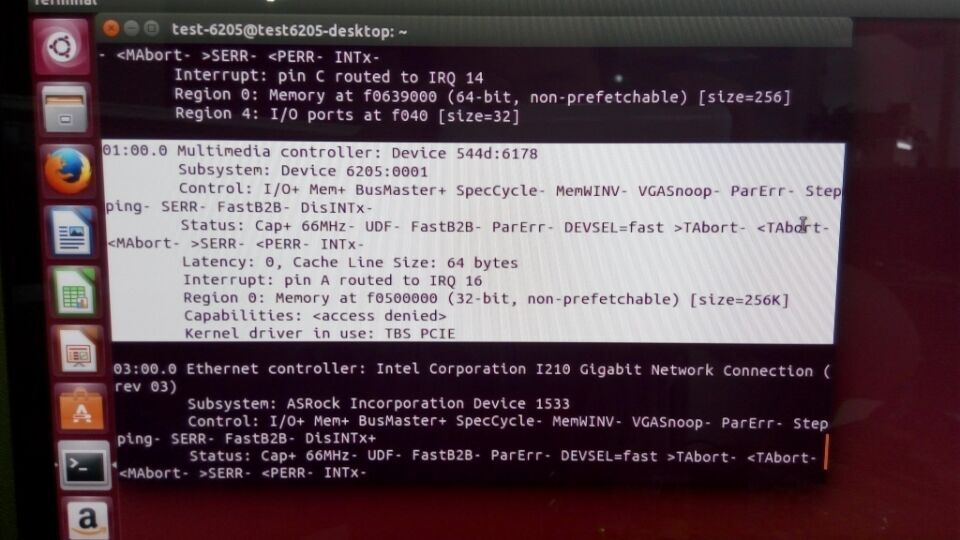

After our test AS-Rock IMB-180 (single x16 PCI-E slot) with 6205 and 6905 every time we reboot all is ok. so strange that why you have problem.
We test in widows too. which is ok.
as you can see from the picture.
Can you have a try test your 6205 in another mainboard check whether is ok. and we will have more check with this too.
