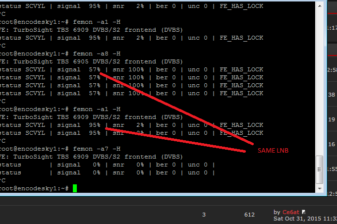

Postby helmax » Fri Nov 27, 2015 9:16 am
i have two tbs boards
connect same lnb octa
both have different signals
board is damage??
strange i have board 6908
and show 6905

Postby cody » Sun Nov 29, 2015 9:42 pm
nothing is damaged, you cannot compare "percentage" of the signal and snr, between 2 DVB cards with different hardware design, because neither signal, nor snr are measured in percentage in hardware and thus each has its own scale. on top of that currently the driver for 6909 has no any support for "-H" command line switch you're using.

Postby helmax » Mon Nov 30, 2015 1:05 am
but i have 100% signal in my lnb antenna why i have half ?
but the board is 6908 why show 6905 have last drivers ?

Postby steven » Mon Nov 30, 2015 3:10 pm
Hi helmax
which linux driver you are using ? please have a try with our latest linux driver

Postby helmax » Wed Dec 02, 2015 3:18 pm
iam using the last version !!!!
