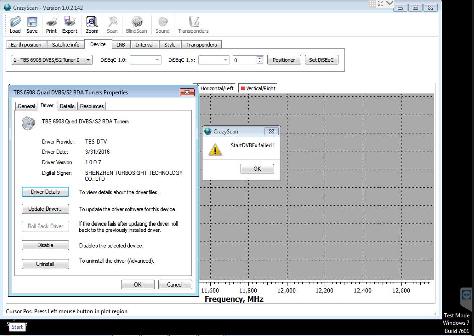

I am not able to start tuner in windows machine.
I am testing in windows 7 SP1 with StreamReaderEx BDA Ver:1.2.4.36 and official driver 1.0.0.7.
I tried in CrazyScan and TBSPro but I got same result in both, please check attached screenshot.
log:
09:58:22 - 21/07/2017 StreamReaderEx BDA Ver:1.2.4.36-modified (Jun 28 2017, 03:24:38)
09:58:22 - 21/07/2017 Log level = 1
09:58:22 - 21/07/2017 DLL_PROCESS_ATTACH hModule = 717E0000
09:58:22 - 21/07/2017 CheckForDVBEx(0x00FF9150)
09:58:22 - 21/07/2017 Power-off LNB on exit: ENABLED
09:58:22 - 21/07/2017 SendDiSEqC use 2 repeats
09:58:22 - 21/07/2017 Default modulation: AUTO
09:58:22 - 21/07/2017 Default spectral inversion: AUTO
09:58:22 - 21/07/2017 Default pilot: AUTO
09:58:22 - 21/07/2017 Default rolloff: AUTO
09:58:22 - 21/07/2017 Preffered BDA device type: AUTO
09:58:22 - 21/07/2017 Allowed IF Freq 950-2150 Mhz
09:58:22 - 21/07/2017 Inverted LOF<6000 and >21000 Mhz
09:58:22 - 21/07/2017 Available BDA-devices:
09:58:22 - 21/07/2017 Device 0
09:58:22 - 21/07/2017    Name: TBS 6908 DVBS/S2 Tuner 0
09:58:22 - 21/07/2017    Type: DVB-S/S2
09:58:22 - 21/07/2017    Index: 0
09:58:22 - 21/07/2017 Device 1
09:58:22 - 21/07/2017    Name: TBS 6908 DVBS/S2 Tuner 1
09:58:22 - 21/07/2017 Device 2
09:58:22 - 21/07/2017    Name: TBS 6908 DVBS/S2 Tuner 2
09:58:22 - 21/07/2017 Device 3
09:58:22 - 21/07/2017    Name: TBS 6908 DVBS/S2 Tuner 3
09:58:22 - 21/07/2017 Device 4
09:58:22 - 21/07/2017 Device 5
09:58:22 - 21/07/2017 Device 6
09:58:22 - 21/07/2017 Device 7
09:58:22 - 21/07/2017 Device 8
09:58:22 - 21/07/2017 Device 9
09:58:22 - 21/07/2017 Device 10
09:58:22 - 21/07/2017 Device 11
09:58:22 - 21/07/2017 Device 12
09:58:22 - 21/07/2017 Device 13
09:58:22 - 21/07/2017 Device 14
09:58:22 - 21/07/2017 Device 15
09:58:22 - 21/07/2017 Device 16
09:58:22 - 21/07/2017 Device 17
09:58:22 - 21/07/2017 Device 18
09:58:22 - 21/07/2017 Device 19
09:58:22 - 21/07/2017 Device 20
09:58:22 - 21/07/2017 Device 21
09:58:22 - 21/07/2017 Device 22
09:58:22 - 21/07/2017 Device 23
09:58:22 - 21/07/2017 StartDVBEx(0)
09:58:22 - 21/07/2017 Device_ID: 0
09:58:22 - 21/07/2017 Use Device 0
09:58:22 - 21/07/2017    Tuner filter: TBS 6908 DVBS/S2 Tuner 0
09:58:22 - 21/07/2017    Capture filter: TBS 6908 DVBS/S2 Capture 0
09:58:22 - 21/07/2017 Input num 0
09:58:22 - 21/07/2017 RunGraph() : Cannot run graph
09:58:22 - 21/07/2017    No such interface supported

Postby crazycat » Sat Jul 22, 2017 7:25 am
Device busy with another program or you use some Win Server 2008R2+ without BDA subsystem. Maybe some problem with driver and many cards in system (enable only one 6908 card and try again)

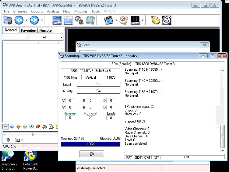

you can run DVBDream, ProgDVB and etc ?
Re: Can't start tuner
Postby phkarmur » Sun Jul 23, 2017 1:46 pm

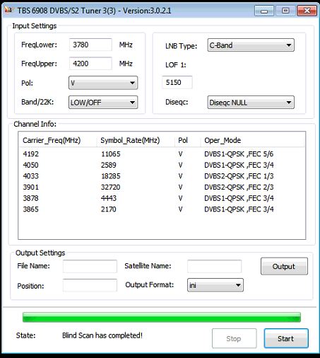

TBS blindscan working fine but I can not lock in dvbdeam
phkarmur
Posts: 19
Joined: Thu May 19, 2016 1:51 pm
Postby crazycat » Mon Jul 24, 2017 11:35 am
So this issues ralated to your windows system and many 6908 devices :) TBS Blindscan just some custom vendor application :)
