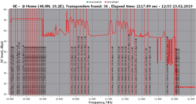

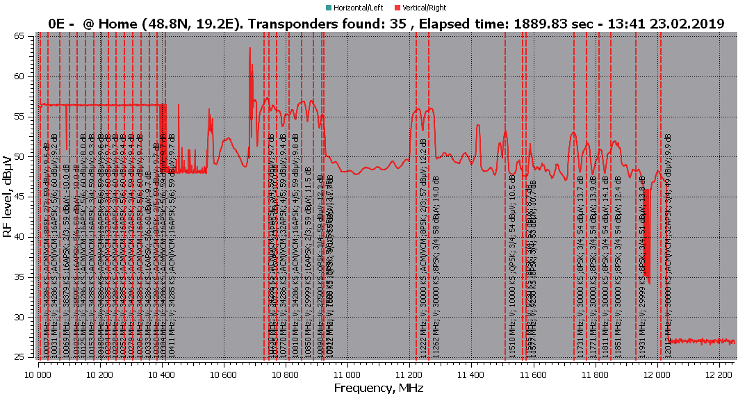

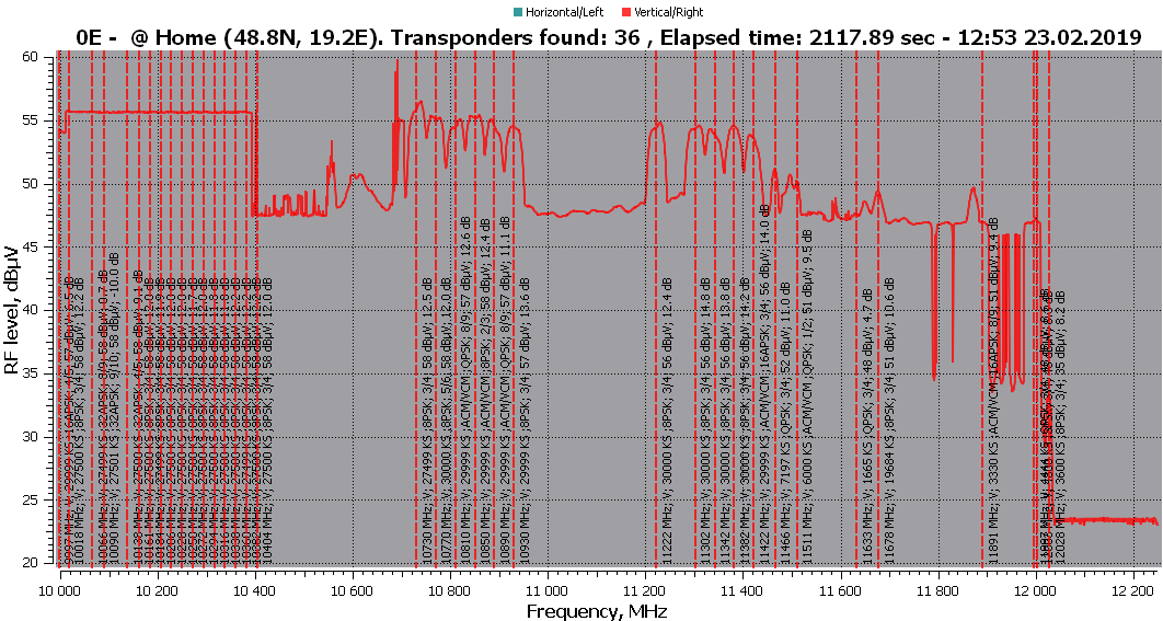

Postby EnoSat » Sun Feb 24, 2019 9:34 pm
now try scan full range CS /250 - 2500 MHz/
TBS5925 create fake transponders in range 250-650 MHz from first real transponders in band
real working range 800-2300 MHz
