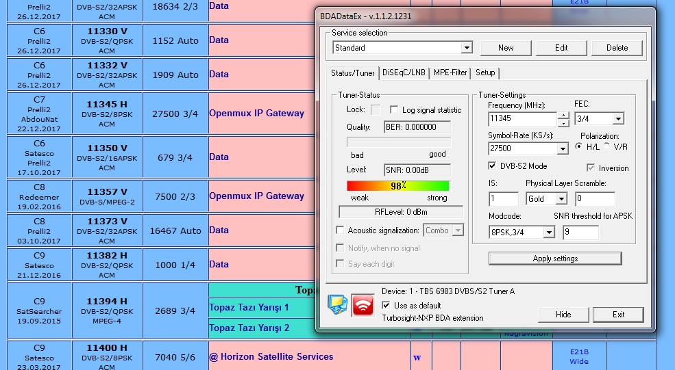

Postby sajjads24 » Fri Mar 30, 2018 7:05 pm
hi
i am can not lock on signal 11345 H 27500 3/4 DVB-S2/8PSK ACM from :
https://www.flysat.com/e21b.php
with TBS6983 ?!
how lock on signal 11345 ?
My Card = TBS6983

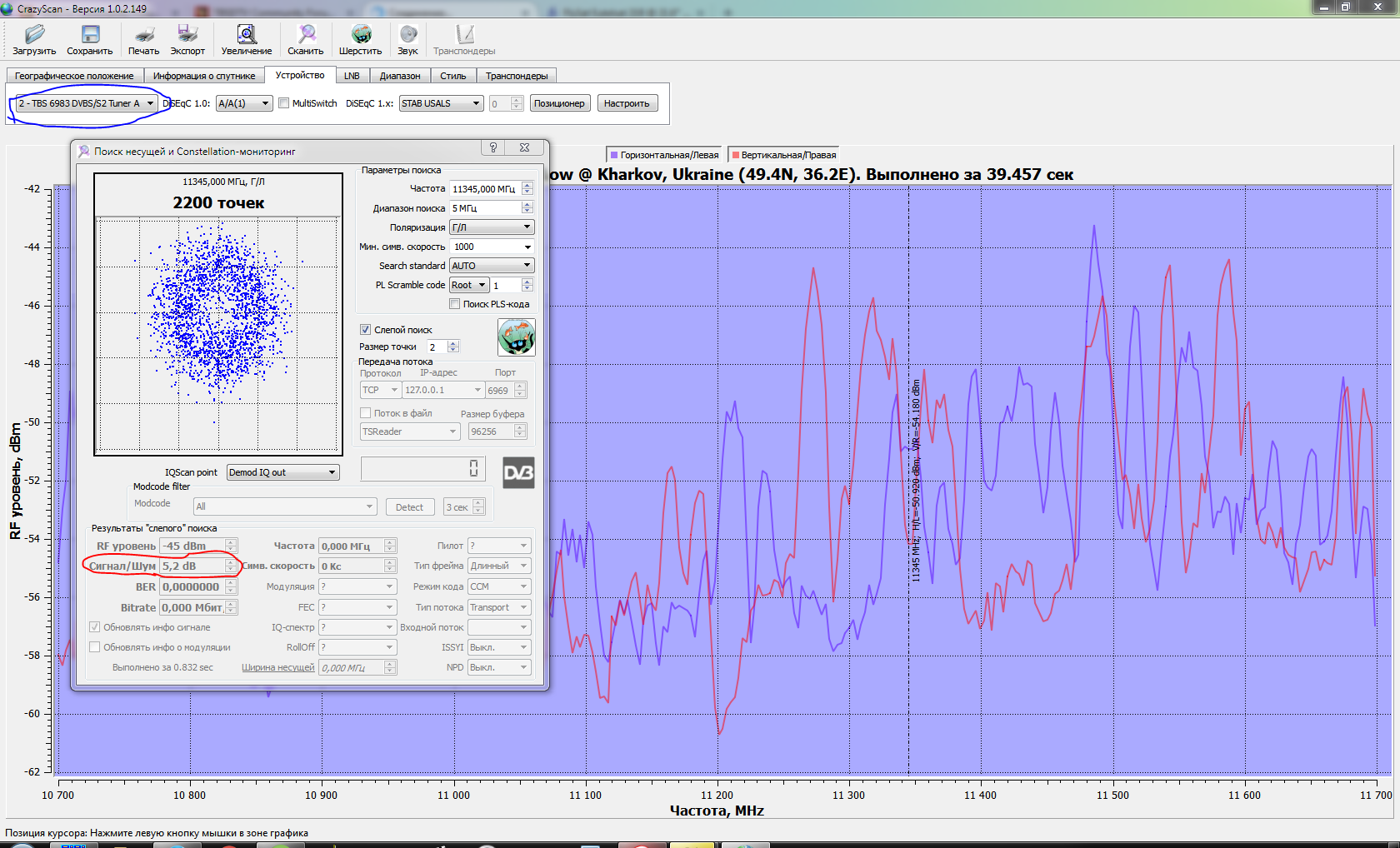

Postby sajjads24 » Sun Apr 01, 2018 5:00 pm
crazycat Wrote:Look like bad signal, no lock. Need at least SNR ~8dB for 8PSK,3/4.
Check signal params with CrazyScan
The attachment 21.6E-11345H.PNG is no longer available
it's status for me :
can i lock this signal ?
My Card = TBS6983

Postby crazycat » Wed Apr 04, 2018 10:16 am
no, SNR < 8dB.

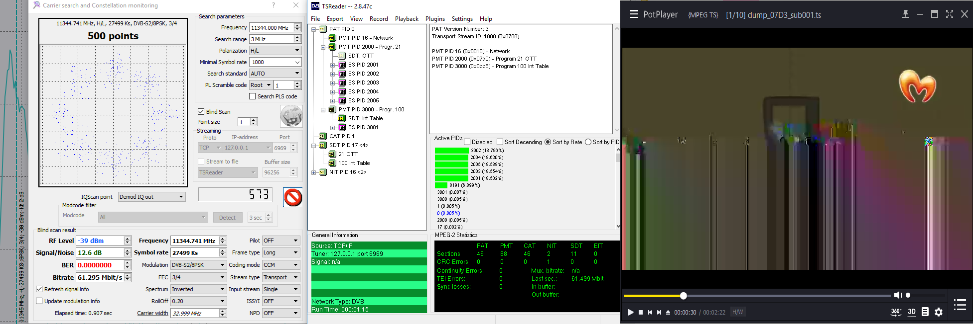

Postby satesco » Fri Apr 20, 2018 5:52 am
sajjads24 Wrote:hi
with TBS6983 ?!
@CrazyCat is right. It needs a signal over 8.0dB for 11345 H.
Transponder contains many Russian OTT streams.Here is one of these.
