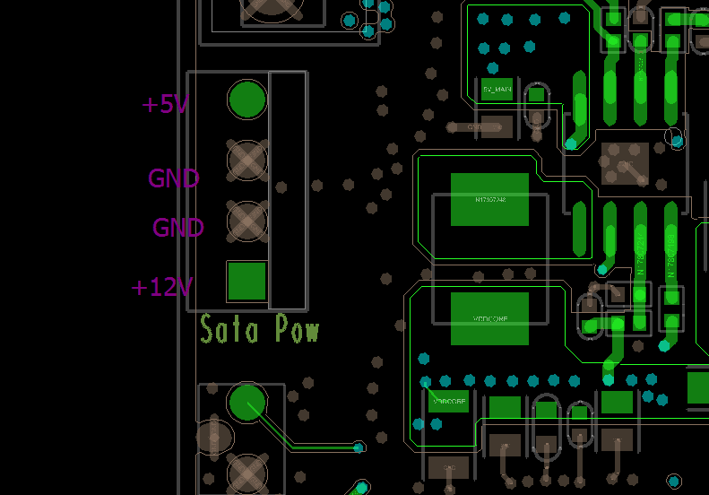

I've been using an external 2.5" sata drive connected to a usb port on my moi pro to share my movies, music and recorded TV over IP. However this is an untidy arrangement. I'd like to mount the sata drive internally using the on board sata connector, but I am unsure where I can tap the 5v power from on the board. There is a plug on board next to the sata connector. Is this a 5v power line? If so, can someone give me the pin voltages? is there a cable that I am not aware of to utilize an on board 5v power line, if it exists?

Postby steven » Wed Jul 27, 2016 6:11 pm
Hi stevie
Please check this :
MOIPro-SATA Power

Postby stevie » Fri Jul 29, 2016 2:44 pm
Superb! thank you.
