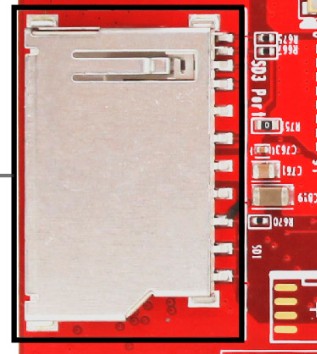

A lot of people want to boot from SD cards and our new version of Matrix already add the boot switch,easy change the boot device.
But for the older version of Matrix,we can use the following steps to boot from SD3 in Matrix.
Matrix-SD3 slot
